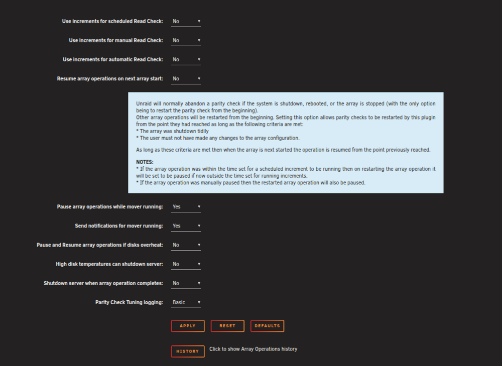

One concern: I have a planned power outage coming up. Is it safe to pause the parity check, shut down properly, and resume after power is restored? Will Unraid pick up where it left off or restart from the beginning?
Thanks again!
It's safe to cancel and power down, but you will need to restart the check from the beginning.
I believe the party check tuning plugin allows you to resume a check after a reboot.
This Option ?
