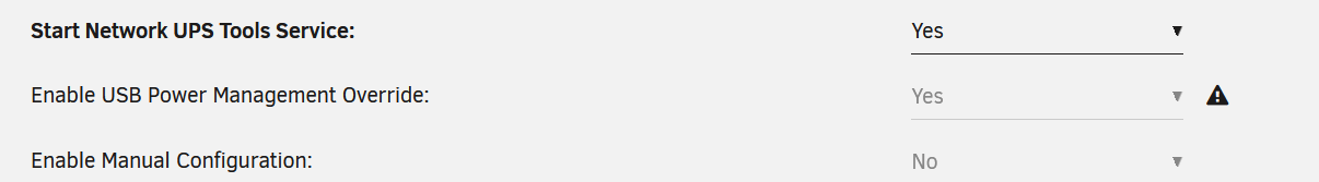

  11. Found the new version of the plugin has USB power management override Will see if that may have been the reason for the disconnection and if this setting helps.
