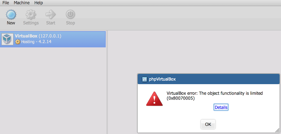

  7. I have attached a screenshot of what I see when I try access

  9. ok, can only find phpvirtualbox 4.3.2. Still cannot seem to get virtualbox up and running. vboxwebserv is up but for some reason I cannot get it to connect. Anyone help my with the config.php please?

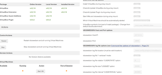

  18. Hi All I installed the TVHeadend plugin and then noticed that in the Virtualbox plugin page that it says Package Online Version Local Version Installed Version VirtualBox No online package No local package Not Installed VirtualBox Extension v4.2.16 No local package Not Installed VirtualBox Guest Additions v4.2.16 No local package VirtualBox Plugin v0.5.2 v0.5.2 Does anyone know why my Virtualbox plugin would say there is no online package? There is also no way to start webserv on the plugin page. The Kernel version seems to have changed as well to v3.0.33 I am sure it was something like 3.9.X.X I uninstalled TVheadend same issue, uninstalled virtualbox plugin and reinstall same issue. Anyone had this problem? Any help would be appreciated. Lee
