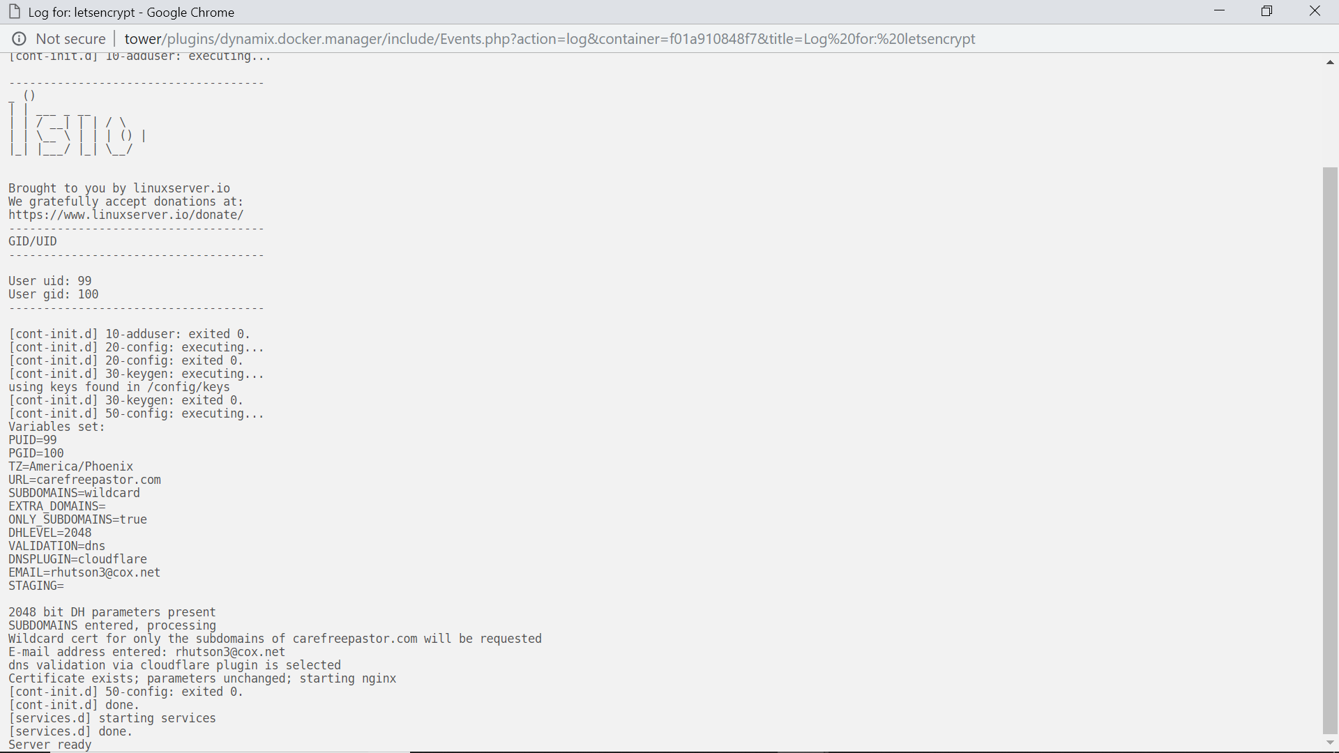

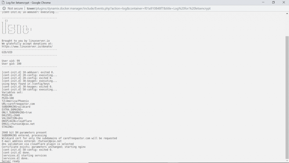

  4. Thank you for the excellent second video about using Cloudflare to workaround a closed port 80, which is the case with Cox. After purchasing a domain name from GoDaddy, I have Let's Encrypt running as a docker now using dns and the log shows that it started properly (log image enclosed). My current problem, however, relates to Home Assistant docker accessing the cert file so that it will open in https. I have mucked around for more than two weeks without coming up with a solution. And, yes, I did watch the first video about setting up Let's Encrypt with dockers other than Home Assistant. i have read many, many postings and videos about how to use Let's Encrypt with Home Assistant; nothing I have attempted as a result of these how-to's has allowed me to use Let's Encrypt to successfully access Home Assistant with https. I am at a total loss and obviously need careful guidance to straighten things out. I would be happy to uninstall the version of Home Assistant which I now have installed and start over.
