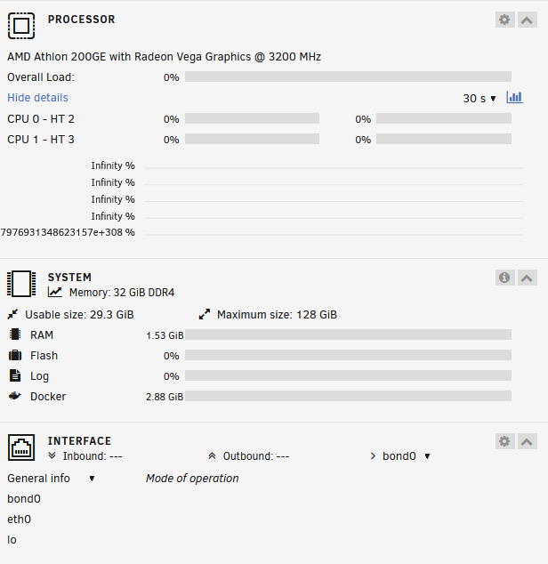

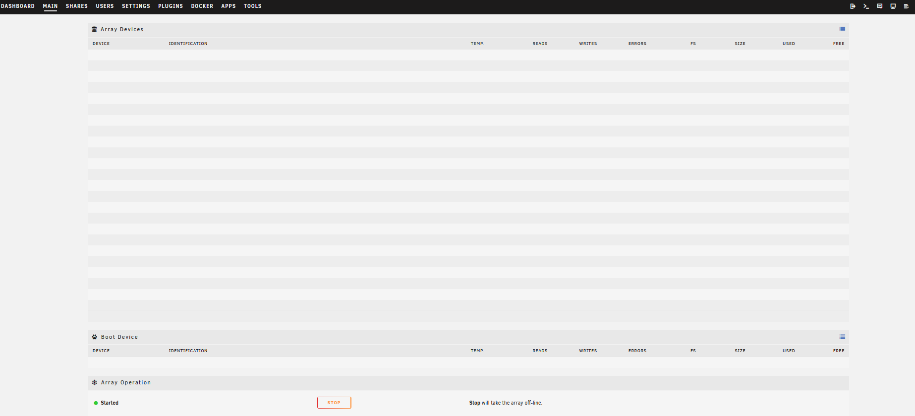

  2. Hello, my server was running well on 12.2, once I updated my machine to 12.6 and WebUI went wild. I lost actual data on used resources, array devices, boot devices. Also popups are acting weird, i can't generate/download Diagnostics because popup is spinning without end, I had to use SCP. I tried to roll back to 12.2 but it didn't help. Now i am on 12.8 and still facing this issue. It looks like WebUI issue, I didn't notice any issues with other functionalities. tank-diagnostics-20240304-2146.zip
