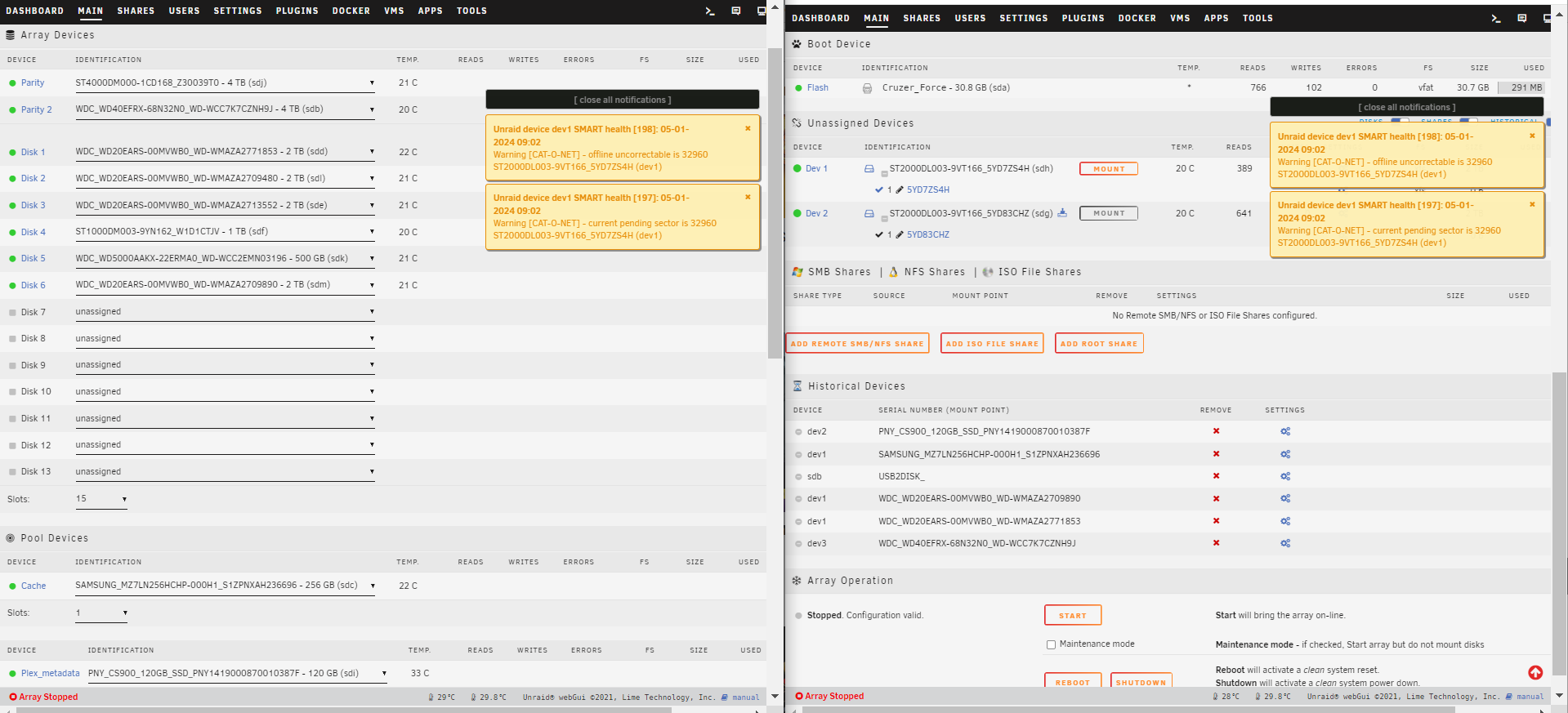

  3. Sorry, I misunderstood oh....If i mount the faulty disk ( ST2000DL003-9VT166_5YD83CHZ (sdg) and ST2000DL003-9VT166_5YD7ZS4H (sdh) ) i can see they have files inside and the same shares structures...so they were in the array....well i can only mount of them the other is grayed.cat-o-net-diagnostics-20240105-2011.zip. This is the log with the arrey on and the 2 not assigned.

  5. i removed only one of them, but there seems to be no changes cat-o-net-diagnostics-20240105-1934.zip

  7. I finally had time to work on the server again, and things have changed a bit. Two drives of the array are now set to 'unassigned,' and I don't understand what happened. I don't know what I should do now. The diag files is attached as asked before. cat-o-net-diagnostics-20240105-1255.zip
