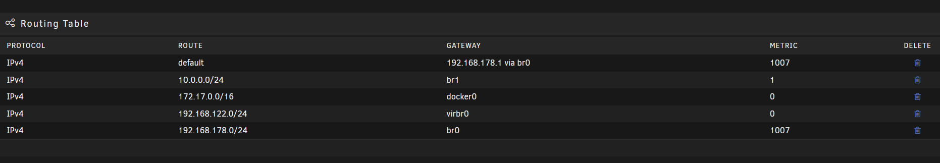

  5. Thanks Vr2lo! Indeed you were right, i just had to simply go to internet explorer and make a new network connection and put the \\10.0.0.1\ connection in and it worked. I did not change the subnetmask (255.255.255.0 instead 255.0.0.0) though. Now I think how stupid I was🤨. But as always, the devil is in the details haha! Thanks!!!
