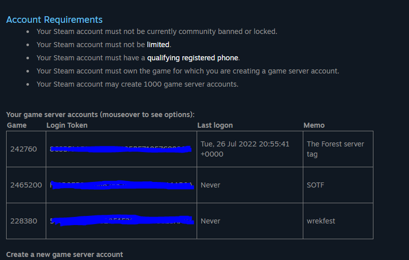

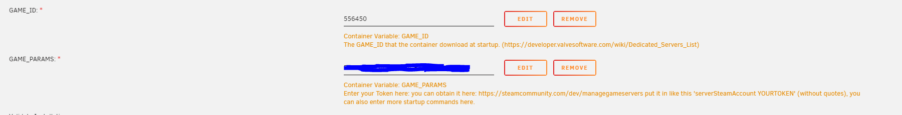

  4. Here is a screen shot of the container settings for "the forest". Sons of the forest have the same settings. Its not possible to run the server without the token. It doesnt matter if people play in the server or not, every 2ish weeks the token expires (for both containers). So i see in "the forest" settings as shown it says put "serverSteamAccount" before the token. Iv done that now and still steam shows no logins via server on Sons of the forest or other servers.
  5. Hello all, Hoping someone can help. Iv been running "the forest" and "sons of the forest" server docker on unriad for a while, HOWEVER the issue I'm always having with any docker server is the steam server token expires. in other words the GSLT is expiring because steam show no logins after 2 weeks. Every two weeks I have to log into https://steamcommunity.com/dev/managegameservers and then regenerate a token, edit the docker GAME_PARAMS to the new token every 2(ish) weeks.
