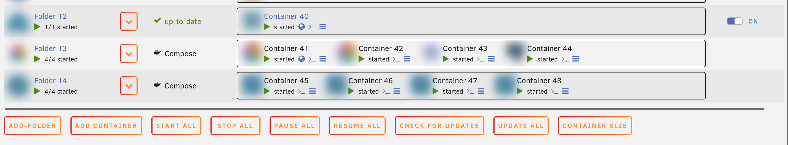

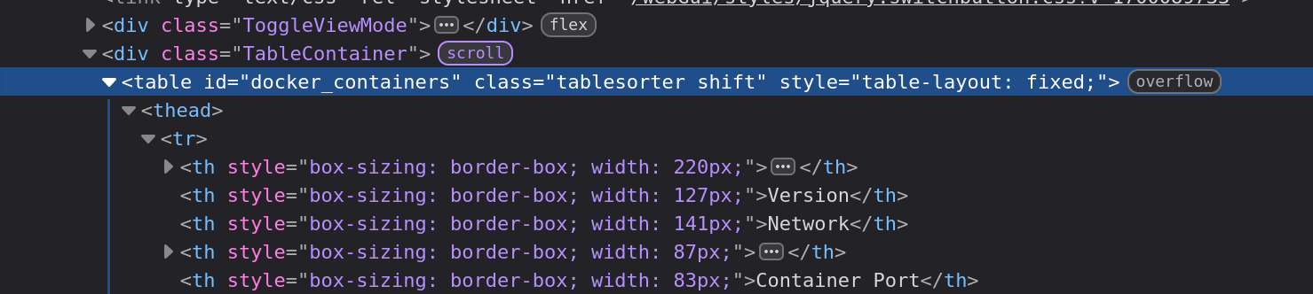

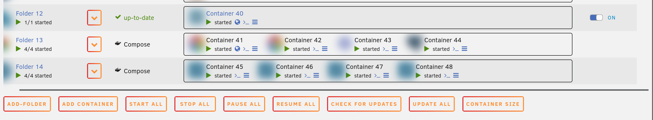

  1. Hi @chodeus, thank you so much for your work! The plugin is amazing. Wanna report a minor cosmetic issue: On firefox, the docker containers table horizontally overflows a bit, causing a scroll bar displaying at the bottom. This happens both in basic view and advanced view. Seems like chrome is not affected tho, just firefox. Here's a screenshot: As you can see there's a horizontal scroll bar on the bottom, and I can scroll it to the right: And devtool indicates that it's the docker_containers table overflowing.

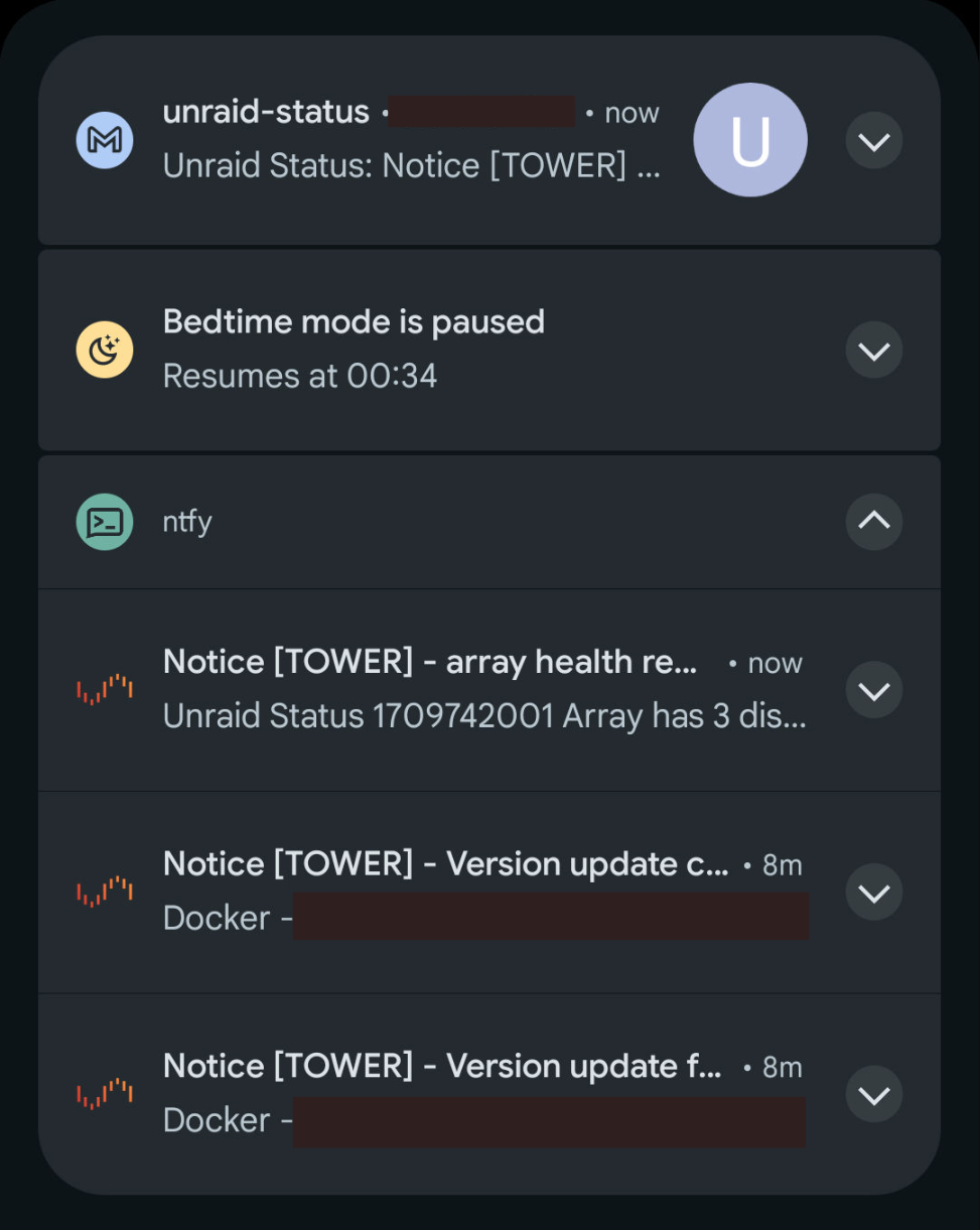

  14. Thanks for your reply. Your idea sounds quite reasonable, but here's the part that doesn't line up: As shown above, I have enabled both `Docker update` and `Array status` email notifications, but only array status notification is sent to my inbox, not docker update. Here's my diagnostics file: [redacted] Hope it can help troubleshooting. Thanks!
  15. And here's the notification I received, notice that docker version update notification is only sent to ntfy, but array status notification is sent to both email and ntfy:
