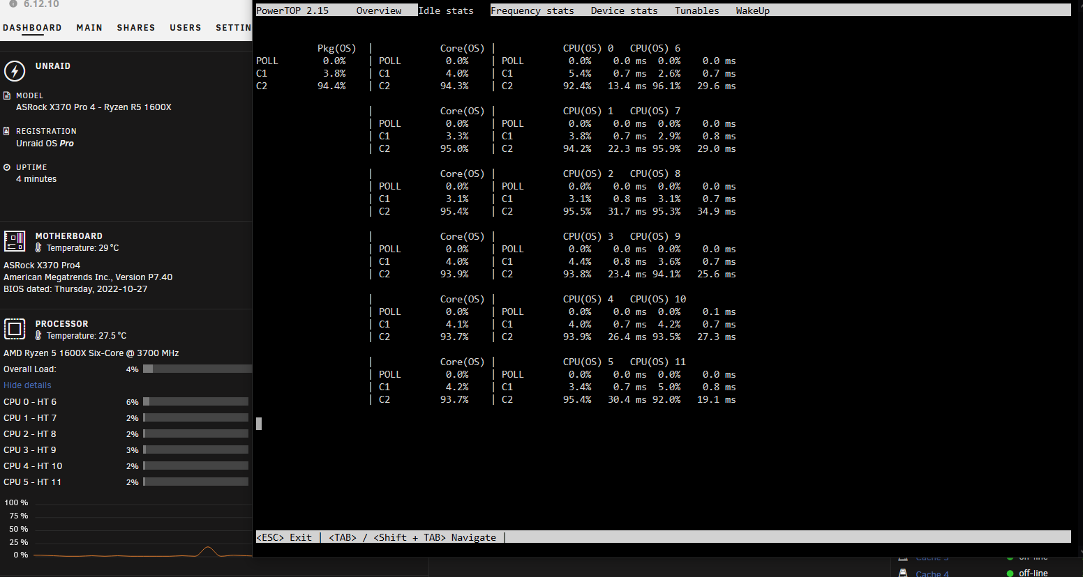

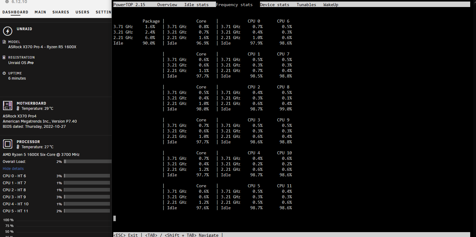

Perhaps the more appropriate way to go about this question is, what if anything can I do to increase power savings with my current motherboard? Will a Zen2 or Zen3 CPU/APU offer anything significant in this matter? It seems powertop is likely misrepresenting C states for Ryzen CPUs. Regardless, previously if my 1600x entered C6 it definitely crashed but it did also have a period of appreciated power savings... The strange thing is, I cannot do anything to get unraid to allow my CPU to enter C6 at this point. I am not sure if there have been changes to the Linux kernel to prevent gen 1 Ryzen CPUs from utilizing C6 regardless of end user intent. My bios/UEFI is set to enable global c states and I have removed the "/usr/local/sbin/zenstates --c6-disable" entry from my go file and yet no C6 and definitely very stable which is totally a good thing I suppose. I do have the tips and tweaks plugin and tweaking for power savings at best will force an idle down clock to 2.2ghz. However I expect the CPU is still running at the manually set voltage. If anyone can chime in with some input, I would greatly appreciate it. I had the 1600x from a previous build and I grabbed the Asrock motherboard on the cheap looking to make things simple. I wasn't expecting I would be overly concerned with chasing the power savings/efficiency dragon. If a drop in for a "newer" cpu could sort this out that would be great.
ASRock X370 Pro4 CPU Upgrade for Efficiency/Power Savings?
Hello, I have been running unraid for a while now on an ASRock X370 Pro4 with a Ryzen R5 1600X. Its actually stable so there's that at least but with a manual overclock set to 3.7ghz it will only down clock to 2.2ghz. I expect this has everything to do with how gen 1 Ryzen and Linux and C states don't seem to get along. The ASRock X370 Pro4 is updated to the latest bios and can accept all the way up to the R9 5950x (theoretically) definitely not sure the VRMs and such would be up to the task. Regardless I am wondering if there is a Zen2 or hopefully a Zen3 Ryzen CPU or even APU I can drop in that is known to work well with this motherboard's power delivery and chipset and all the while allow for more efficient idle down clocking/power savings/entering C6 and remaining stable. As it is right now, even if I remove /usr/local/sbin/zenstates --c6-disable from my go file, powertop shows my CPU doesn't go past C2. With all HDDs in standby I am pulling around 180 watts and with them spinning I am pulling 200-210 watts depending on usage. I'd love to score some idle power savings if i can find a suitable drop in replacement for 1600x. Any and all input is appreciated. Thank you.

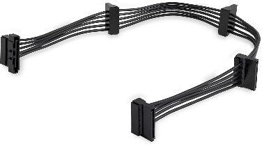

I replaced the sata power cables for all drives with custom cables for my power supply and case, which should cover proper power distribution without overloading the cables/psu. I replaced both disabled drives one at a time. After both data rebuilds and a parity sync for a goof there were and still are no errors. I'll consider this problem solved and likely due to bad power distribution to the drives. Thanks for the advise and insight.
(SOLVED) How should I proceed? - Two drives failed during a network transfer, crashed unraid, caused unclean shutdown.

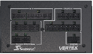

Thank y'all for the feedback regarding this conundrum. I think I have a few possible ways forward regarding proper power distribution to the hdds. Just to clarify, typically, how many drives in total can be powered by each PSU connection for peripherals/SATA taking into consideration all potential splitters and connectors already being used on the PSU supplied power cables? In my case my SATA power cables already have 4 connectors on them. My PSU has 5 connections for SATA and/or molex cables. As far as the disabled drives are concerned, the best way to sort this out would be to verify the emulated content is correct and simply rebuild on top or in this case probably swap the drive with SMART errors. Is this correct? I expect it would be most wise to handle one rebuild on top/swap at a time. Any thoughts on that?
I appreciate your candor. Any thoughts or suggestions to accomplish proper powering of 13 hard drives using reliable extensions and splitters within the constraints of 5 available PSU power connections?
A picture of the sata power splitter I am using for the array drives is attached. Seems to be exactly what I should not have used... At minimum I should reevaluate how I am powering my drives. I was under the impression molex to sata was a bad idea or something like that... Not to mention the lack of molex cables for my power supply. Any recommendations for proper extensions/splitters to accommodate 12+ total hdds in the array while taking into consideration ssds and fans and everything else? PSU is a Seasonic VERTEX GX-1200 with 5 peripheral - SATA/molex connections. I can make use of the PCIe power connections if that is possible and not ill-advised.
All drives are powered individually. Specifically for my array drives I made sure to run them from the PSU cable to a 1 in 4 out sata power splitter adapter. So in the case of drives 1-4, the power is coming from 1 peripheral/sata port on the PSU to a sata power splitter cable. Drives 5-8 are powered from a separate PSU port to a separate sata power splitter... and so on. So from my point of view, a power issue or connection issue at the sas expander should be affecting more than 2 drives. A power/connection issue at the PSU level should affect 4 drives, same goes for at the sata splitter. Which leaves the obvious culprit of the individual sata power connectors for drive 3 and drive 6 respectively. Which of course could very well be the issue. Unfortunately I can only rely on visual and tactile inspection for these cables and the individual ports on the drives themselves. I don't have or know of a sata or similar power continuity testing device and I am not well versed in using a multi meter or similar tools... perhaps I should be... The best I have is my eyes and hands for this one but this system has been deployed for a quite a while now undisturbed and in regular use. Of course now, I will methodically go through each connection as I prepare to swap out drive 6 and maybe drive 3.
I will re-verify the power and data connections but previous checks have confirmed everything is/was fine as far as my eyes can see. I have an LSI 9206-16e with 1 connection feeding 2 sas parity drives and 2 connections feeding the inputs on an IBM ServeRAID 16-Port SAS-2 expander (46M0997 Firmware 634A). disks 1-4 are on the first sas expander output and disks 5-8 are on the second sas expander output. How likely is it for 2 drives on 2 different ports of the sas expander to exhibit read and write errors due to a power issue that is related to the sas expander, while the 6 other drives on said sas expander ports did not have any issues? I'm definitely not trying to come off as rude. I apologize if it reads that way. To the best of my capabilities all connections are and were properly seated and all cabling perfectly intact as far as my eyes are capable of seeing. It seems like at least one other drive should have had some kind of error if there was a bad connection. I appreciate the assistance and input thus far. I will check everything again and go from there. I do have reservations when it comes to rebuilding onto a drive with uncorrected errors so I will probably at minimum replace one drive once I can re-confirm all connections are good to go. Thank you so far!
