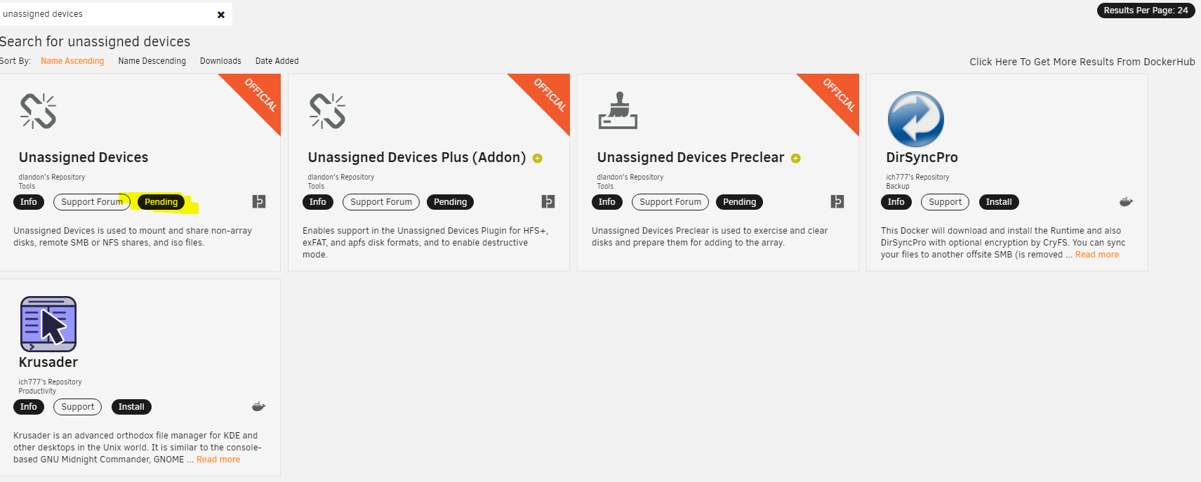

  7. Okay, I think I figured it out (somehow) I stopped the array and rebooted the server, now I have the "install" options available for "unassigned devices"
  8. Yes, but how do I "install" it? There's no option available? Only "Pending" Also - thanks so much for the quick replies.
  9. @trurl - I have community apps installed, and when I search for "Unassigned Devices" this is what I see:

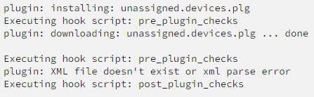

  10. Hello! I am brand-spankin' new to unraid and looking to expedite the file transfer process from source disks into Unraid shares. I saw elsewhere on the forum that a plugin "Unassigned Devices" + a KDE file manager would allow me to plugin install an existing source disk (with data) and perform a file transfer, within Unraid OS, to a destination share. I'm looking to do this to use SATA > SATA transfer over mobo instead of over network (limited to 1gbs) (assuming this is possible) I'm not sure how to install plugins? I tried installing "Unassigned devices" using the "https://github.com/dlandon/unassigned.devices/blob/master/unassigned.devices.plg" file in the "plugins" tab, but I'm getting an error: I also enabled the "apps" tab, and I see it as available there, but don't see an option to "install" from the apps tab. Any help much appreciated!
