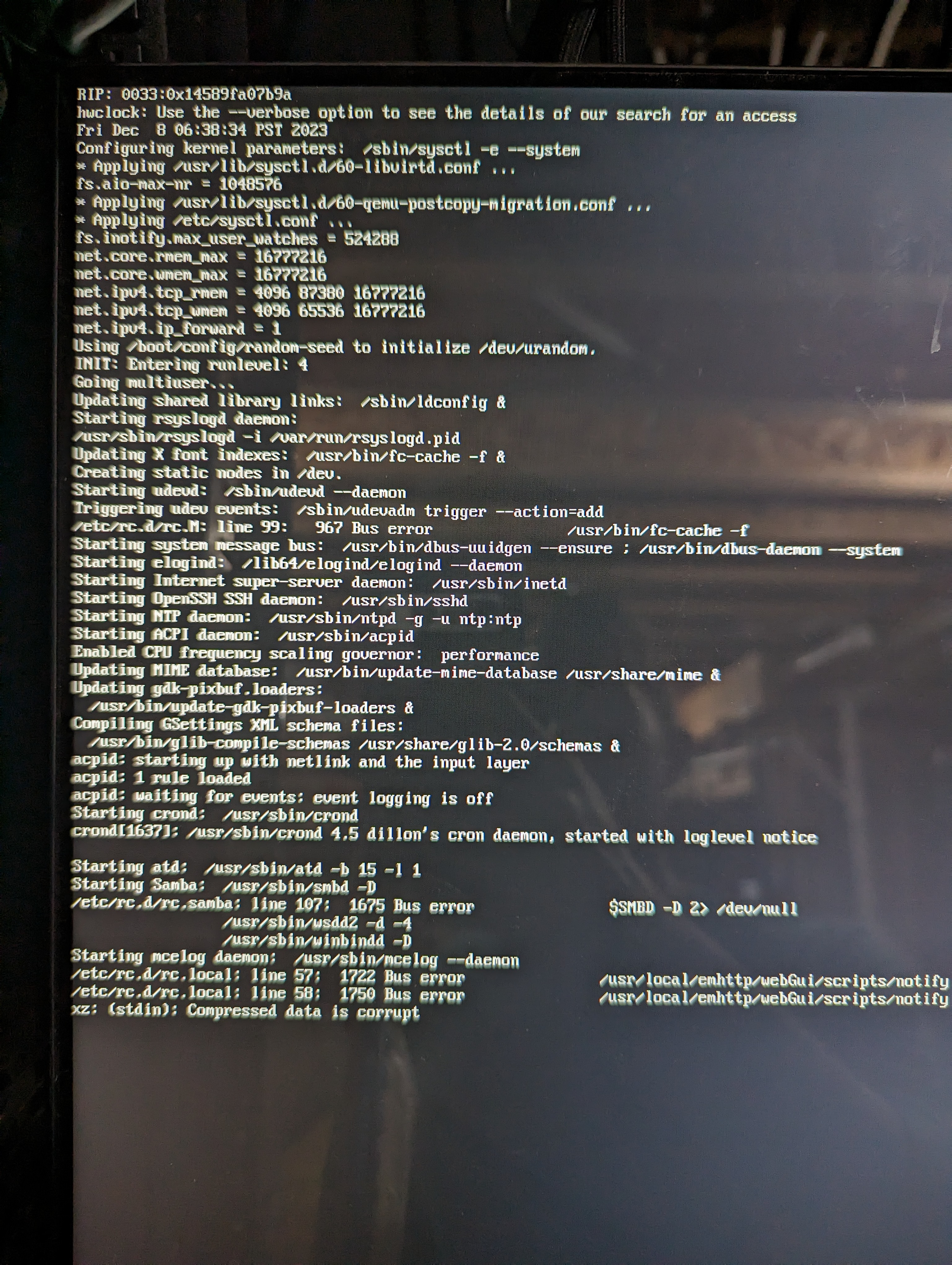

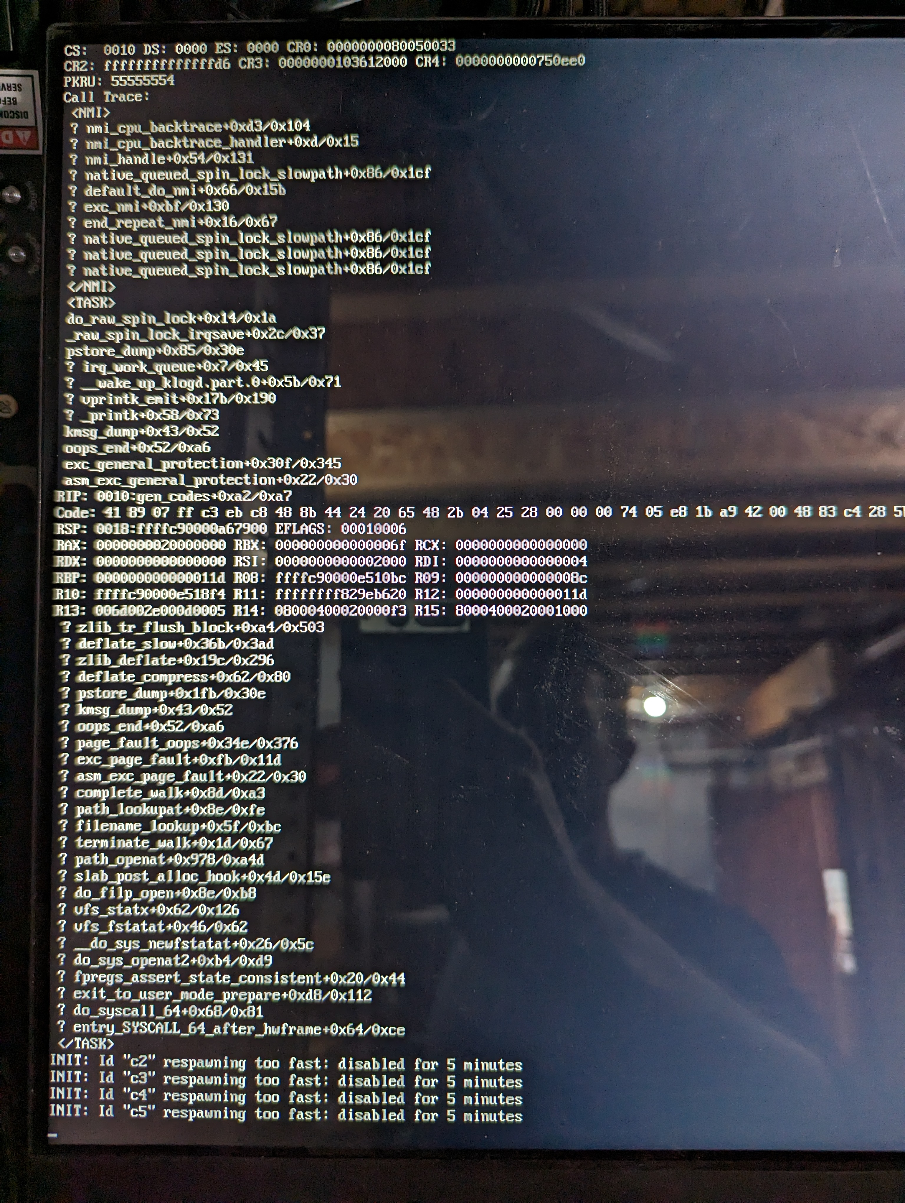

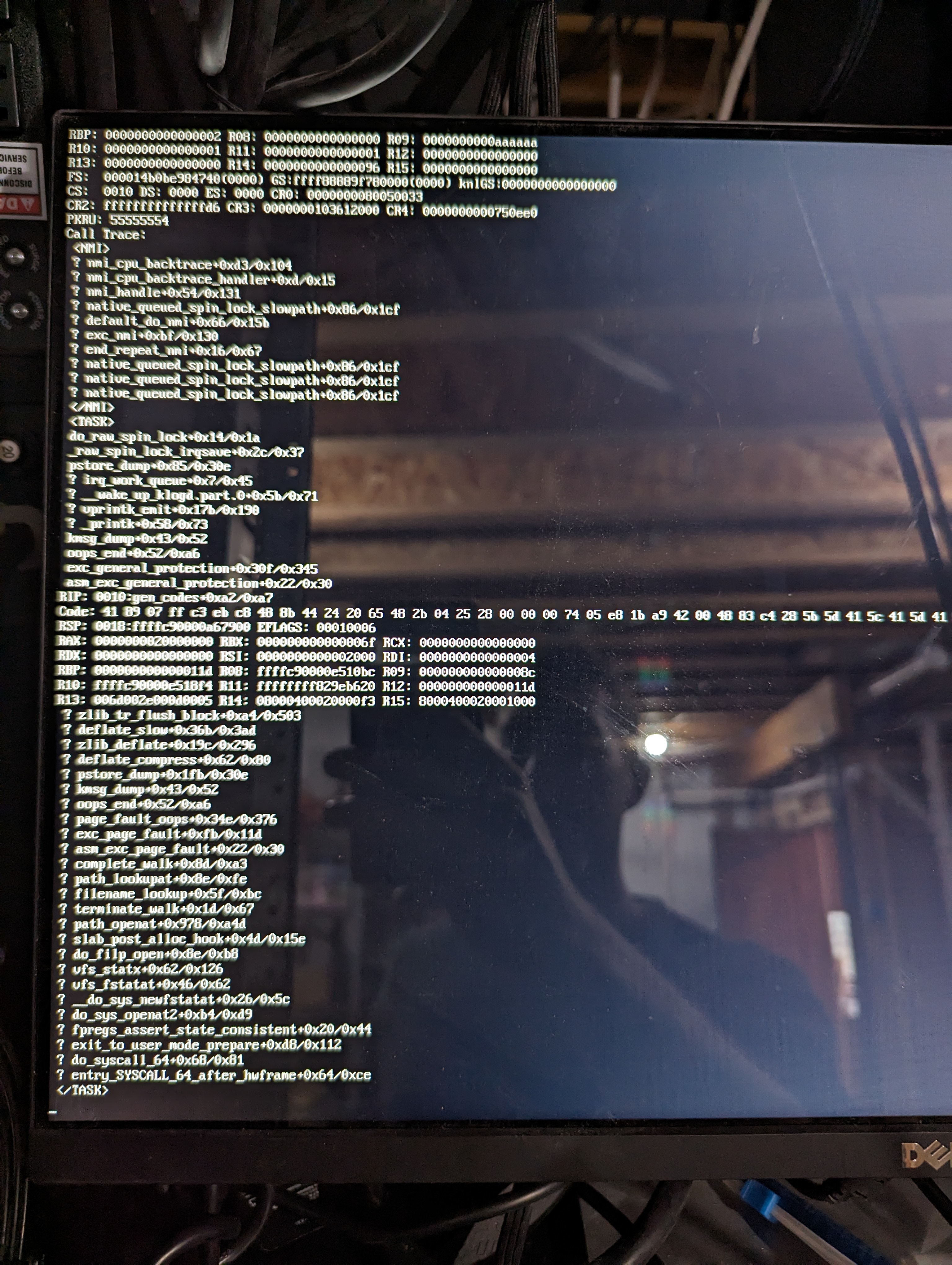

  2. Update: Replaced RAM and PSU -- still can't startup UnRAID. I attached a screenshot of the startup, this looks like a CPU issue to my untrained eye. Can anyone confirm? On the hardware side: Tried multiple flash drives Unplugged all hard drives Replaced MOBO Replaced RAM Replaced PSU I think the only thing left is the CPU?

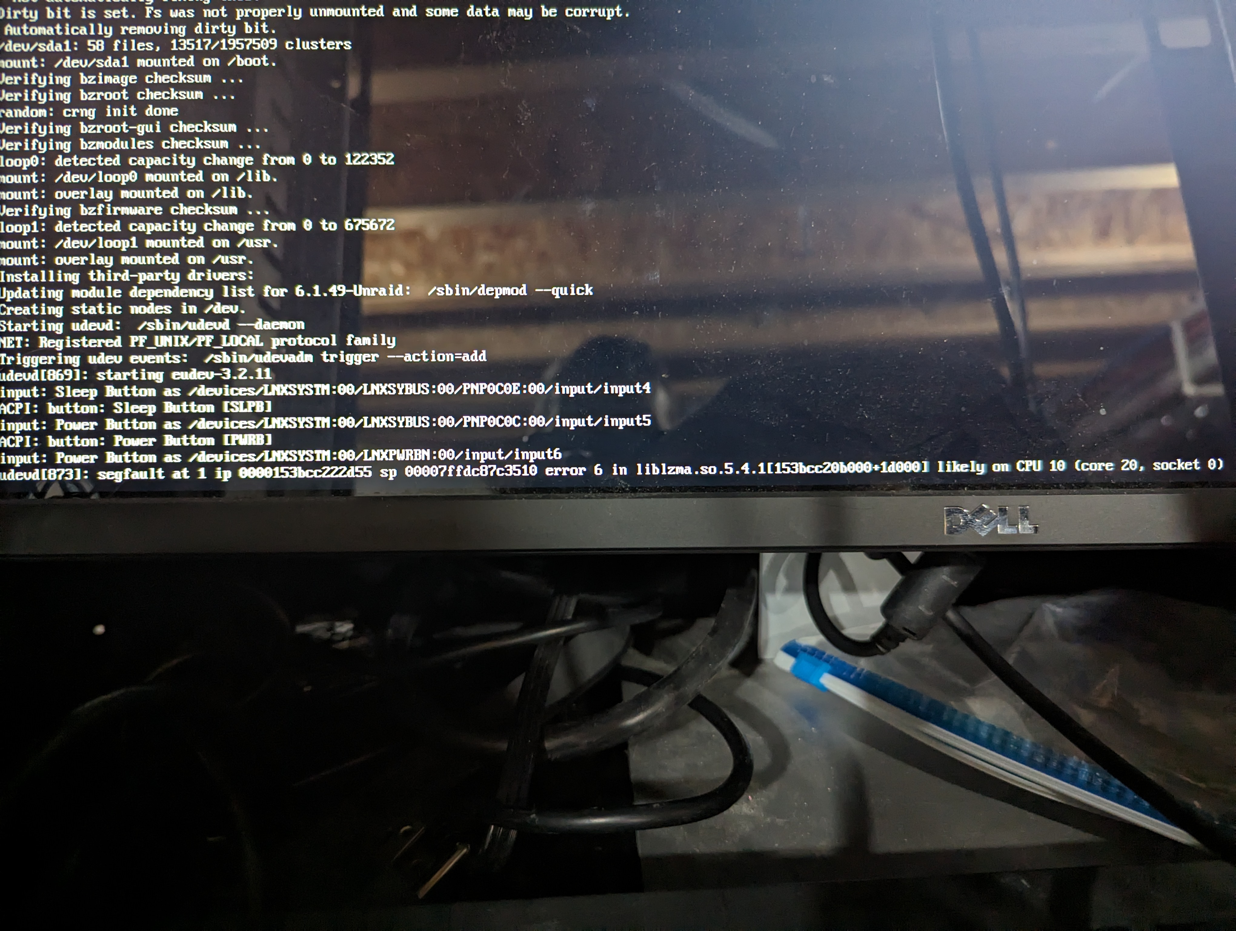

  3. Updated the BIOS. No change. Here is where the boot seems to get stuck. I ordered new RAM and PSU. I doubt both RAM sticks are bad, but I don't know what else to try at this point.
  4. @itimpi Thanks for the suggestion. It is trying to boot in UEFI, but the folder does not have the dash. I should also add that I was able to get UnRAID to load with the same USB on my old server, so I don't think it's a USB issue.

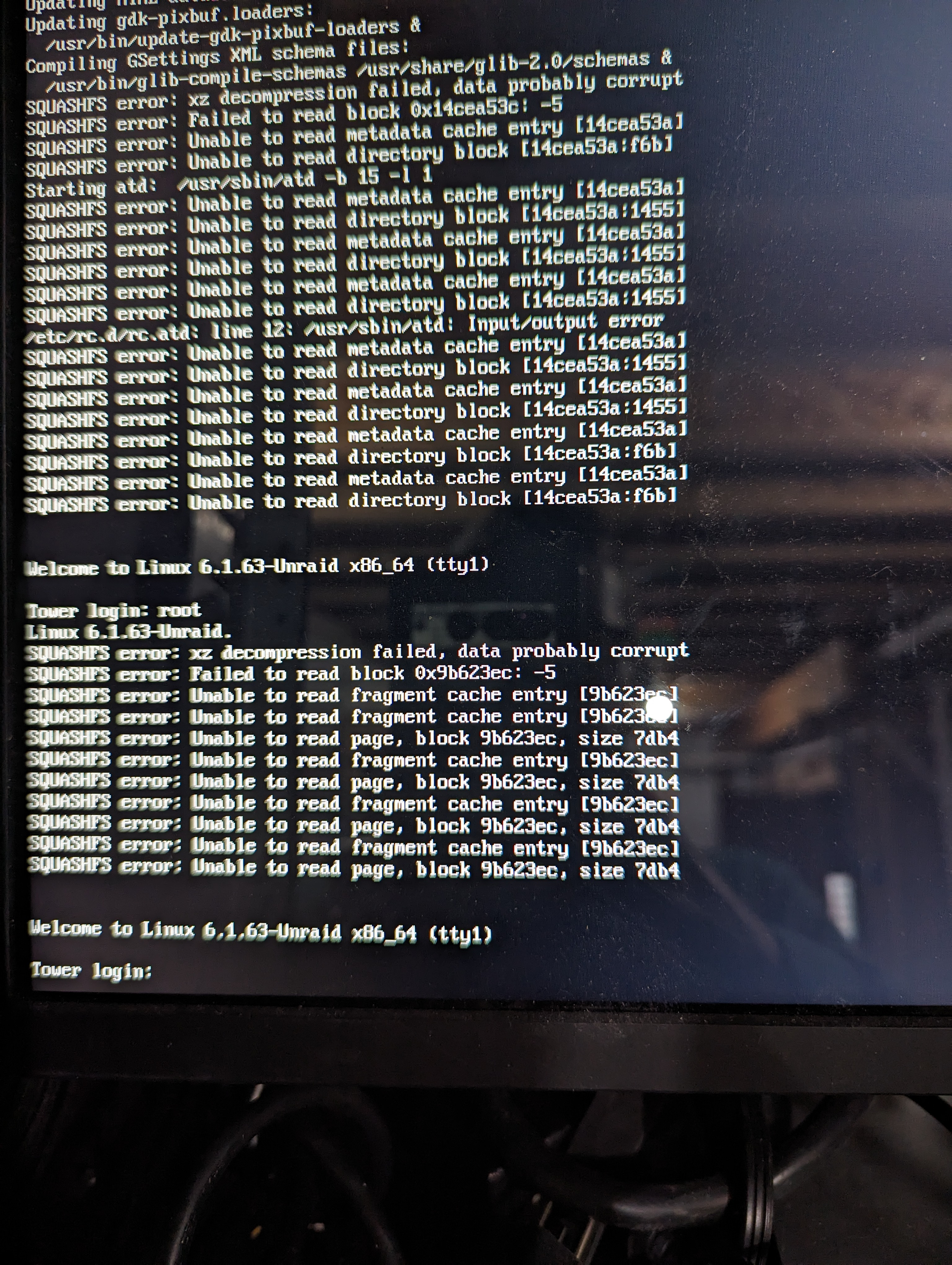

  7. @yyc321 I'll try a clean 6.12.5 install on a USB and see if I can get it started. A few more updates: Loaded the USB on an old server of mine, eliminating flash drive issues Tested each RAM stick individually, same issues continued Loaded a clean install of 6.12.5 on a flash drive, tried to boot and got to the login but then had the following error: SQUASHFS error: xz decompression failed, data probably corrupt SQUASHFS error: Failed to read block 0x9b623ec: -5 SQUASHFS error: Unable to read fragment cash entry (9b623ec)
  8. @JorgeB I just tried booting with a different flash drive with stock Unraid and ran into the same issue. Could this be an issue with my cache drive? I pulled it and tried accessing it from a Windows computer. My computer recognizes it, but I'm not seeing the drive contents anywhere.

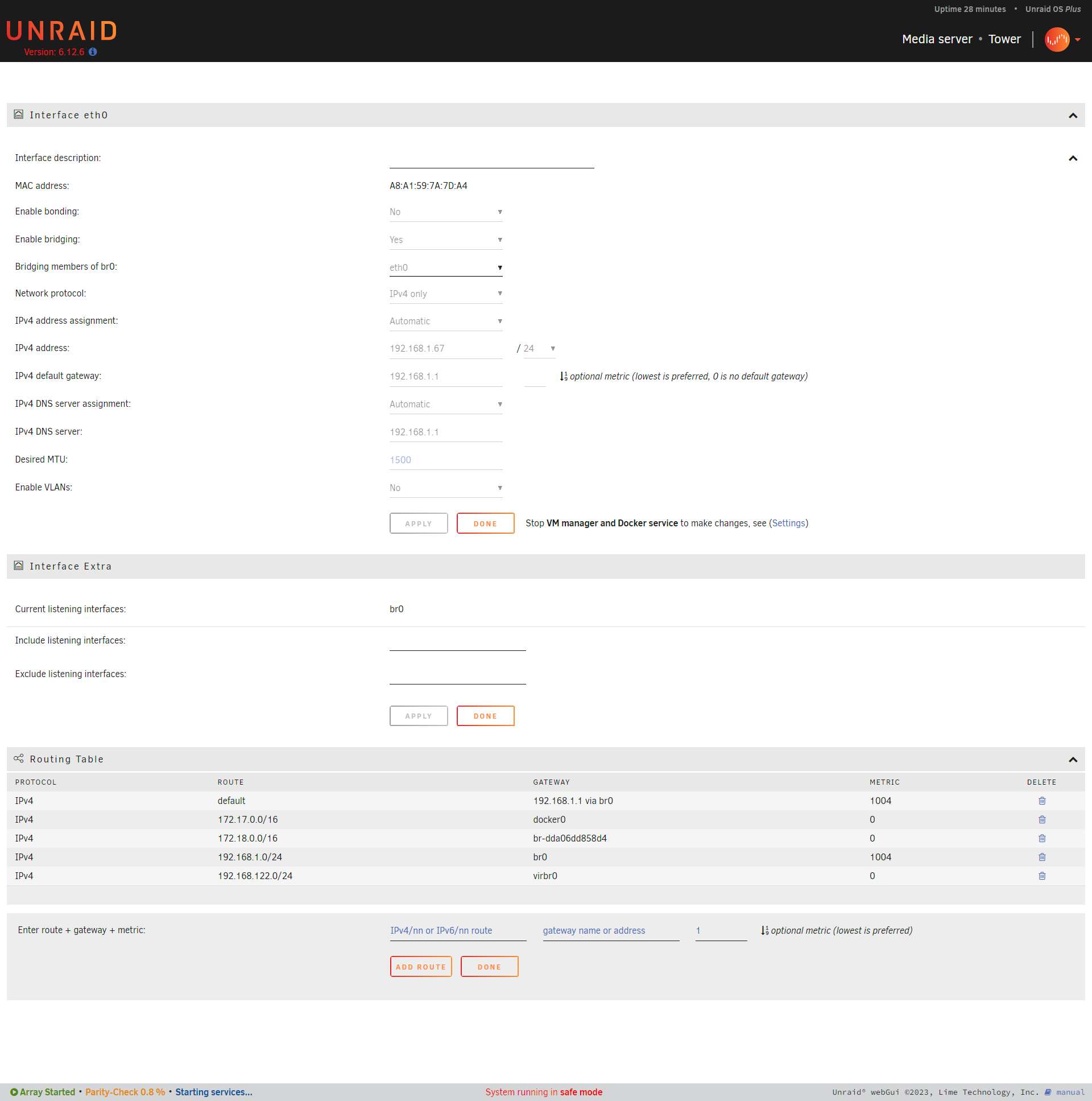

  12. Pardon my noobiness. The flash drive on my server failed a couple weeks ago. I did not have a backup, so I had to start over from scratch. Everything was running fine for a couple weeks, but I'm having a weird issue now. After starting my array, my entire network will go down. Sometimes it happens immediately, sometimes it happens after 6-8 hours. As soon as I disconnect the Ethernet cable, the network is restored immediately. The server also becomes unresponsive, I am unable to access the GUI directly. Here is what I have tried: 1. Starting in safe mode, no plugins or Docker. I do not have network issues in safe mode, but I haven't run it for an extended period of time. 2. Disabled auto-start on Dockers, slowly started Dockers to see if one of the Dockers was causing issues. I did this yesterday -- started a Docker, waited 2 hours, started another Docker. Everything seemed to run fine, but then everything crashed again last night. 3. Swapped the Ethernet cable for a different cable 4. Tried a different port on the switch My network setup: ISP - Starlink Router - Unifi UDM SE I attached diagnostics and my UnRAID network settings. tower-diagnostics-20231206-0749.zip
