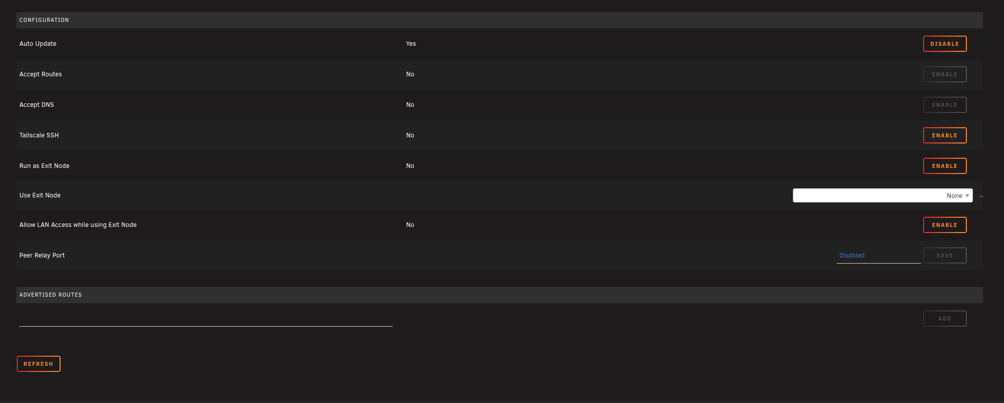

  1. It wasn't turned on: tailscale debug prefs | grep RouteAll "RouteAll": false, I haven't modified default settings of tailscale. I've just logged in. I've tried in version installed from unraid 7.3.0-rc1 installing extras, or uninstalling and installing beta version after that. Same behaviour. See the options, accept routes is not even accepting user enables it. I am attaching the diagnostics. alaska-tailscale-diag-20260426-191625.zip

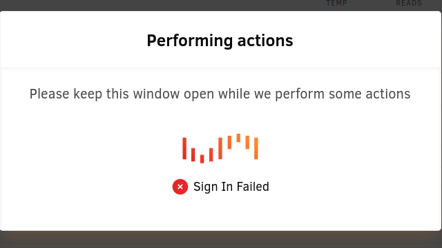

  9. Hello Not for me. I've got fresh new unraid 7.2.2 . also fresh plugin (installed trough terminal with unraid-api plugins install unraid-api-plugin-connect because ui installation one didn't showed up the top right orange icon) I've obtained sign-in error after waiting.
  10. Maybe writing permissions? That happened to me. Check the log and paste it here
