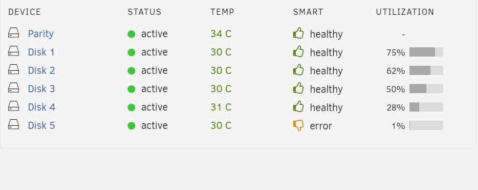

    How come I still see the error ? Everything looks good now. diagnostics-20240606-1128.zip
  2. nico44 replied to nico44's topic in General Support
    I checked the power cable all is good. I did change the sata cable. diagnostics-20240604-1514.zip
  3. I replaced the drive and rebuild it 2 times, restarted the system 3 times and still have the errors. diagnostics-20240604-0933.zip
  4. I will set it up Just installed Fix Common problems - Macvlan and Bridging has been found . In Red Nothing on the SMART warnings from the Dashboard page Parity check will be done soon
  5. I don't know then, but I do have all my data. How can I check to see if the array is working correctly ?
  6. I'm 100% sure that disk 5 went on disk 1 and 2. Disk 5 had about 400 gb before. How do I know that the array are working properly ? Thanks for all the help

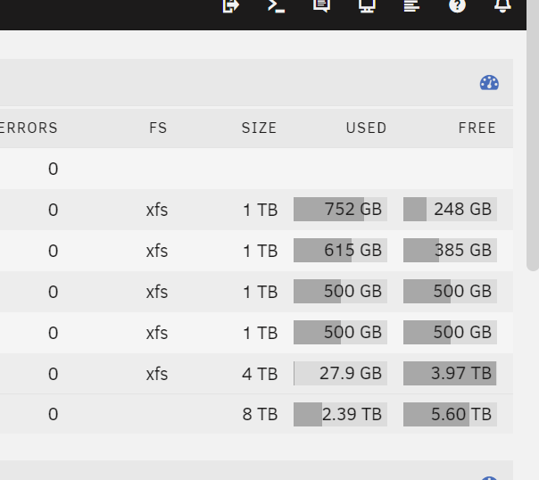

  7. Was going through the files and I see everything is there. The only thing I see on the array is that disk 1 and disk 2 has more gb used and disk 5 has only 27.9gb. Looks like that the old data from disk 5 went on disk 1 and 2 when disk 5 was formatted. Should I do a parity check every week? and add a second parity disk for the extra protection. This would give me the safety of 2 drive failures (including parity drives) ? Thank you for the clarification
  8. Being this is new to me. Looks like the system runs in raid 5, because I was trying to upgrade disk 1 with a bigger drive I had disk 5 fail. I put back disk 1 and it repaired missing files. When I replaced disk 5 with new disk I have formatted it. Does this mean that it is no longer raid 5 and that disk 5 is separate for the array? Or I'm safe from anther drive failure?
  9. Old disk 5 that died had data, New disk 5 that has been installed and formatted.
