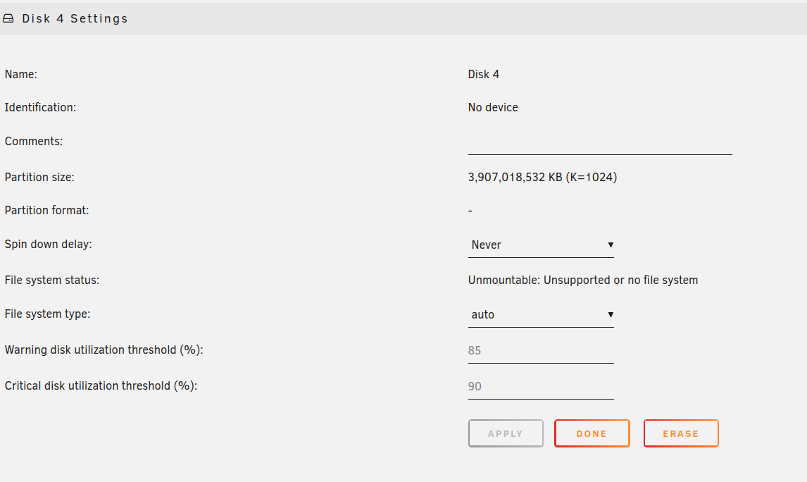

  2. The rebuild finished successfully, now running a parity check. Thanks. Do you think I could do anything with the old disk 4?
  3. root@BigBong:~# xfs_repair -v /dev/md4 Phase 1 - find and verify superblock... bad primary superblock - inconsistent filesystem geometry information !!! attempting to find secondary superblock... .found candidate secondary superblock... verified secondary superblock... writing modified primary superblock - block cache size set to 735560 entries sb realtime bitmap inode value 18446744073709551615 (NULLFSINO) inconsistent with calculated value 129 resetting superblock realtime bitmap inode pointer to 129 sb realtime summary inode value 18446744073709551615 (NULLFSINO) inconsistent with calculated value 130 resetting superblock realtime summary inode pointer to 130 Phase 2 - using internal log - zero log... zero_log: head block 3035810 tail block 3035810 - scan filesystem freespace and inode maps... sb_icount 0, counted 1504704 sb_ifree 0, counted 5195 sb_fdblocks 976277679, counted 40592957 - found root inode chunk Phase 3 - for each AG... - scan and clear agi unlinked lists... - process known inodes and perform inode discovery... - agno = 0 - agno = 1 - agno = 2 - agno = 3 - process newly discovered inodes... Phase 4 - check for duplicate blocks... - setting up duplicate extent list... - check for inodes claiming duplicate blocks... - agno = 0 - agno = 3 - agno = 2 - agno = 1 Phase 5 - rebuild AG headers and trees... - agno = 0 - agno = 1 - agno = 2 - agno = 3 - reset superblock... Phase 6 - check inode connectivity... - resetting contents of realtime bitmap and summary inodes - traversing filesystem ... - agno = 0 - agno = 1 - agno = 2 - agno = 3 - traversal finished ... - moving disconnected inodes to lost+found ... Phase 7 - verify and correct link counts... Note - stripe unit (0) and width (0) were copied from a backup superblock. Please reset with mount -o sunit=<value>,swidth=<value> if necessary XFS_REPAIR Summary Sun Jun 26 07:52:29 2022 Phase Start End Duration Phase 1: 06/26 07:48:35 06/26 07:48:36 1 second Phase 2: 06/26 07:48:36 06/26 07:48:38 2 seconds Phase 3: 06/26 07:48:38 06/26 07:50:43 2 minutes, 5 seconds Phase 4: 06/26 07:50:43 06/26 07:50:44 1 second Phase 5: 06/26 07:50:44 06/26 07:50:46 2 seconds Phase 6: 06/26 07:50:46 06/26 07:52:28 1 minute, 42 seconds Phase 7: 06/26 07:52:28 06/26 07:52:28 Total run time: 3 minutes, 53 seconds done Here is the result. It worked, and the emulated contents can be read without issue. Should I go for rebuilding to the replacement disk?

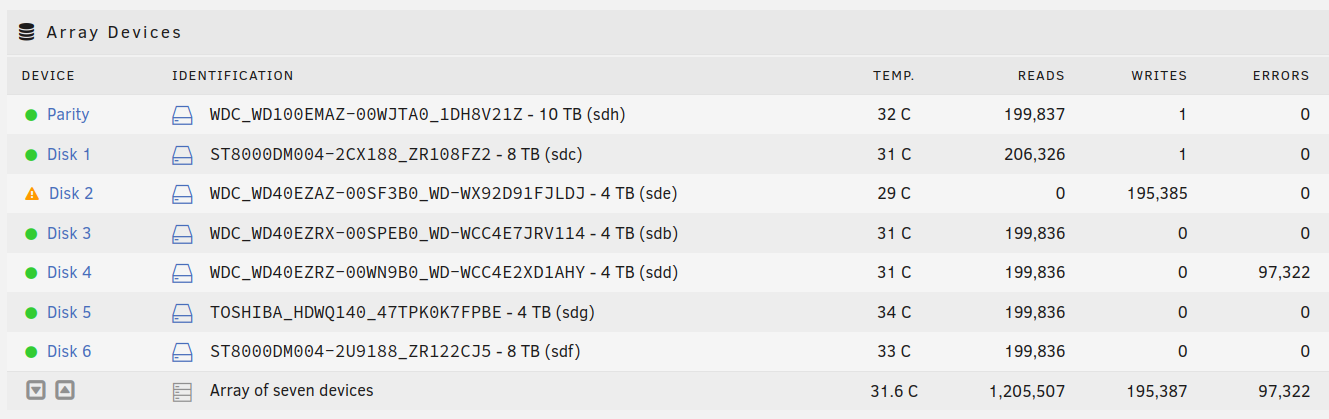

  4. bigbong-diagnostics-20220626-0709.zip The menu for disk 4 doesn't have any other options.

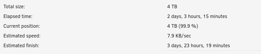

  7. bigbong-diagnostics-20220626-0410.zip Here Thank you for checking it out. This disk is currently not in a disabled state. Since it now has a value for current pending sector I'm assuming it needs to go.
