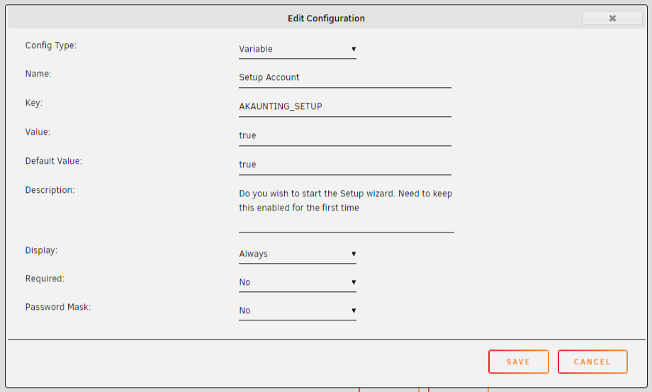

  • @eirizarry @Curtis777 @dgwharrison @feins I got mine to work. set AKAUNTING_SETUP=false I think because the container has setup variables, it's expecting setup to be false... Maybe not. But it wor

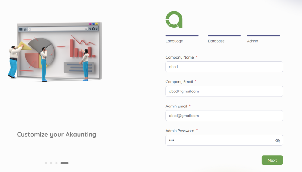

I solve it  with this
php artisan install --db-host="localhost"  --db-port="3306"  --db-name="akaunting"  --db-username="root"  --db-password=""  --db-prefix="ak3"  --company-name="My Company"  --company-email="myemailcompany@gmail" --admin-email="[email protected]"  --admin-password="mypass"  --locale="es-ES"

If I change Setup Account to False, all the errors go away in the logs and the akaunting web just shows "Whoops, looks like something went wrong."

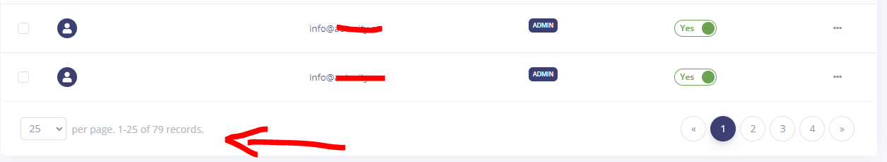

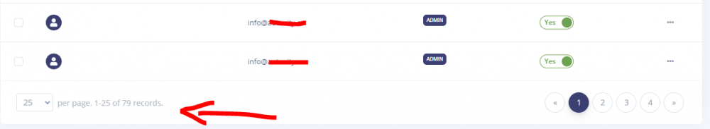

On 3/13/2022 at 4:11 PM, war1000 said:
Can someone kindly help me with this? Even time I restart the docker container for akaunting, it creates a new admin use with the email set in the docker settings. Now I have 79 users when I go into my Admin users view.
If I set the following settings to false, it does not connect to the db I think anymore.
 I have exactly the same problem, if setup is set to true, multiple users are created using the user details in the config, if setup is set to false, it does not connect to database. Any ideas?
This is what is in the log - it looks like the user does not exist:
