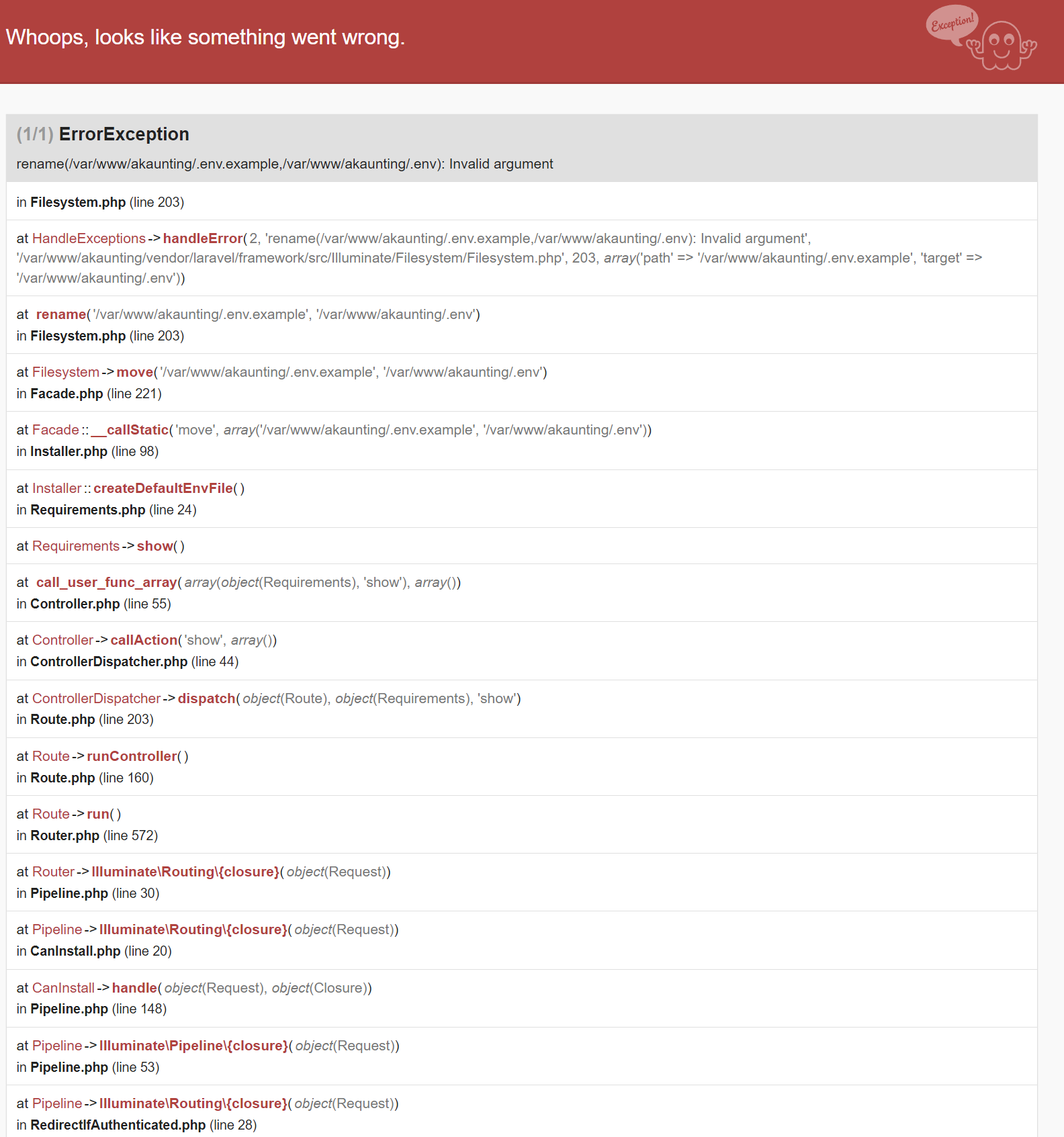

** Press ANY KEY to close this window **
1214830609_ScreenShot2022-09-29at2_10_54PM.thumb.png.2eb22813fe2ee22311e65102157e85f5.png
Thanks
Having the same issue. I stupidly updated this container thinking it would be fine and it just went to hell. I managed to get the php artisan issue fixed by adding DB_PORT and DB_NAME as variables for the container, however when I try to log in I am having this issue where it is throwing a 500 whenever trying to login. Nothing seems to be fixing it.
EDIT: I managed to go through all the latest docker versions downgrading until it worked again. Made it to "akaunting/akaunting:3.0.0" in which everything started working again. Moral of the story, don't update your main instance.
Edited by 97WaterPolo

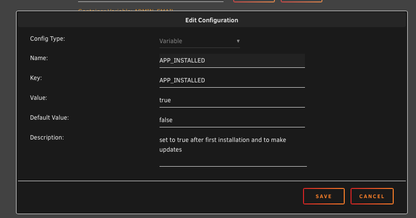

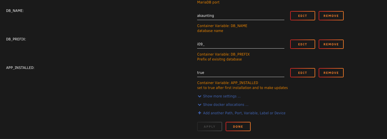

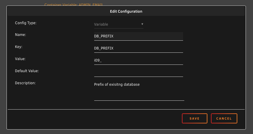

Discovered a solution to updating the container without issue.  Adding variables for "DB_PREFIX" and "APP_INSTALLED=true" did the trick for me.  Got some help from these posts:
https://github.com/akaunting/docker/issues/61#issuecomment-1143664641
https://github.com/akaunting/docker/issues/107
For the DB_PREFIX variable,  you will need to use the first 4 characters seen in your specific existing database tables names.
I would advice backing up your database and appdata before making these edits.

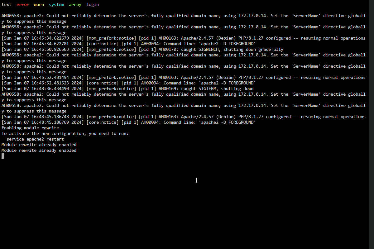

I've just install Akaunting and setup postgresql15.
When i try to launch Akaunting the log show this error and no login page.
Enabling module rewrite.
To activate the new configuration, you need to run:
  service apache2 restart
❌ Some options are missing and --no-interaction is present. Please run the following command for more information :
❌ php artisan help install
❌ Missing options are : db-port, db-name
I'm having exactly the same issue.  Did you get it running? @Yoda can you help?

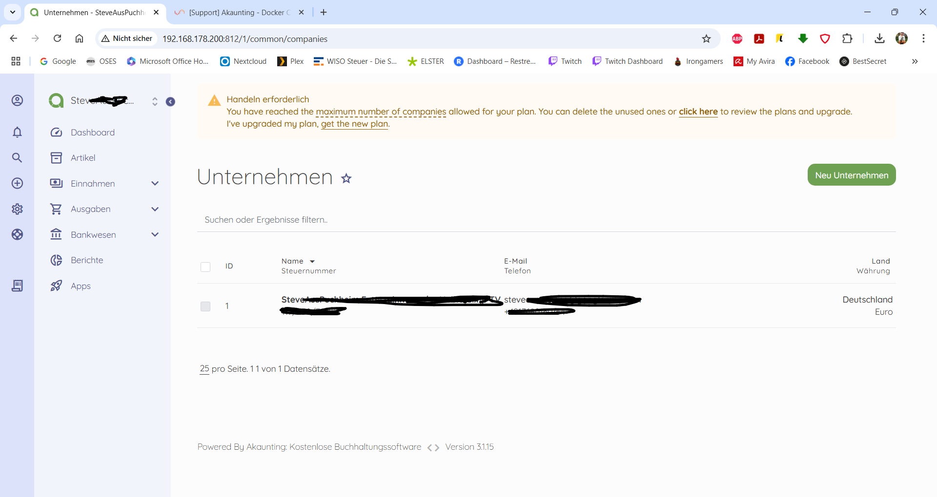

Hello, i have a problem with my akaunting docker. Akaunting says i have reached the maximum number of companies but i have only one companie. How i can fix this?  image.thumb.png.7218ddb57f8805b45e2b6f60aa26e674.png

@eirizarry @Curtis777 @dgwharrison @feins I got mine to work.
set AKAUNTING_SETUP=false
I think because the container has setup variables, it's expecting setup to be false... Maybe not. But it worked for me.
