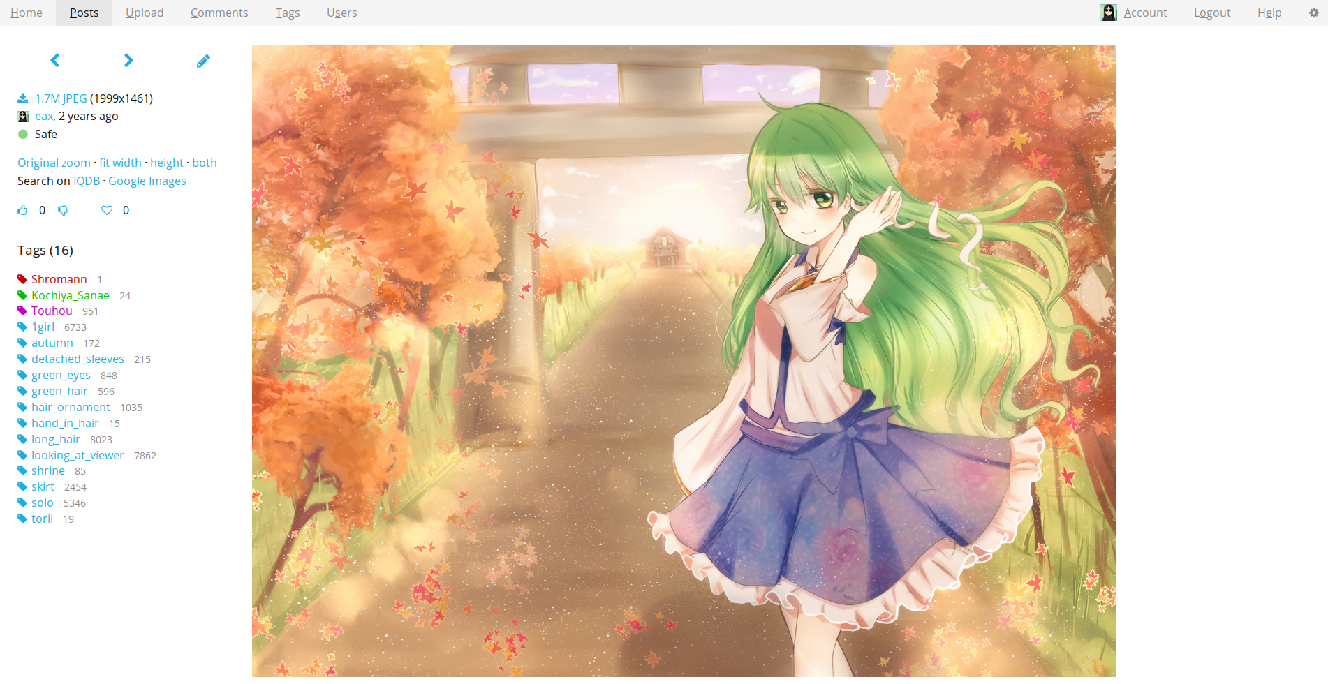

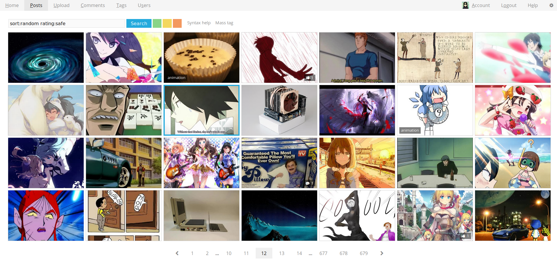

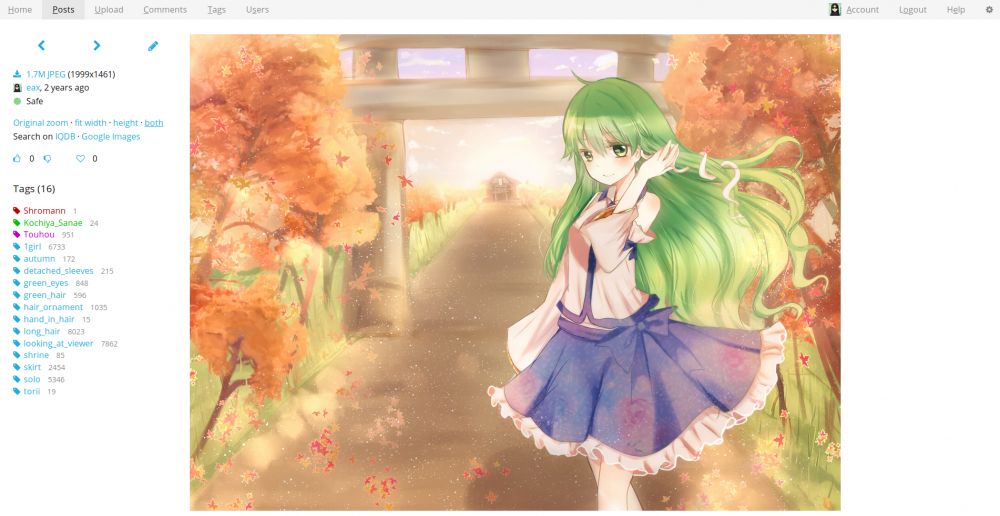

Overview
Szurubooru is an image board engine inspired by services such as Danbooru, Gelbooru and Moebooru dedicated for small and medium communities. It is pronounced as shoorubooru. Some features:
  • Post content: images (JPG, PNG, GIF, animated GIF), videos (MP4, WEBM), Flash animations
  • Ability to retrieve web video content using youtube-dl
  • Post comments
  • Post notes / annotations, including arbitrary polygons
  • Rich JSON REST API
  • Token based authentication for clients
  • Rich search and privilege system
  • Autocomplete in search and while editing tags
  • Tag categories
  • Tag suggestions
  • Tag implications (adding a tag automatically adds another)
  • Tag aliases
  • Duplicate detection
  • Post rating and favoriting; comment rating
