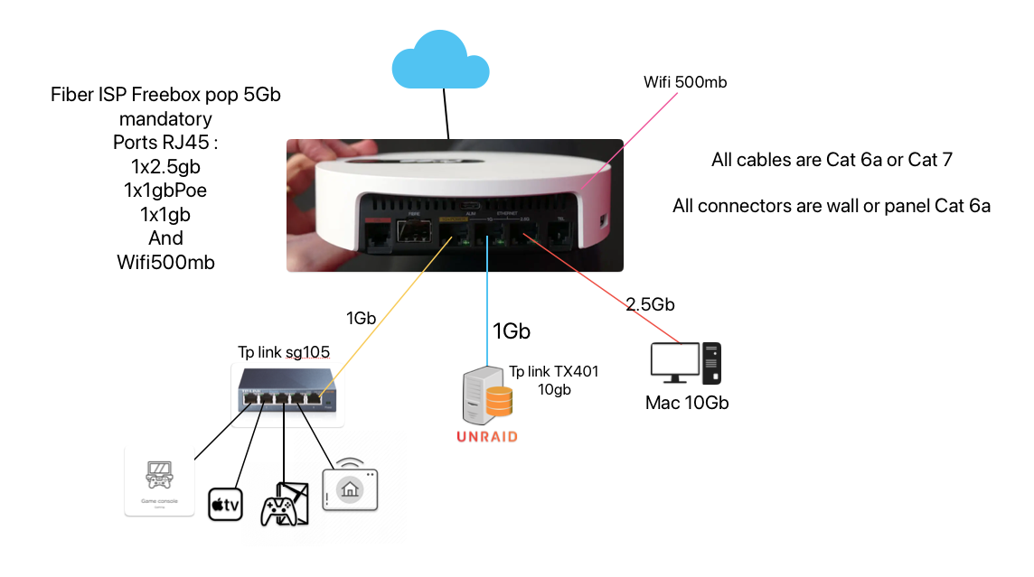

  4. Thank you very much for your 2 answers, it's much clearer now thanks to you. I'm really very bad at networking So I need to put a switch after my router, thanks for the switch reference. One last question: is it possible (and useful) to connect the 3 ports of my router to the switch to use the maximum 4.5gb that my router has?
  5. I may sound silly, but I think I'm misunderstanding the way my network works. I made this shema to understand it better. I have a freebox provided by my ISP which is capable of 5Gb spread over 1x2.5Gb, 1x1Gb, 1xGb poe and wifi at 500mb. This router is obligatiore and can not be replaced by another router if my research on the internet is good. Each port of this router is connected by Cat7 rj45 to the rj45 panel with Cat 6a connector in my communications cabinet. One cable goes to my computer which is 10gb capable, another cable goes to a 1gb switch and the last cable goes to my Unraid nas. I thought that with my cables, connectors and network cards I could communicate between my Nas Unraid and my computer in 10Gb but I think I'm making a mistake. As the data goes back through my router and my nas is connected to my router on a 1gb port then this same port limits the speed to 1gb between my Nas and my PC? Is that it? If so, how can I get a 10gb connection between my Nas and my PC?
  6. Yes i tried with a Cat 6a and Cat 7 in the bundle. My apartment is only 1 year old and has Cat 6a wiring.
