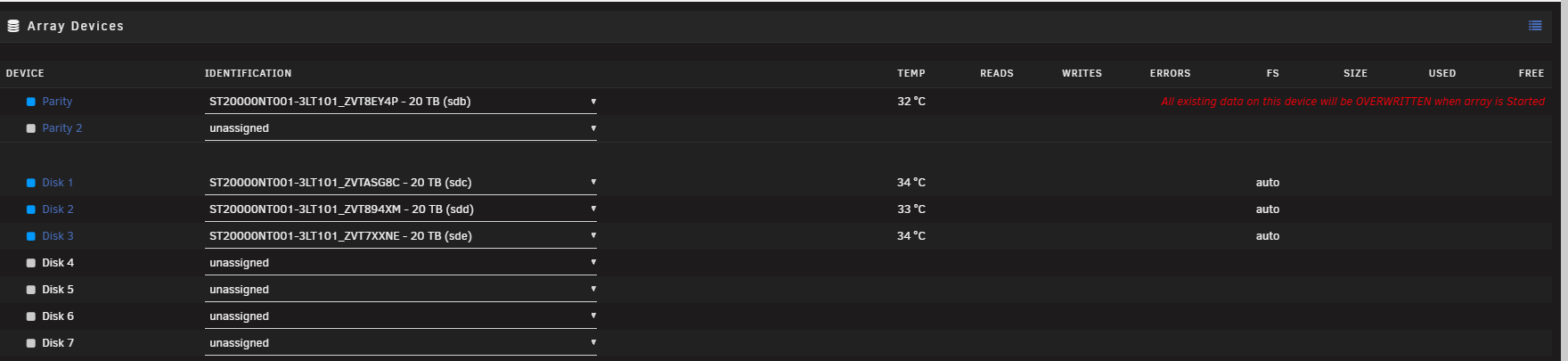

  12. I have set Disk 4 back to the parity drive and started the new config I am however, getting errors coming up like those in the screenshots How should I proceed? I have paused parity sync for the moment

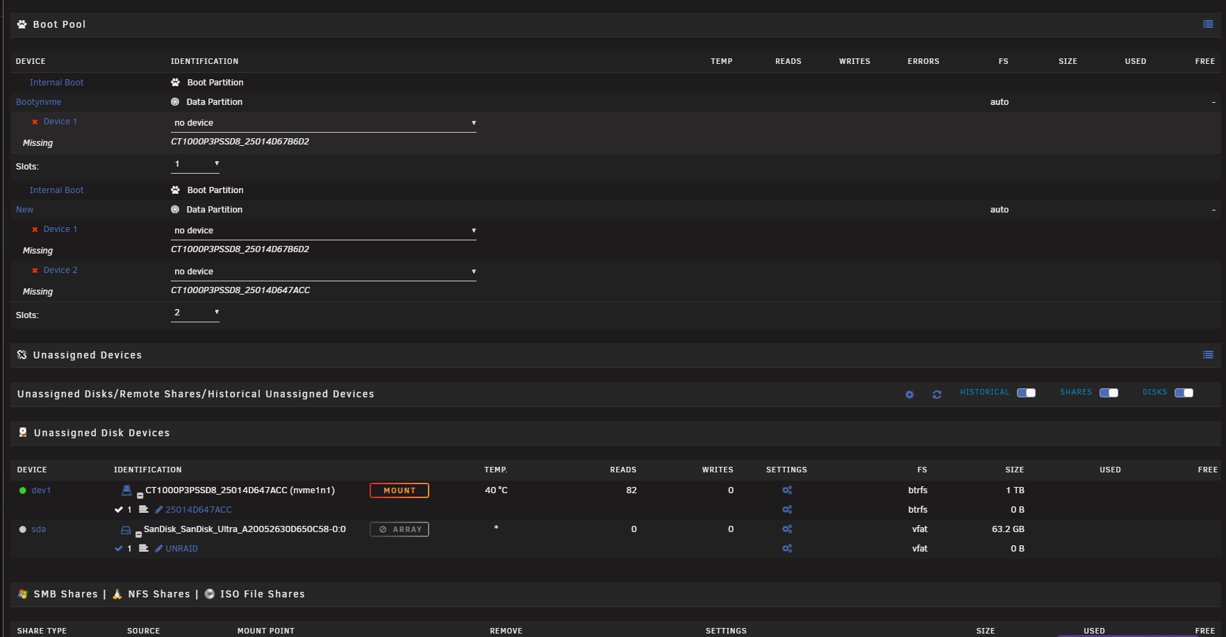

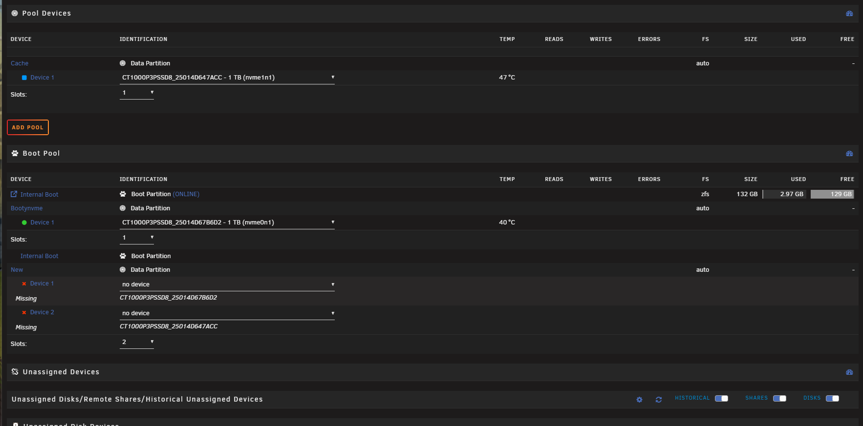

  14. Thank you for the quick reply @UnraidSecretaryOffice - I have attached the diagnostics zip to this post. - I unfortunately do not remember the name of the pool. I think it was called 'cache', but I'm not too sure. - I did run it more than once. I feared I did it wrong the first time, and running again it would correct the issue. - I have an older backup of the USB stick, and appdata is backed up by Unraid on the server. As for the "All existing data on this device will be OVERWRITTEN" warning, I did do the tools -> newconfig, as it thought that might allow me to start again with the drives. It was foolish of me, as I should not mess with things I know nothing about. I have got the missing drive back up and showing in the cache pool, and the drive is in the boot pool now, where I originally put it Please see the screenshot: mainmediaserver-diagnostics-20261011-1452.zip

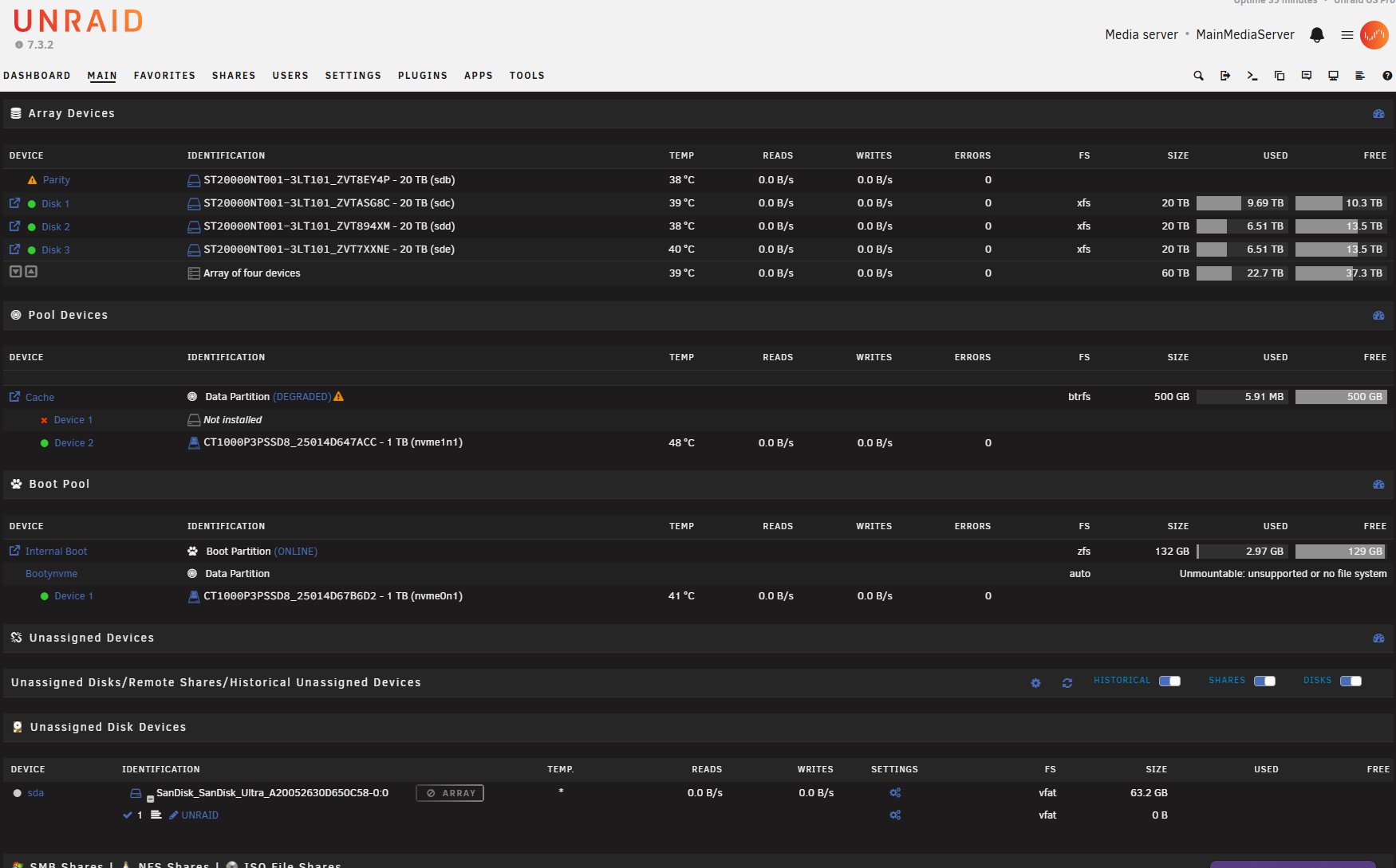

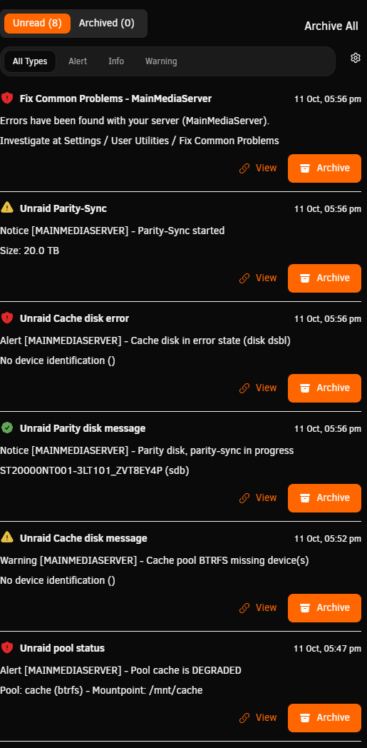

  15. Hiya, I have a big problem I cannot seem to get around. I tried to move to internal boot using one of the NVMe's I have on the system that was in a cache pool. I rebooted the system, and now I have no boot device, no cache pool, and somehow I have a message saying: All existing data on this device will be OVERWRITTEN when the array is started. On my array, which I DO NOT want to happen lol. I am a BIG novice. I set this server up watching a YouTube video 3 years ago and have not touched it bar using it to add my blurays for media storage, so please bear with me as I am not clued up on the Linux and Unraid side of things. If anyone would be able to advise me on how to get around getting things back to normal, I would be forever grateful, as I have A LOT of media I would like to keep This is the message I have about overwriting data: Here are the errors I have with the internal boot: You can see in the unasigned there is an NVMe. I think this was supposed to be in the cache pool. My memory stick is there too but not used as the boot, as I can remove it and it still boots up to unraid. Thank you
