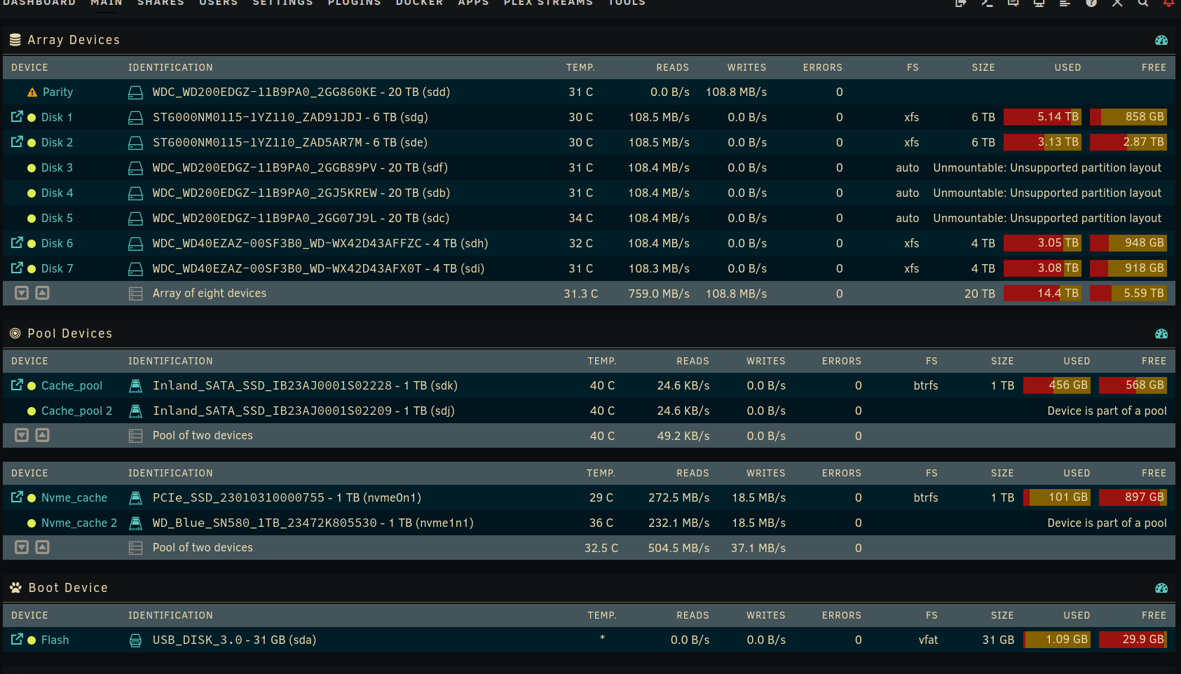

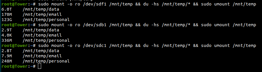

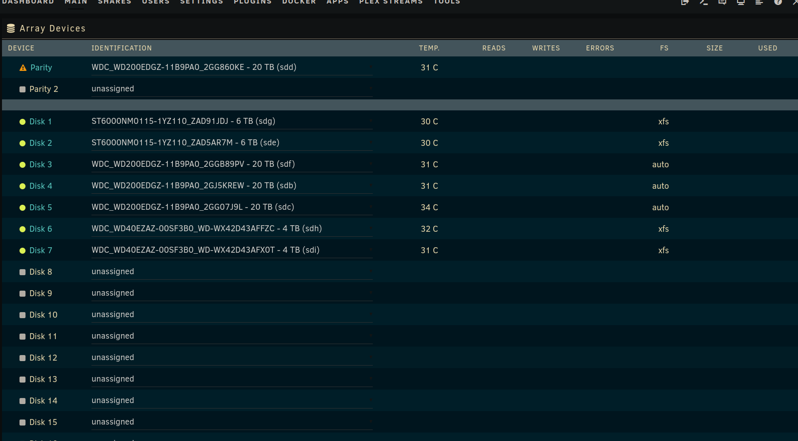

  8. I've probably gone about this the wrong way it seems. But I can't get my disks to be recognized correctly after shucking them out of the enclosure. I had precleared and did data rebuilds on them after swapping out the old disks, but I did this all via USB. Unfortunately that seems like the wrong move, cause the serial number changes and the drive is not recognized when you connect it via the SATA ports... Anyways, I've not done anything up to this point except for `Tools > New Config` a few times to try different orders of drives. This is what it looks like before starting up (sdf, sdb, sdc, and sdd are the new drives - I verified via the Power On Hours that sdd is indeed the parity drive, but all the other drives sdb/sdc/sdf are data drives and not sure which order they go in, if that matters). After starting up it looks like this: Also I've looked in the terminal and can see that the data is intact on the drives, they each have data, and the folders are identical to my shares. So i'm confused why the partition would not be valid (at least according to unraid). Any help would be appreciated! I am at the limit of my knowledge here... tower-diagnostics-20241101-2144.zip
