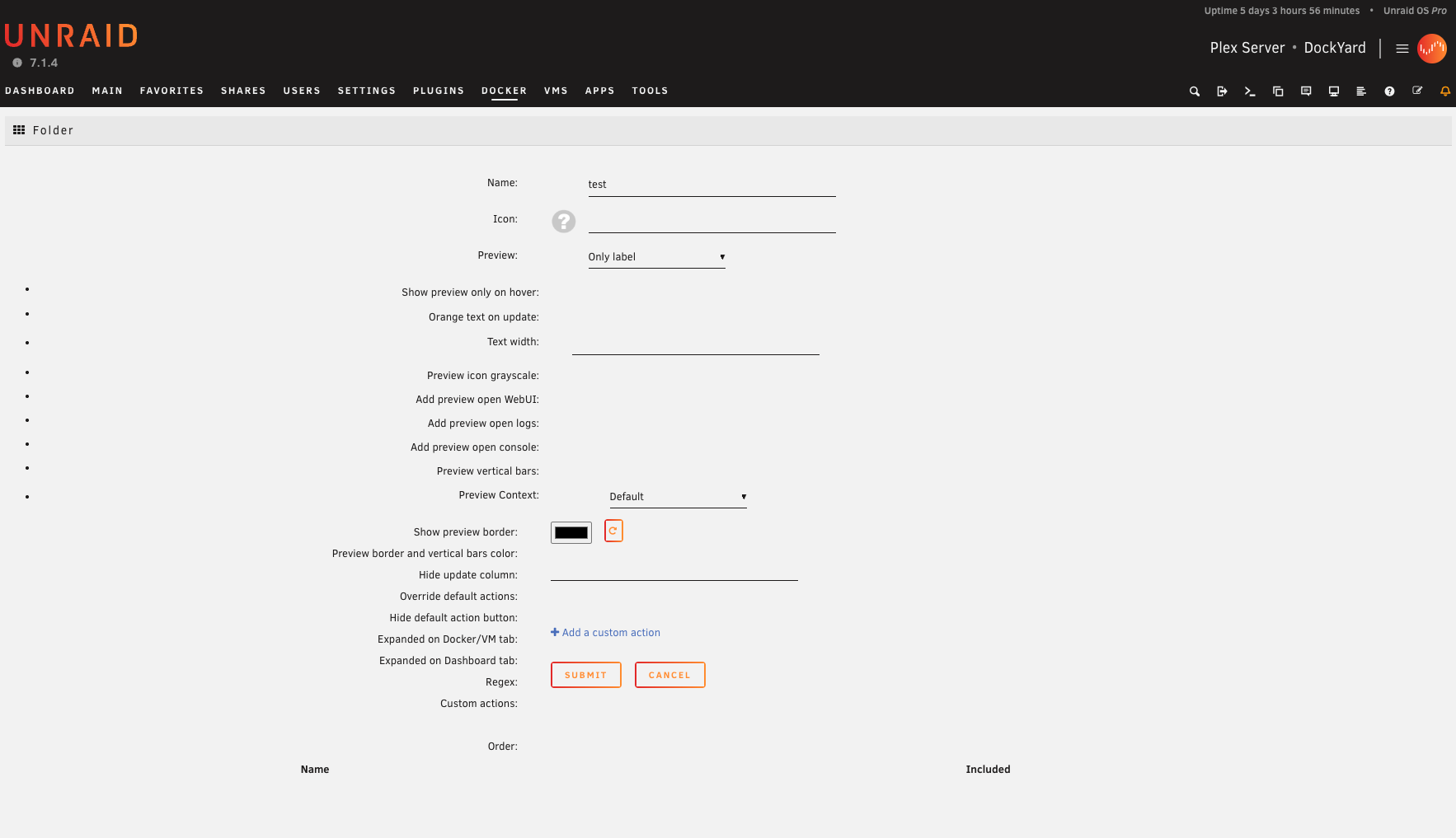

  11. I can not see the actual containers to add to the folder. All of the existing folders are in the same state, none of the existing containers are there, and can not add new ones.
