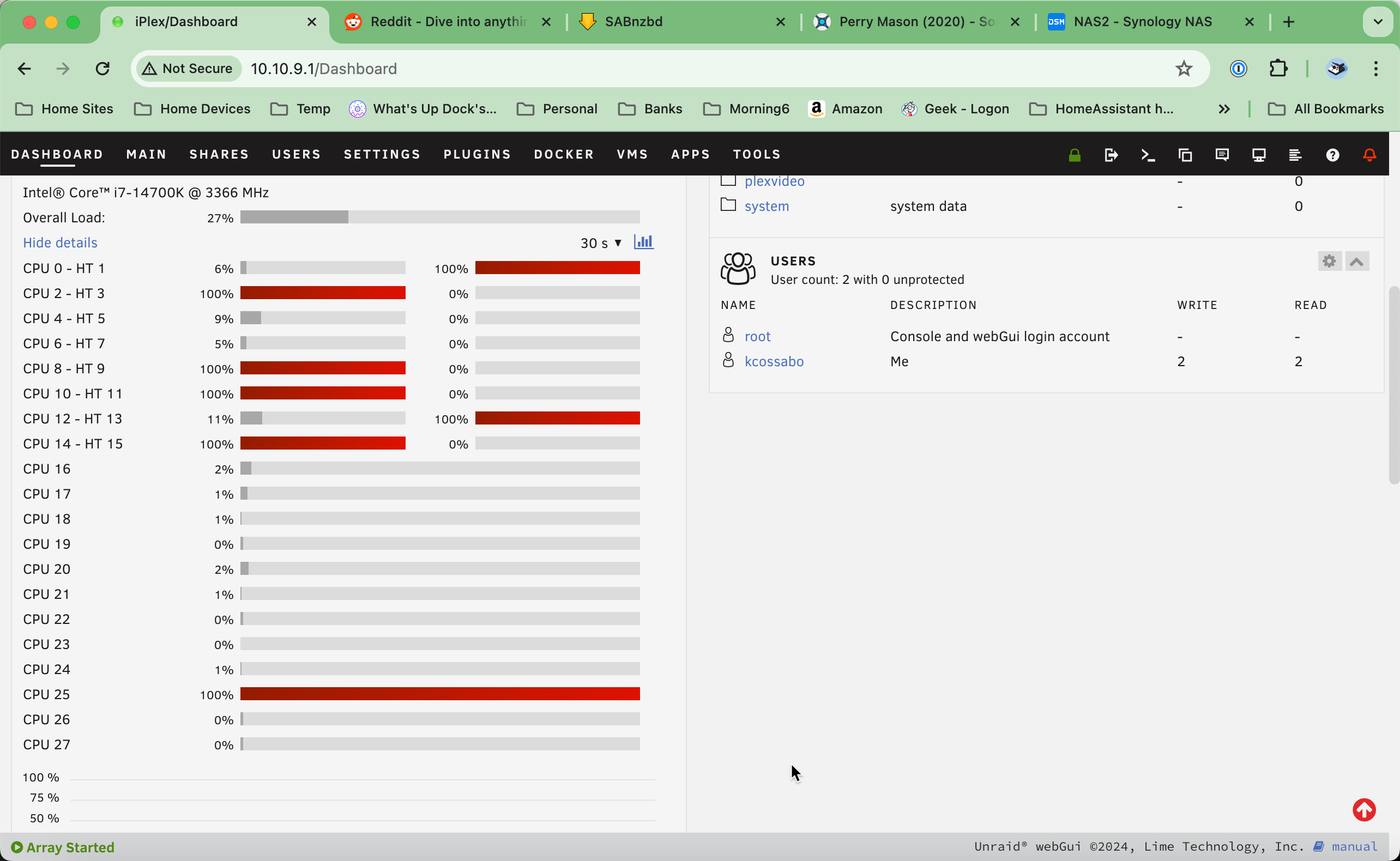

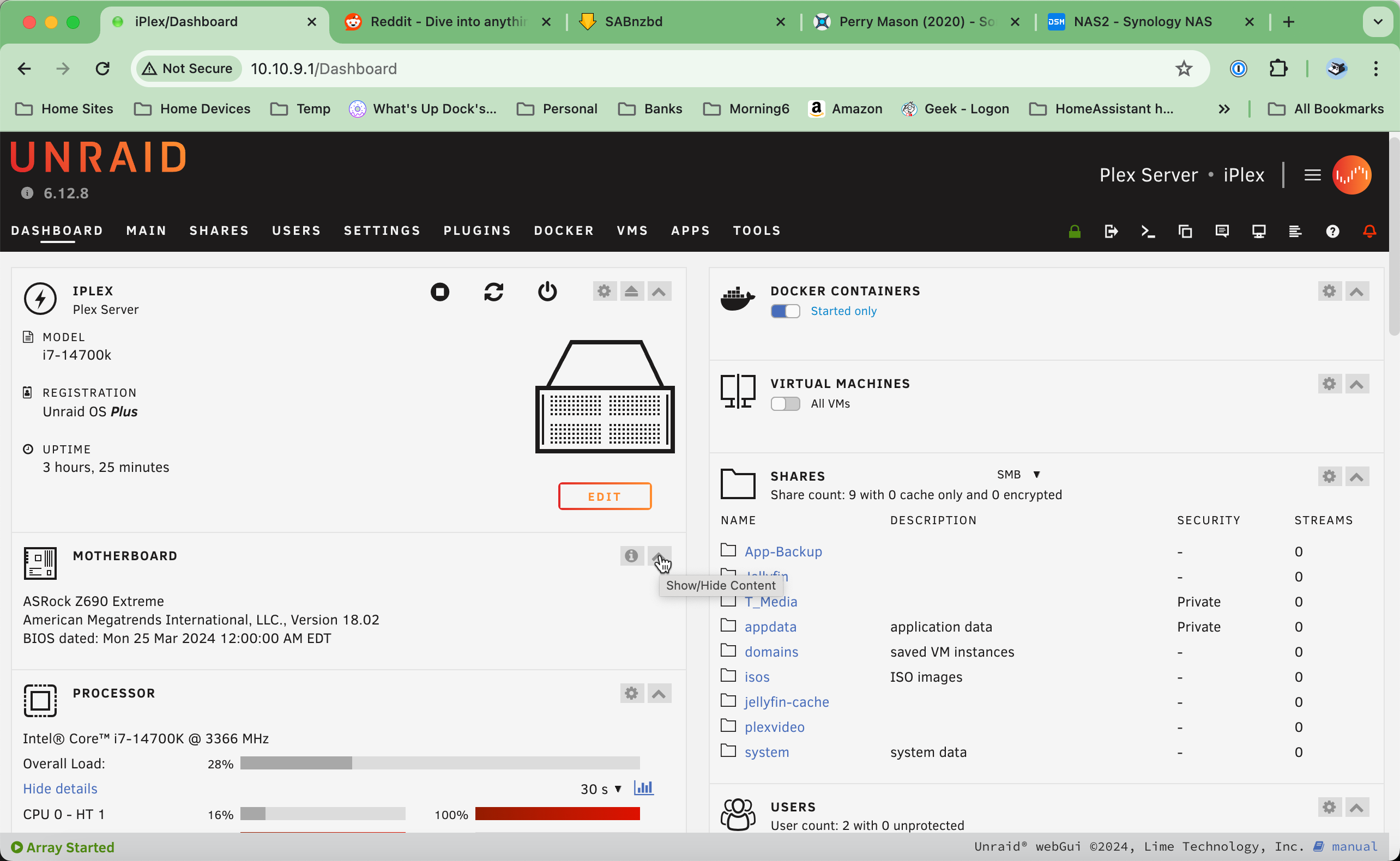

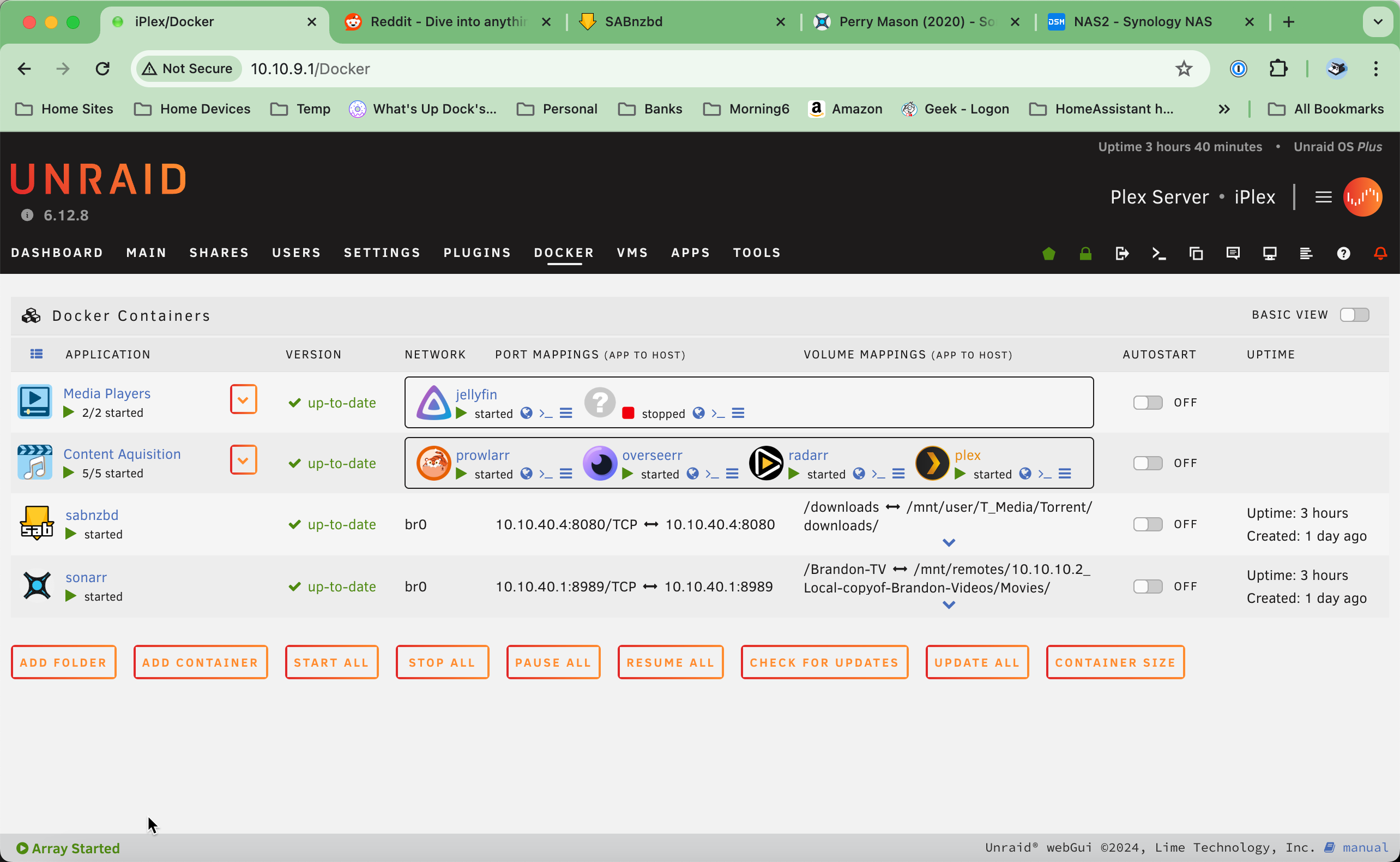

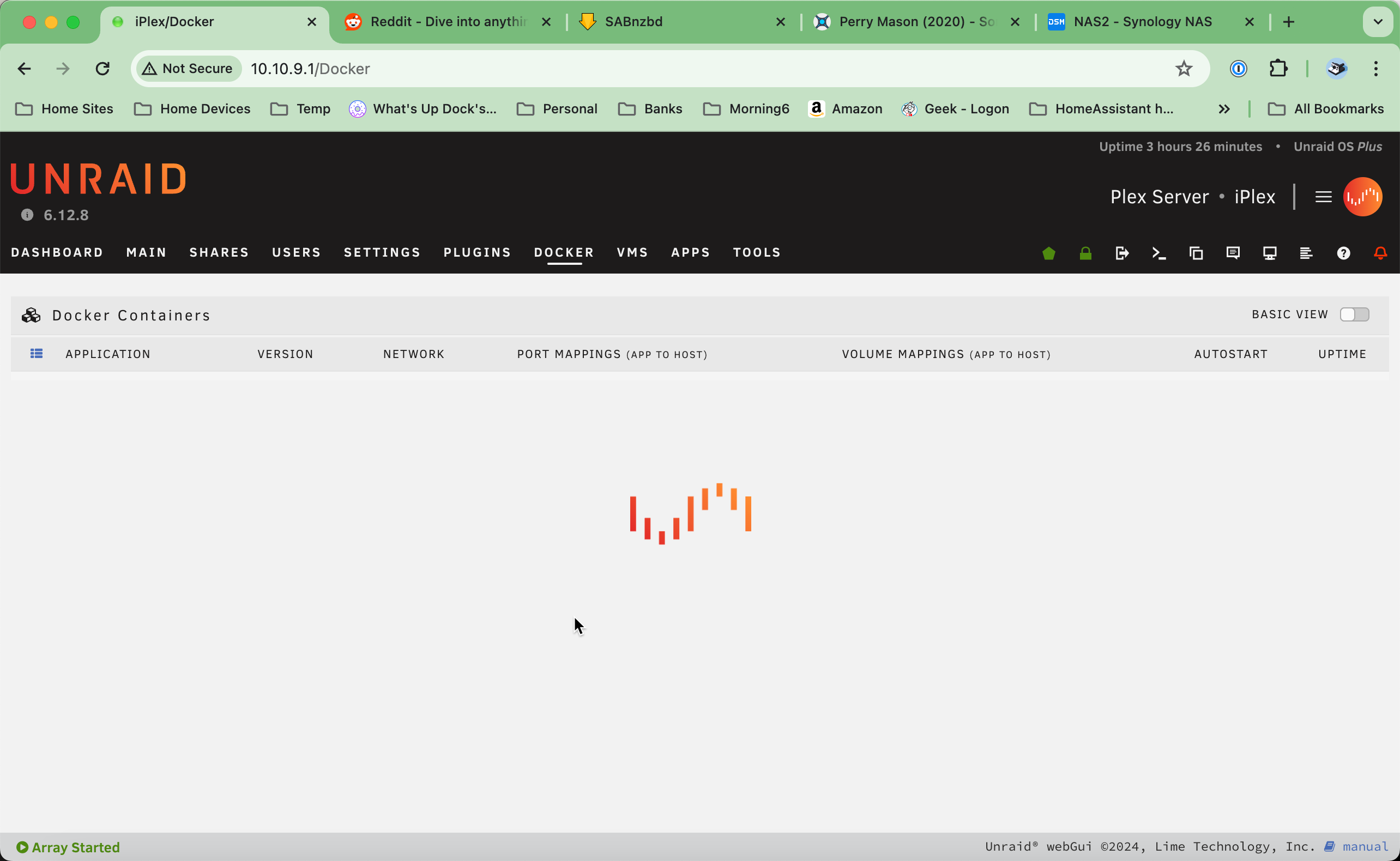

Using Plex unraid high CPU on cores, that never change No dockers shown on the dash board Can not view dockers (took over 1 minute) Waited, and partial list Please help
