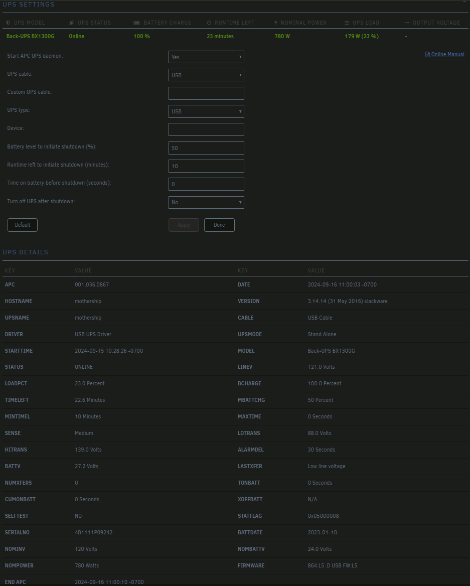

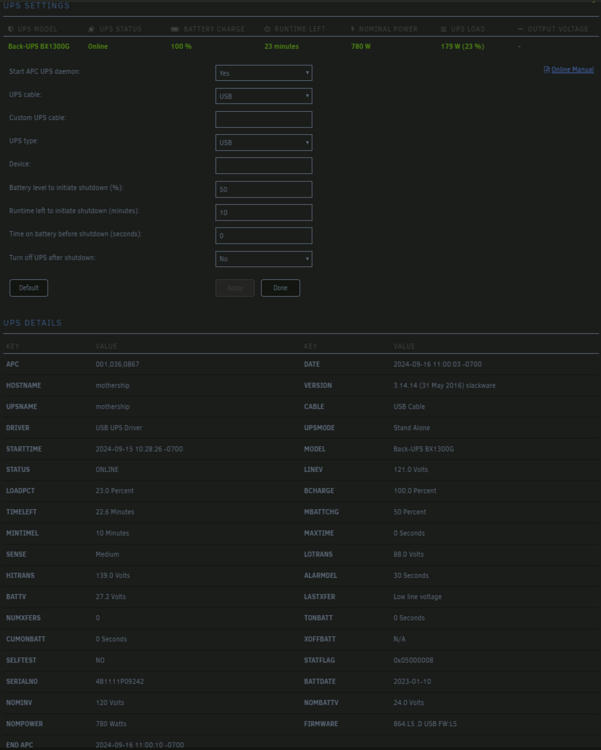

  3. Over the weekend I unplugged my UPS to do some cleaning. All systems were running off of battery normally. Based on my configuration (below) my Unraid initiated a shutdown after the battery levels/duration criteria was met. However, when I went to turn the Unraid server back on, it booted to BIOS instead of Unraid. After further review, the computer couldn't see the Unraid USB Flash. I plugged the USB Flash into a Windows PC that stated it was corrupted. I used a data recovery tool to image the Flash and see if data was recoverable. For the most part it seemed I could pull most data of the drive, albeit it not gracefully. I ended up formatting/reinstalling Unraid on the same USB Flash (new one ordered) and copied my /config over. The system came back up (based on the older backup I had). Any idea why the USB Flash got corrupted? Any logs I can review?

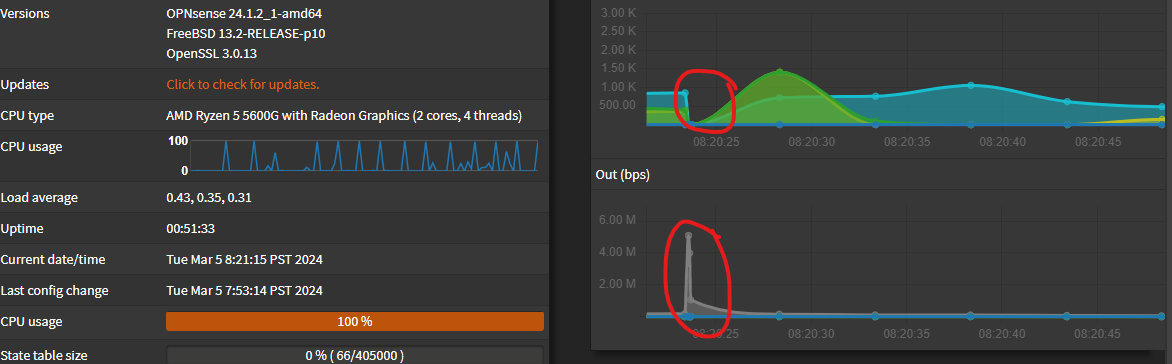

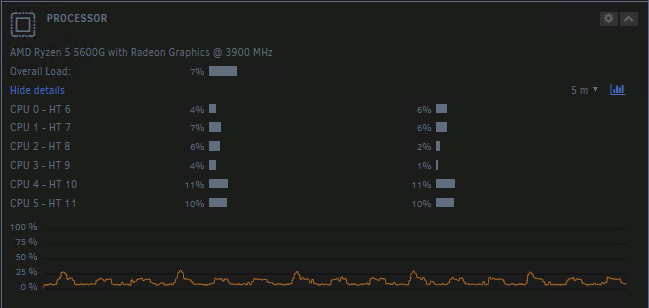

  6. Hey Community, I installed OPNSense as a VM over the weekend, connecting bridge interfaces to the firewall. While OPNSense is running, I've noticed every 30-60 seconds OPNSense hangs/unresponsive for about 5-10 seconds, recovers with 100% CPU (in the VM's dashboard), then returns to normal before repeating the cycle. I had initiated a forum post over at OPNSense and they suggested it could be Unraid's emulation of the NIC and to passthrough NIC instead. This is not ideal as I'd like to use bridge interfaces to firewall VMs and containers. Here are some observations: NIC is a quad port Intel Corporation 82571EB/82571GB Gigabit Ethernet Controller (Copper) (rev 06) There is no load on FW, no traffic is being sent through it It feels like VM is waiting for CPU or IO Threw more CPUs and RAM as well as dedicated CPUs which had no effect (AMD CPU) Unraid host CPU does not spike, but I do see a CPU increase pattern which seems correlated with the OPNSense VM issue (Screenshot) Configured hypervisor to use e1000 as the card is an HP/Intel chipset with no effect Unchecked disable hardware offload options with no effect I sifted through Unraid logs and wasn't seeing anything odd and my Google-fu has not found any similar problems either. I tend to believe it is a driver issue and wondering if anyone has any solutions?
