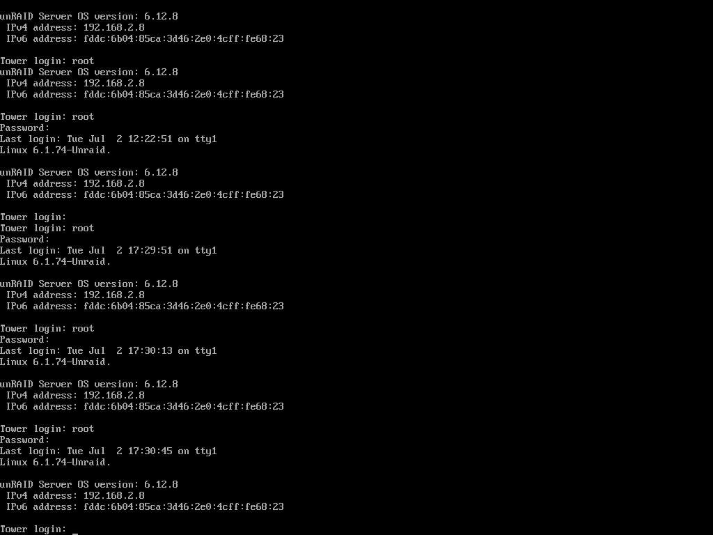

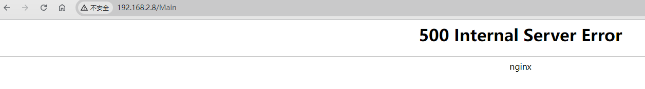

  2. Suddenly,the web ui page shows 500 internal server error , but all the docker service and VMs running normally. Use console to login, it will return to type login user erverytime . How can i solve the issue , I'm worried about losing data after restarting。
