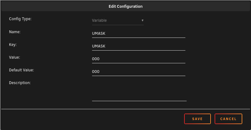

If you read my posts a bit farther back, the only real change I've made was after I had some trouble with file permissions so I added UMASK. To do this, I added a variable to the template: Name/Key: UMASK Value: 000 I can't think of anything significant off the top of my head that I changed in A1111's settings. I've been using Forge and had to switch to standard A1111 due to a Forge bug that's there at the moment so my settings are basically at the defaults other than some cosmetic things. You could try disabling all your custom extensions but this one. Then enable your other extensions on-by-one until you find where it breaks. I've heard of people having trouble with conflicting extensions before. If not that, then maybe stop A1111 and temporarily move: config.json ui-config.json somewhere safe and start it up again so it recreates a default config. One thing I noticed was that it worked in the ComfyUI tab just fine with 'realvisxlV40_v40LightningBakedvae.safetensors' but it errored out when I tried to generate anything with that model in the txt2img tab. It would only work with a full SDXL model. For me, using standard SDXL is taking way too long when I've been used to turbo and lightning models for a while now. So I've had to disable this extension just to be able to use them. The point of me saying all of this is - maybe if you have a turbo or lightning model loaded then that alone could cause you problems.

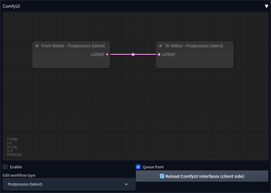

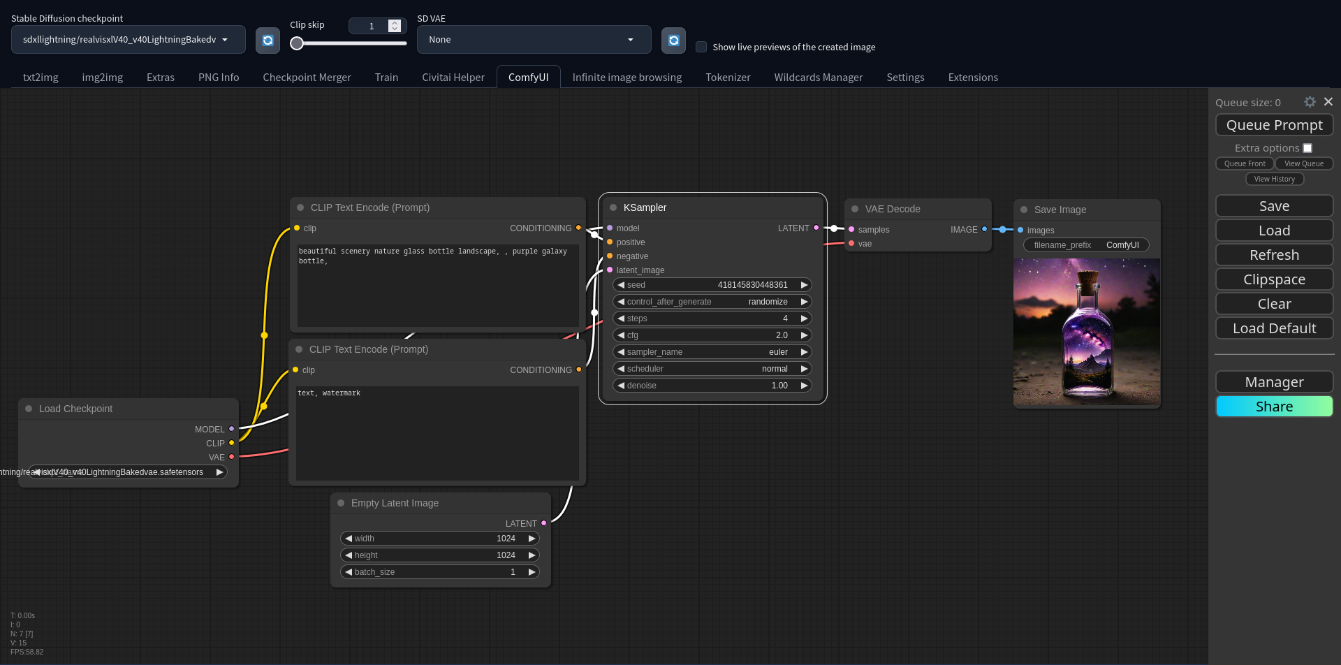

Actually, yes. I didn't even know this extension was available or even possible, so cheers for the heads up. I've installed it and first thing is that it tells you to reload the UI. This isn't enough - a full stop and start of the container makes it work. Presumably you've done that, though. My log: ################################################################ Launching launch.py... ################################################################ glibc version is 2.35 Check TCMalloc: libtcmalloc_minimal.so.4 libtcmalloc_minimal.so.4 is linked with libc.so,execute LD_PRELOAD=/usr/lib/x86_64-linux-gnu/libtcmalloc_minimal.so.4 Python 3.11.8 | packaged by conda-forge | (main, Feb 16 2024, 20:53:32) [GCC 12.3.0] Version: v1.8.0 Commit hash: bef51aed032c0aaa5cfd80445bc4cf0d85b408b5 CUDA 12.1 Launching Web UI with arguments: --listen --port 9000 --enable-insecure-extension-access --medvram --xformers --api Civitai Helper: Get Custom Model Folder 20:02:49 - ReActor - STATUS - Running v0.7.0-b7 on Device: CUDA Loading weights [d6a48d3e20] from /config/02-sd-webui/webui/models/Stable-diffusion/sdxllightning/realvisxlV40_v40LightningBakedvae.safetensors Creating model from config: /config/02-sd-webui/webui/repositories/generative-models/configs/inference/sd_xl_base.yaml Civitai Helper: Set Proxy: Running on local URL: http://0.0.0.0:9000 To create a public link, set `share=True` in `launch()`. [sd-webui-comfyui] Started callback listeners for process webui [sd-webui-comfyui] Starting subprocess for comfyui... [sd-webui-comfyui] Created a reverse proxy route to ComfyUI: /sd-webui-comfyui/comfyui Startup time: 59.9s (prepare environment: 16.8s, import torch: 20.4s, import gradio: 2.8s, setup paths: 7.2s, initialize shared: 0.3s, other imports: 1.7s, list SD models: 0.2s, load scripts: 6.5s, create ui: 3.1s, gradio launch: 0.2s, add APIs: 0.4s). Applying attention optimization: xformers... done. Model loaded in 4.9s (load weights from disk: 0.2s, create model: 0.6s, apply weights to model: 3.5s, calculate empty prompt: 0.3s). [ComfyUI] [sd-webui-comfyui] Setting up IPC... [ComfyUI] [sd-webui-comfyui] Using inter-process communication strategy: File system [ComfyUI] [sd-webui-comfyui] Started callback listeners for process comfyui [ComfyUI] [sd-webui-comfyui] Patching ComfyUI... [ComfyUI] [sd-webui-comfyui] Launching ComfyUI with arguments: --listen 127.0.0.1 --port 8189 [ComfyUI] ** ComfyUI startup time: 2024-03-20 20:03:11.148687 [ComfyUI] ** Platform: Linux [ComfyUI] ** Python version: 3.11.8 | packaged by conda-forge | (main, Feb 16 2024, 20:53:32) [GCC 12.3.0] [ComfyUI] ** Python executable: /config/02-sd-webui/conda-env/bin/python3 [ComfyUI] ** Log path: /config/02-sd-webui/webui/extensions/sd-webui-comfyui/ComfyUI/comfyui.log [ComfyUI] ### Loading: ComfyUI-Manager (V2.10.2) [ComfyUI] ### ComfyUI Revision: 2077 [4b9005e9] | Released on '2024-03-20' [ComfyUI] [ComfyUI-Manager] default cache updated: https://raw.githubusercontent.com/ltdrdata/ComfyUI-Manager/main/custom-node-list.json [ComfyUI] [ComfyUI-Manager] default cache updated: https://raw.githubusercontent.com/ltdrdata/ComfyUI-Manager/main/alter-list.json [ComfyUI] [ComfyUI-Manager] default cache updated: https://raw.githubusercontent.com/ltdrdata/ComfyUI-Manager/main/model-list.json [ComfyUI] [ComfyUI-Manager] default cache updated: https://raw.githubusercontent.com/ltdrdata/ComfyUI-Manager/main/extension-node-map.json [ComfyUI] FETCH DATA from: /config/02-sd-webui/webui/extensions/sd-webui-comfyui/ComfyUI/custom_nodes/ComfyUI-Manager/extension-node-map.json [ComfyUI] FETCH DATA from: /config/02-sd-webui/webui/extensions/sd-webui-comfyui/ComfyUI/custom_nodes/ComfyUI-Manager/extension-node-map.json [ComfyUI] FETCH DATA from: /config/02-sd-webui/webui/extensions/sd-webui-comfyui/ComfyUI/custom_nodes/ComfyUI-Manager/extension-node-map.json [ComfyUI] FETCH DATA from: /config/02-sd-webui/webui/extensions/sd-webui-comfyui/ComfyUI/custom_nodes/ComfyUI-Manager/extension-node-map.json [ComfyUI] FETCH DATA from: /config/02-sd-webui/webui/extensions/sd-webui-comfyui/ComfyUI/custom_nodes/ComfyUI-Manager/extension-node-map.json [ComfyUI] FETCH DATA from: /config/02-sd-webui/webui/extensions/sd-webui-comfyui/ComfyUI/custom_nodes/ComfyUI-Manager/extension-node-map.json [ComfyUI] FETCH DATA from: /config/02-sd-webui/webui/extensions/sd-webui-comfyui/ComfyUI/custom_nodes/ComfyUI-Manager/extension-node-map.json [ComfyUI] FETCH DATA from: /config/02-sd-webui/webui/extensions/sd-webui-comfyui/ComfyUI/custom_nodes/ComfyUI-Manager/extension-node-map.json [ComfyUI] FETCH DATA from: /config/02-sd-webui/webui/extensions/sd-webui-comfyui/ComfyUI/custom_nodes/ComfyUI-Manager/extension-node-map.json [ComfyUI] registered ws - sandbox_tab - 7fdd974d65054604850394a243948462 [ComfyUI] registered ws - preprocess_latent_img2img - fff2e5a47a004d34a784737b769602da [ComfyUI] registered ws - postprocess_latent_txt2img - 57d1208bf4254d4eb7a75f53330c7a8c [ComfyUI] registered ws - postprocess_img2img - 95e9cc98ce84468e942c503f0bb45829 [ComfyUI] registered ws - preprocess_img2img - 48382e9789424d21ac3e6da647c14cc1 [ComfyUI] registered ws - postprocess_latent_img2img - 0262e3f624aa4c35ae54783f2e19ac7b [ComfyUI] registered ws - before_save_image_txt2img - 2fe9c48759004cd7a7d68faec7fd8de2 [ComfyUI] FETCH DATA from: /config/02-sd-webui/webui/extensions/sd-webui-comfyui/ComfyUI/custom_nodes/ComfyUI-Manager/extension-node-map.json [ComfyUI] FETCH DATA from: /config/02-sd-webui/webui/extensions/sd-webui-comfyui/ComfyUI/custom_nodes/ComfyUI-Manager/extension-node-map.json [ComfyUI] registered ws - postprocess_txt2img - 8074d5435f164a26ad0fb02317be8a8a [ComfyUI] registered ws - before_save_image_img2img - 11f4a5b8fb2e4dbaaac9f154a7cd3ccb [ComfyUI] registered ws - postprocess_image_img2img - 34002d2f69d94cb9a459ddc77987b38c [ComfyUI] registered ws - postprocess_image_txt2img - 2e0a84b53e034bb18eda0e806f6d4ecc [ComfyUI] FETCH DATA from: /config/02-sd-webui/webui/extensions/sd-webui-comfyui/ComfyUI/custom_nodes/ComfyUI-Manager/.cache/1514988643_custom-node-list.json [ComfyUI] FETCH DATA from: /config/02-sd-webui/webui/extensions/sd-webui-comfyui/ComfyUI/custom_nodes/ComfyUI-Manager/.cache/1742899825_extension-node-map.json [ComfyUI] FETCH DATA from: /config/02-sd-webui/webui/extensions/sd-webui-comfyui/ComfyUI/custom_nodes/ComfyUI-Manager/.cache/1742899825_extension-node-map.json Then I get: I've only had a few minutes of testing it. Generating from the ComfyUI tab is working fine. As you can see, I've changed the checkpoint, resolution and CGF/steps. However, generating from the txt2img tab results in: RuntimeError: Expected all tensors to be on the same device, but found at least two devices, cpu and cuda:0! (when checking argument for argument index in method wrapper_CUDA__index_select) So I'm going to have to figure that one out.
