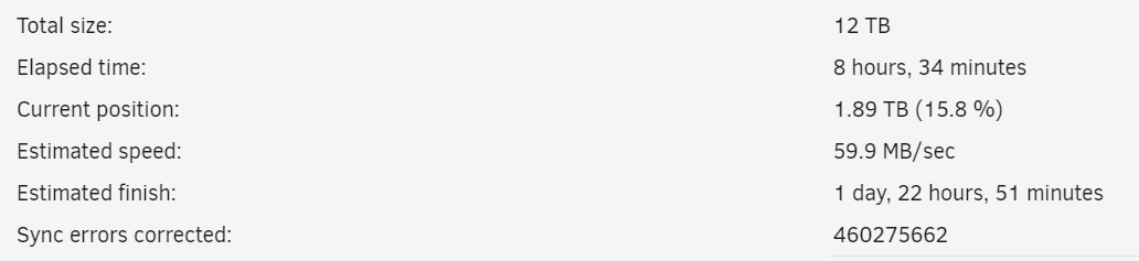

Yeah I used the script... The script finished like like 10 minutes. So youre saying that the script did nothing haha. Understood. And yes the drive is removed and parity check is running/fixing. so everything should be good when it finishes

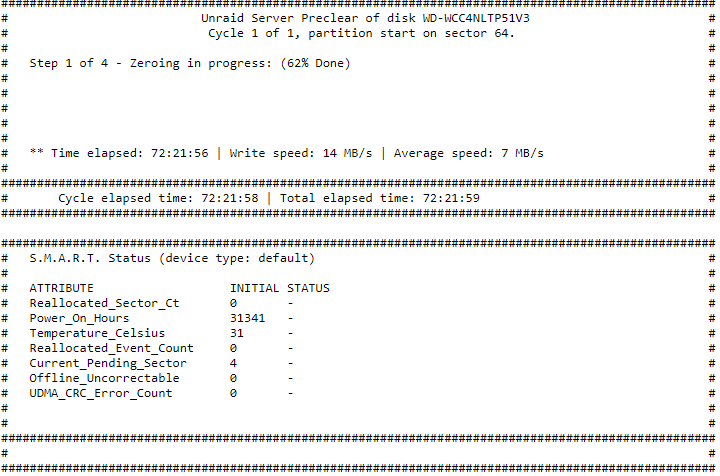

I used krusader and the built in file manager (found that this froze a few times). Everything was clear off the drive (it was 3tb) But it took maybe 24hours. The drive in question had pending sectors and it was my slowest WD Green 5400 drive so I wanted to take it out anyway. So I removed it and I'm currently doing a preclear on it rn but it is running SO SLOW. screenshot below. I figure Im just going to remove it completely and us it for an extra- extra redundancy for pics/home vids.

I thought I did - I followed all the steps on the walkthrough and spaceinvaderone's video (which are the same steps). This is my monthly parity check. I didnt run it manually after I shrunk my array.

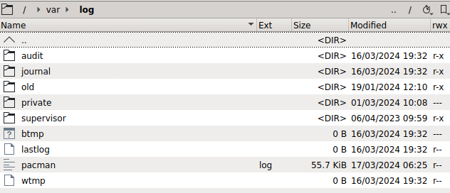

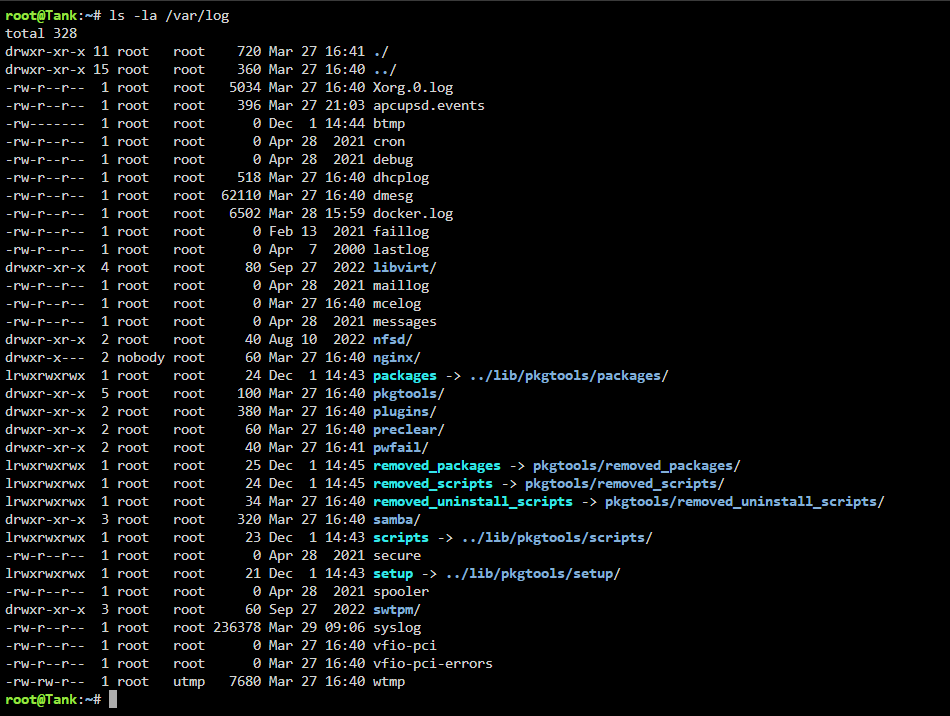

root@Tank:~# cat /var/log/Xorg.0.log [ 49.385] X.Org X Server 1.21.1.7 X Protocol Version 11, Revision 0 [ 49.385] Current Operating System: Linux Tank 6.1.64-Unraid #1 SMP PREEMPT_DYNAMIC Wed Nov 29 12:48:16 PST 2023 x86_64 [ 49.385] Kernel command line: BOOT_IMAGE=/bzimage initrd=/bzroot,/bzroot-gui [ 49.385] [ 49.385] Current version of pixman: 0.42.2 [ 49.385] Before reporting problems, check http://wiki.x.org to make sure that you have the latest version. [ 49.385] Markers: (--) probed, (**) from config file, (==) default setting, (++) from command line, (!!) notice, (II) informational, (WW) warning, (EE) error, (NI) not implemented, (??) unknown. [ 49.385] (==) Log file: "/var/log/Xorg.0.log", Time: Wed Mar 27 16:40:48 2024 [ 49.387] (==) Using system config directory "/usr/share/X11/xorg.conf.d" [ 49.397] (==) No Layout section. Using the first Screen section. [ 49.397] (==) No screen section available. Using defaults. [ 49.397] (**) |-->Screen "Default Screen Section" (0) [ 49.397] (**) | |-->Monitor "<default monitor>" [ 49.397] (==) No monitor specified for screen "Default Screen Section". Using a default monitor configuration. [ 49.397] (==) Automatically adding devices [ 49.397] (==) Automatically enabling devices [ 49.397] (==) Automatically adding GPU devices [ 49.397] (==) Automatically binding GPU devices [ 49.397] (==) Max clients allowed: 256, resource mask: 0x1fffff [ 49.397] (++) FontPath set to: /usr/share/fonts/TTF [ 49.397] (==) ModulePath set to "/usr/lib64/xorg/modules" [ 49.397] (II) The server relies on udev to provide the list of input devices. If no devices become available, reconfigure udev or disable AutoAddDevices. [ 49.397] (II) Loader magic: 0x62dd40 [ 49.397] (II) Module ABI versions: [ 49.397] X.Org ANSI C Emulation: 0.4 [ 49.397] X.Org Video Driver: 25.2 [ 49.397] X.Org XInput driver : 24.4 [ 49.397] X.Org Server Extension : 10.0 [ 49.401] (--) PCI:*(2@0:0:0) 10de:0659:10de:063a rev 161, Mem @ 0xfa000000/16777216, 0xa0000000/536870912, 0xf8000000/33554432, I/O @ 0x0000e000/128, BIOS @ 0x????????/131072 [ 49.401] (II) Open ACPI successful (/var/run/acpid.socket) [ 49.401] (II) LoadModule: "glx" [ 49.402] (II) Loading /usr/lib64/xorg/modules/extensions/libglx.so [ 49.413] (II) Module glx: vendor="X.Org Foundation" [ 49.413] compiled for 1.21.1.7, module version = 1.0.0 [ 49.413] ABI class: X.Org Server Extension, version 10.0 [ 49.539] (==) Matched nouveau as autoconfigured driver 0 [ 49.539] (==) Matched nv as autoconfigured driver 1 [ 49.539] (==) Matched modesetting as autoconfigured driver 2 [ 49.539] (==) Matched fbdev as autoconfigured driver 3 [ 49.539] (==) Matched vesa as autoconfigured driver 4 [ 49.539] (==) Assigned the driver to the xf86ConfigLayout [ 49.539] (II) LoadModule: "nouveau" [ 49.539] (WW) Warning, couldn't open module nouveau [ 49.539] (EE) Failed to load module "nouveau" (module does not exist, 0) [ 49.539] (II) LoadModule: "nv" [ 49.540] (WW) Warning, couldn't open module nv [ 49.540] (EE) Failed to load module "nv" (module does not exist, 0) [ 49.540] (II) LoadModule: "modesetting" [ 49.540] (II) Loading /usr/lib64/xorg/modules/drivers/modesetting_drv.so [ 49.546] (II) Module modesetting: vendor="X.Org Foundation" [ 49.546] compiled for 1.21.1.7, module version = 1.21.1 [ 49.546] Module class: X.Org Video Driver [ 49.546] ABI class: X.Org Video Driver, version 25.2 [ 49.546] (II) LoadModule: "fbdev" [ 49.547] (WW) Warning, couldn't open module fbdev [ 49.547] (EE) Failed to load module "fbdev" (module does not exist, 0) [ 49.547] (II) LoadModule: "vesa" [ 49.547] (II) Loading /usr/lib64/xorg/modules/drivers/vesa_drv.so [ 49.550] (II) Module vesa: vendor="X.Org Foundation" [ 49.550] compiled for 1.21.1.4, module version = 2.6.0 [ 49.550] Module class: X.Org Video Driver [ 49.550] ABI class: X.Org Video Driver, version 25.2 [ 49.550] (II) modesetting: Driver for Modesetting Kernel Drivers: kms [ 49.550] (II) VESA: driver for VESA chipsets: vesa [ 49.550] (++) using VT number 7 [ 49.552] (EE) open /dev/dri/card0: No such file or directory [ 49.552] (WW) Falling back to old probe method for modesetting [ 49.552] (EE) open /dev/dri/card0: No such file or directory [ 49.553] vesa: Refusing to run, Framebuffer or dri device present [ 49.553] (EE) Screen 0 deleted because of no matching config section. [ 49.553] (II) UnloadModule: "modesetting" [ 49.553] (EE) Device(s) detected, but none match those in the config file. [ 49.553] (EE) Fatal server error: [ 49.553] (EE) no screens found(EE) [ 49.553] (EE) Please consult the The X.Org Foundation support at http://wiki.x.org for help. [ 49.553] (EE) Please also check the log file at "/var/log/Xorg.0.log" for additional information. [ 49.553] (EE) [ 49.555] (EE) Server terminated with error (1). Closing log file. root@Tank:~#- Cant find drives & cant see gui on monitor....
