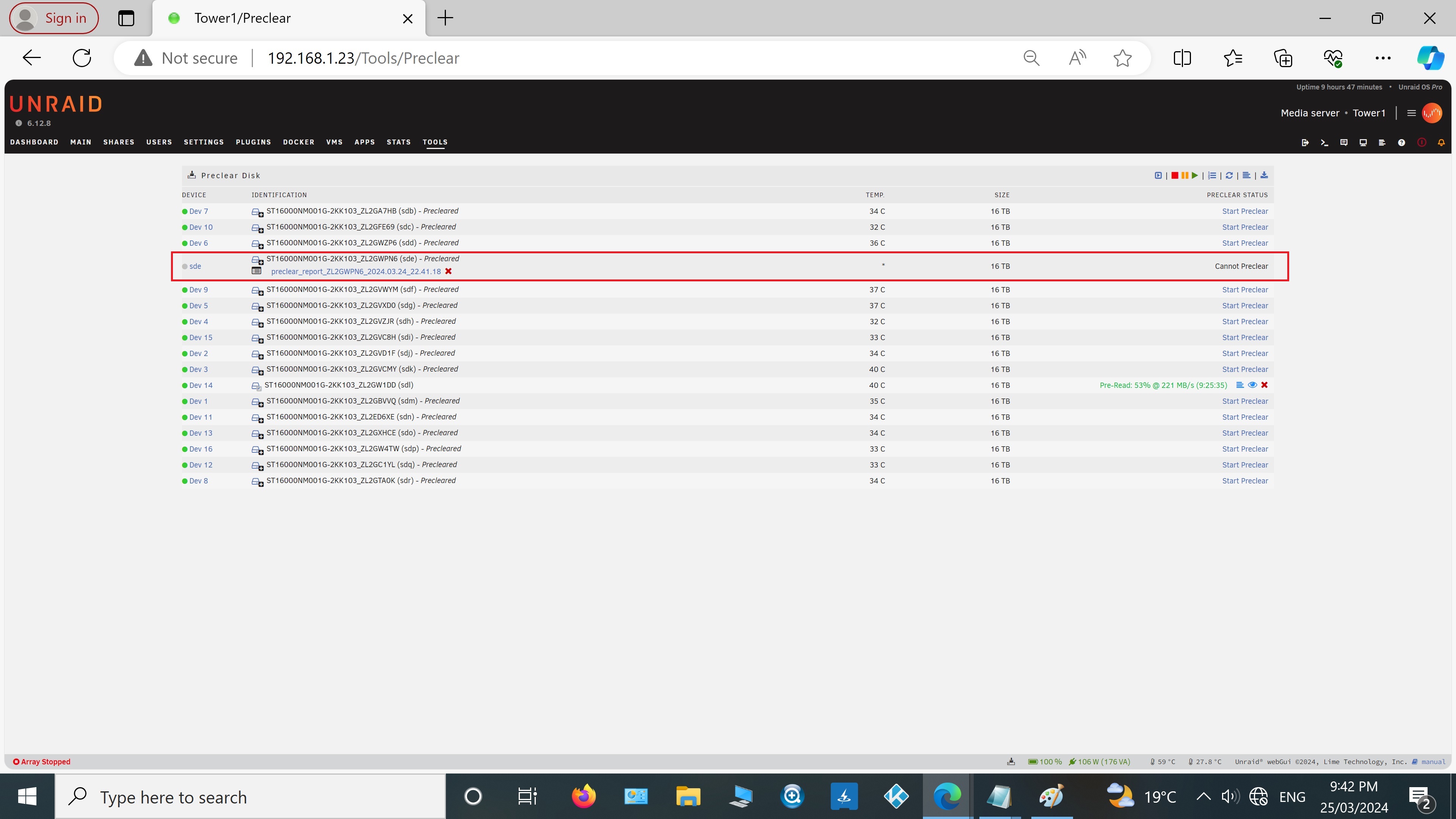

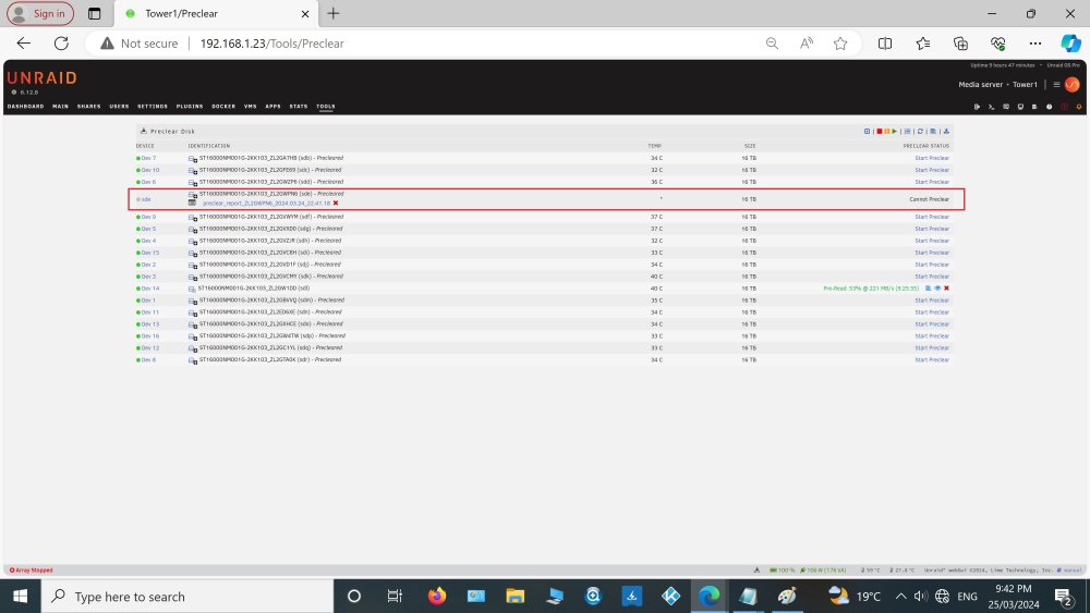

  3. Preclear almost complete. Have noticed on of the drives in the Tools-> Preclear screen shows one of the drives cannot be precleared (attachment Tools-Preclear.jpg), however the preclear report (attachment preclear_report_ZL2GWPN6.txt) stated the preclear operation was successful. Can I use this drive? Do I need to do another preclear? Thanks for your help preclear_report_ZL2GWPN6.txt
