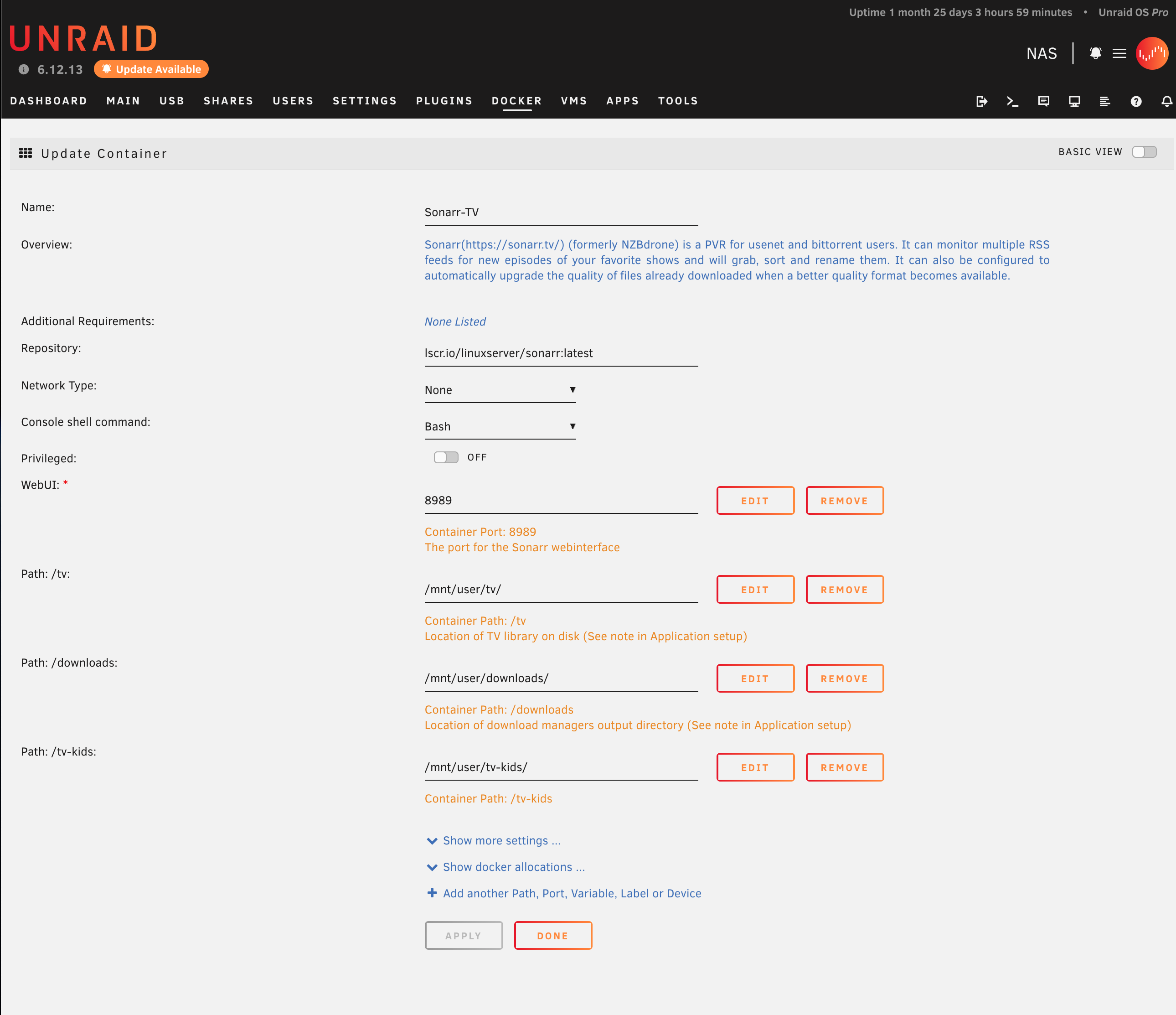

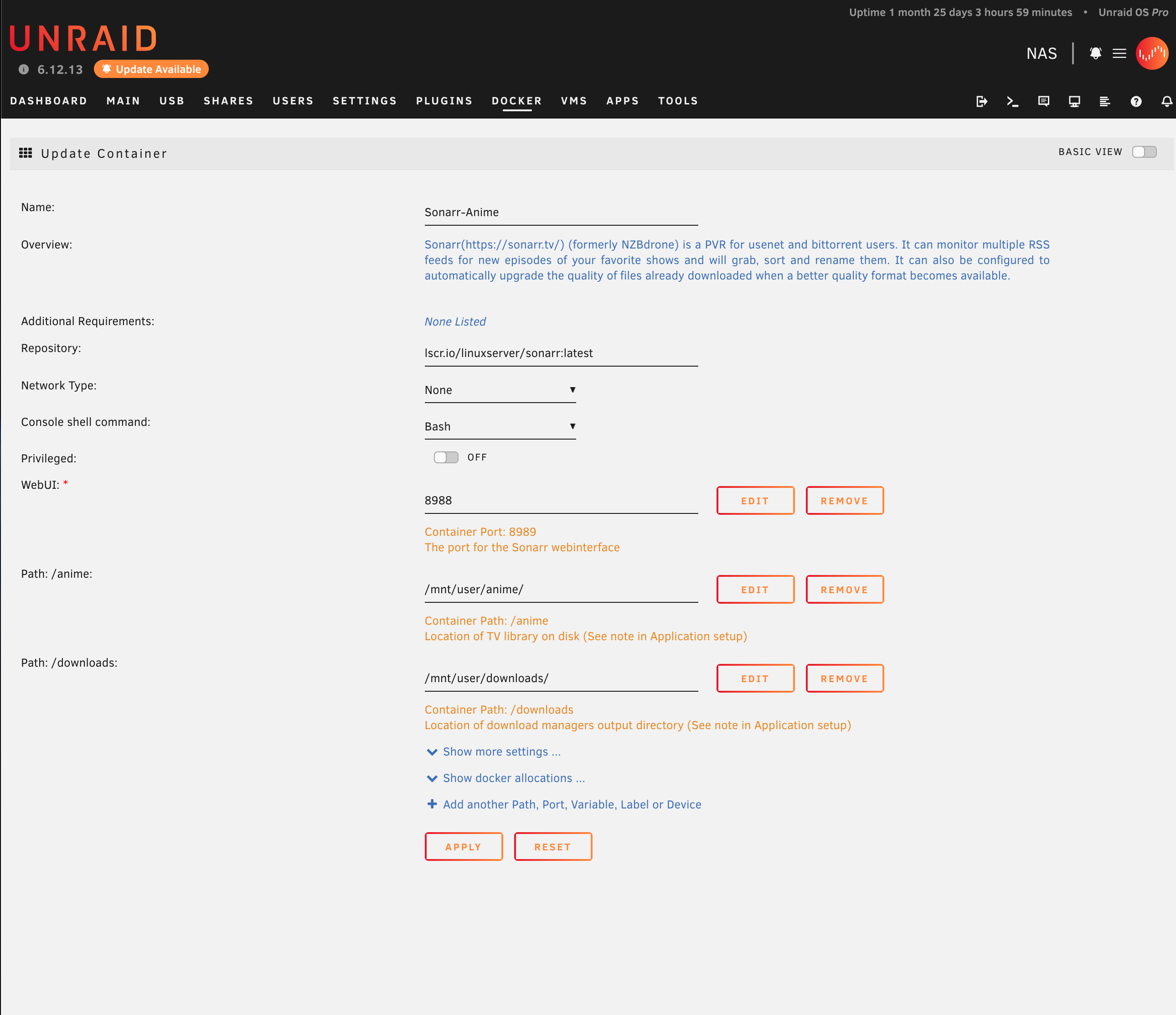

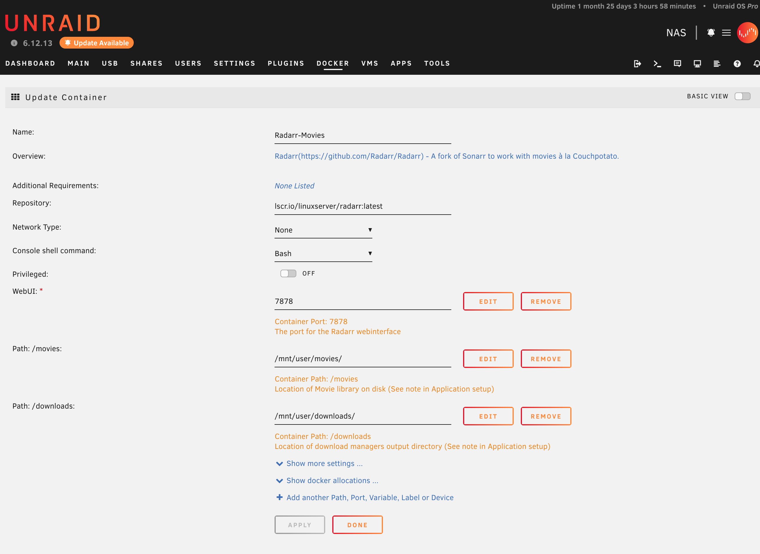

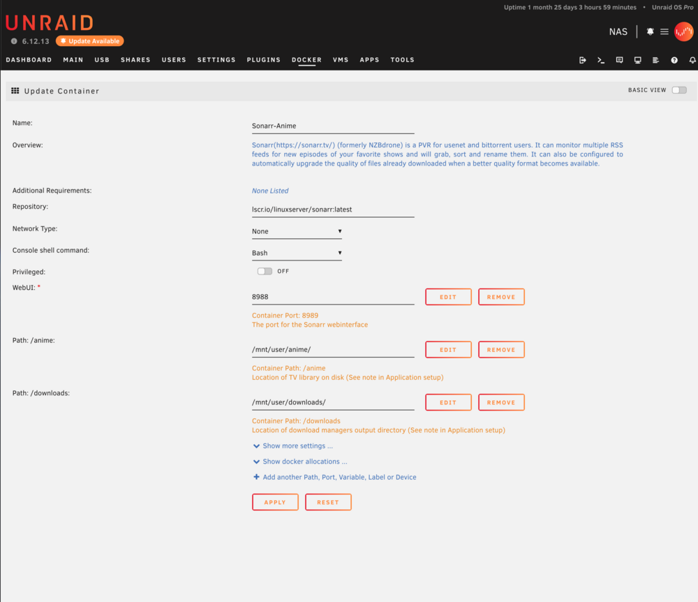

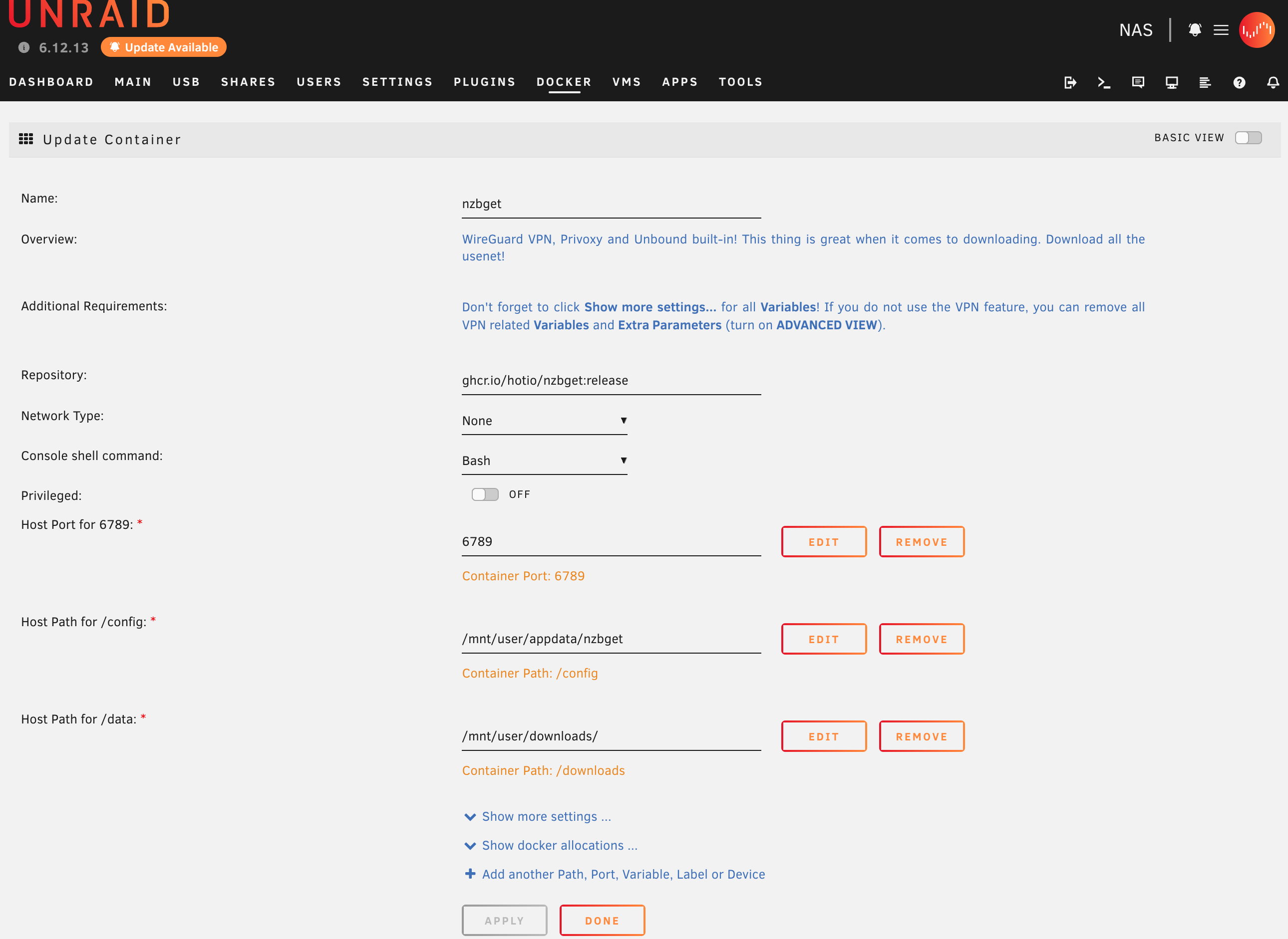

  3. I am trying to organize my media so that certain files are on certain drives. For example: Movies: Disk 1 TV: Disk 2, Disk 3 Anime: Disk 4 Music: Disk 5 Misc files (downloads): Disk 6 However, I am finding that when I acquire new media, it tends to stay on the drive where it was initially downloaded which is causing the download disk to get full before everything else. I am currently using Unbalanced to migrate the files to the correct disk when it becomes an issue, but is a slow and manual process; something I am trying to understand how to avoid going forward. I am using nzbget as my downloader and my completed downloads directory is on drive 6. I believe the reason for this is because bullet point #2 in the behavior outlined in this post: My question is: How can I configure my server to automatically put the files on the correct disks so that manual intervention via unbalanced isn't necessary? I have checked my nzbget and *arr settings and haven't seen any options to set a per category 'incomplete' InterDir directory for storing the download parts. My research has shown that as long as the InterDir is specified, nzbget unzips of these files within the 'incomplete' InterDir directory and them moves (mv) them to completed DestDir directory specified via the category. Additionally, I haven't seen any settings for these applications to copy then delete the files out of the downloads directory. Am I missing these critical settings? Or do I need to re-evaluate how I am storing my data? Curious if anyone has gotten a setup similar to this working. Any guidance would be very much appreciated. Edit: Grammar, spelling, & additional context.
