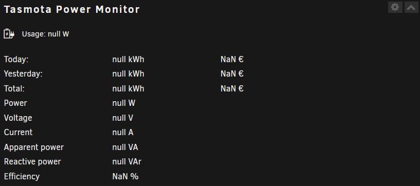

  5. I have 2 Smart Plugs lying around here, 1 Tasmota and 1 OpenBeken flashed on. Here are the outputs if put http://IP_OF_YOUR_DEVICE/cm?cmnd=Status%208 in the browser: OpenBeken: { "StatusSNS": { "Time": "2024-07-19T14:33:13", "ENERGY": { "Power": 12.699999, "ApparentPower": 12607.089843, "ReactivePower": 12607.083984, "Factor": 0.001007, "Voltage": 233.464630, "Current": 54.000000, "ConsumptionTotal": 483.106109, "Yesterday": 482.320281, "ConsumptionLastHour": 0.004588 } } } Tasmota: { "StatusSNS": { "Time": "2024-07-19T15:32:08", "ENERGY": { "TotalStartTime": "2024-07-19T14:34:49", "Total": 0.001, "Yesterday": 0.000, "Today": 0.001, "Power": 13, "ApparentPower": 13, "ReactivePower": 0, "Factor": 1.00, "Voltage": 233, "Current": 0.054 } } } As you can see some values are not matching. For me the OpenBeken Plug does not work at all with this Unraid Plugin... But the Tasmota Plug is working 😃
