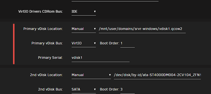

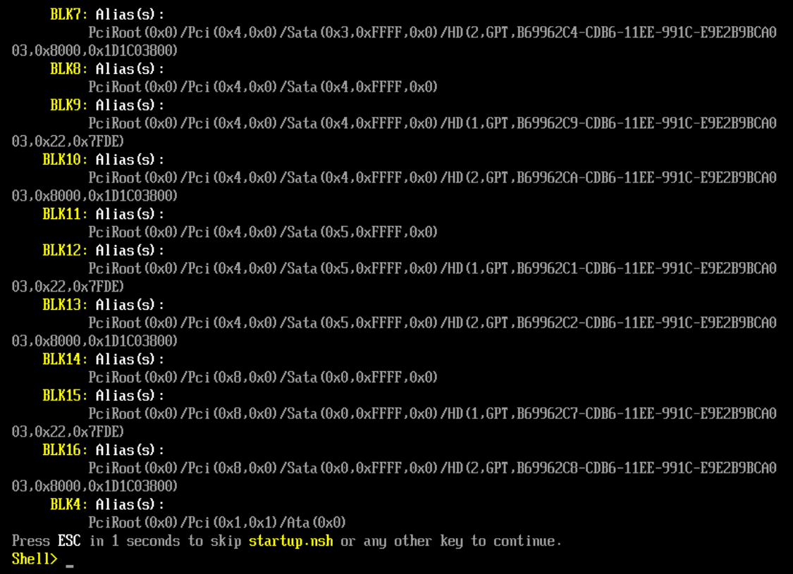

  7. I have the same problem and would like also a solution. The goal is to convert my vDisks to qcow2 so I could do a snapshot with virsh. I took a Windows VM vDisk "vdisk1.img" with format raw and executed the following from "/mnt/user/domains/srvr-windows" while the VM was running as a proof of concept. qemu-img convert -f raw -O qcow2 vdisk1.img vdisk1.qcow2 The img file have 50GB and the QCow2 have 17GB but I suspect this is caused by differences in how they store zeroes. I then stopped the VM, changed the primary vdisk location to /mnt/user/domains/[vm-name]/vdisk1.qcow2 and kept the vDisk bus to VirtIo. Following that, I start the machine and I have the following (see attached 'boot error.png'). Note that I have also 4 disks passed through from the host to this VM. I then tried all other vDisk bus except IDE and USB without any change on the result. Do someone have any informations for us?
