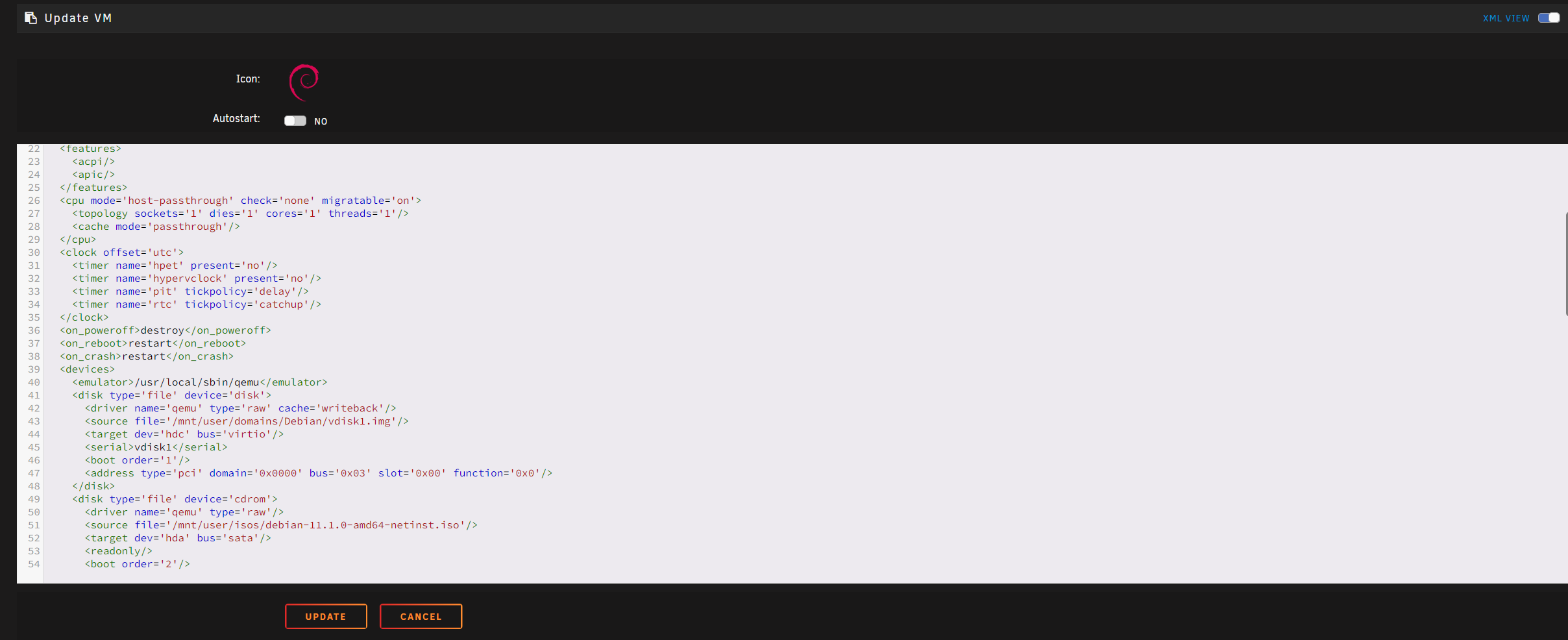

I then stopped the VM, changed the primary vdisk location to /mnt/user/domains/[vm-name]/vdisk1.qcow2 and kept the vDisk bus to VirtIo.
Following that, I start the machine and I have the following (see attached 'boot error.png').  Note that I have also 4 disks passed through from the host to this VM.  I then tried all other vDisk bus except IDE and USB without any change on the result.
Do someone have any informations for us?
Make sure the type is set as qcow2, edit the xml if needed since the choice currently disappears when selecting manual.
Edited by Kilrah
Thanks for the fast reply.  There is no type field on the Gui.  I understand I should manually put it on the VM xml file.  I will try your suggestion later and keep this post informed.
I couldn't wait...  I stopped the VM, went to '/etc/libvirt/qemu' and edited the srvr-windows.xml file.  I changed the drvier type 'raw' for 'qcow2' here :
      <driver name='qemu' type='qcow2' cache='writeback'/>
      <source file='/mnt/user/domains/srvr-windows/vdisk1.qcow2'/>

I forgot to update this when I found the solution for me. It was simply to change the disk type.
But I have been having problems running VMs. I have to look further into these settings that I had no clue you had/could change.
I also very much recommend Virt-Manager. I have still to dive into it, but it looks powerful and easy to use (I hate to use CLI, and script edits).
4 hours ago, sbeaudoin said:
virsh define /etc/libvirt/qemu/[machine name].xml
Can do the update via the XML view. Change the file name and type then update.
