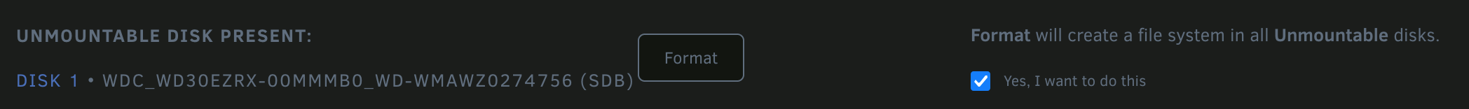

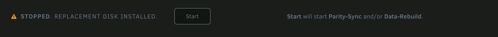

  4. Attached. Data-rebuild has finished and there are a few directories on the disk. rumo-diagnostics-20250527-0918.zip
