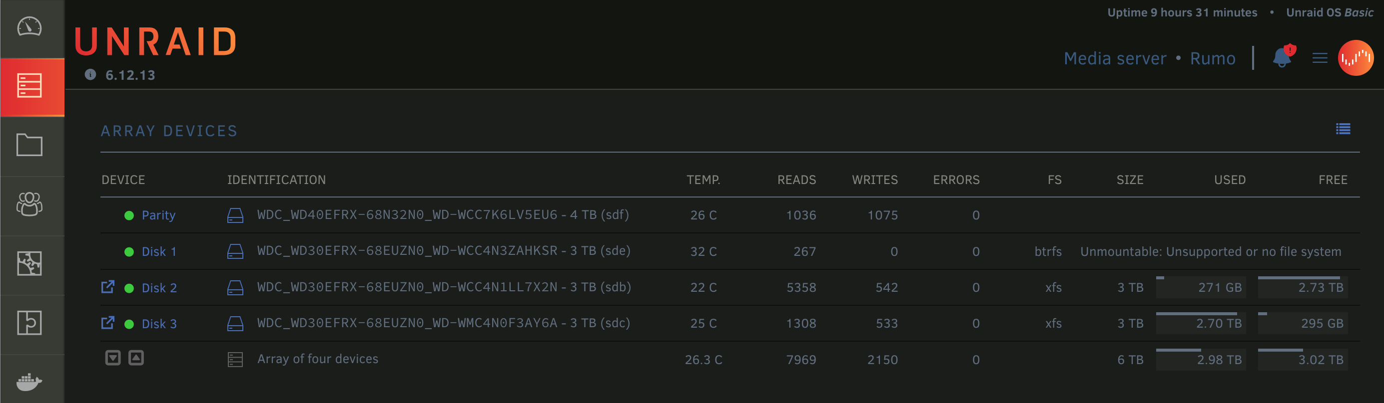

This is what it looked like when the problem arose:
I understand that unraid emulates a missing disk by providing the virtual data calculated from the existing disks, right?
This did not seem to be the case with the unmounted disk. At least no shares or files on this disk were shown under Shares or in the file manager, whereas they showed up in the file manager as soon as I started the array with the replacement disk.
In this state there was write access to Disk 2 and I still do not understand if the virtual data of Disk 1 was corrupted and thus the corrupted data was written to the replacement disk.
You didn't have a missing disk. You had an unmountable disk. So nothing was being emulated.
If you had a missing disk, and the emulated disk were unmountable, then rebuild would have resulted in an unmountable disk..
Looks like rebuilt disk1 is mounted now though. Perhaps the unmountable condition was just due to not being able to accurately read the original disk.
If you had started the array without the original disk, probably it would have shown us that the emulated disk was mountable, since that is the result of the rebuild.
Yes, as you can see in the screenshot, there is no file manager link.
