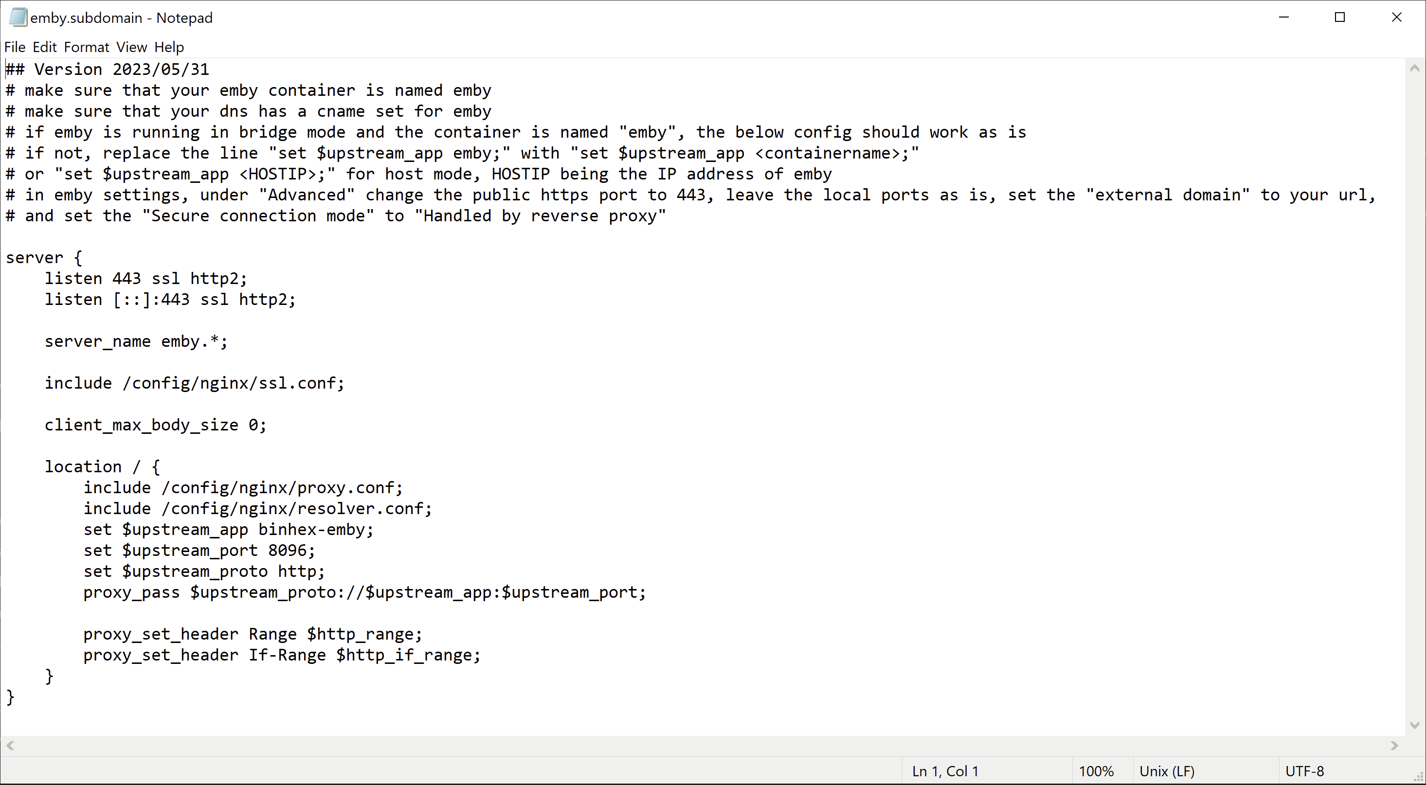

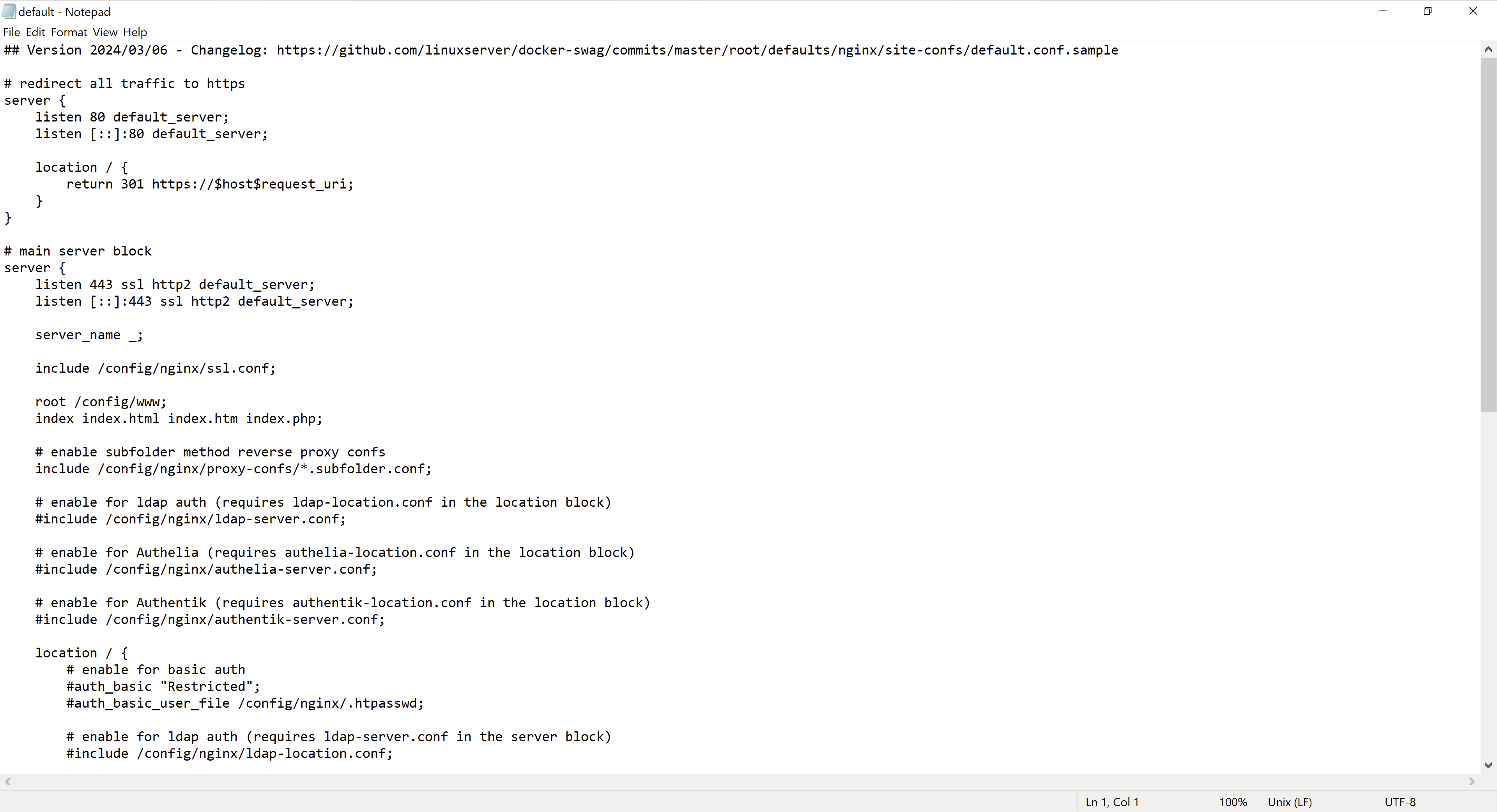

  5. I've attached screenshots of the emby.subdomain.conf and default.conf files below. I've not downloaded the cloudflare ddns app, is it necessary? In my emby dashboard it lists the local LAN as http://<Emby Container IP>:8096 and remote WAN as https://emby.domain.url. I tried both http and https when trying to connect to WAN and both gave the same result of failing to redirect (eg: http://emby.domain.url and https://emby.domain.url both report the webpage failed to redirect properly).
