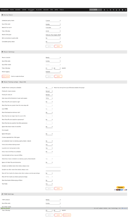

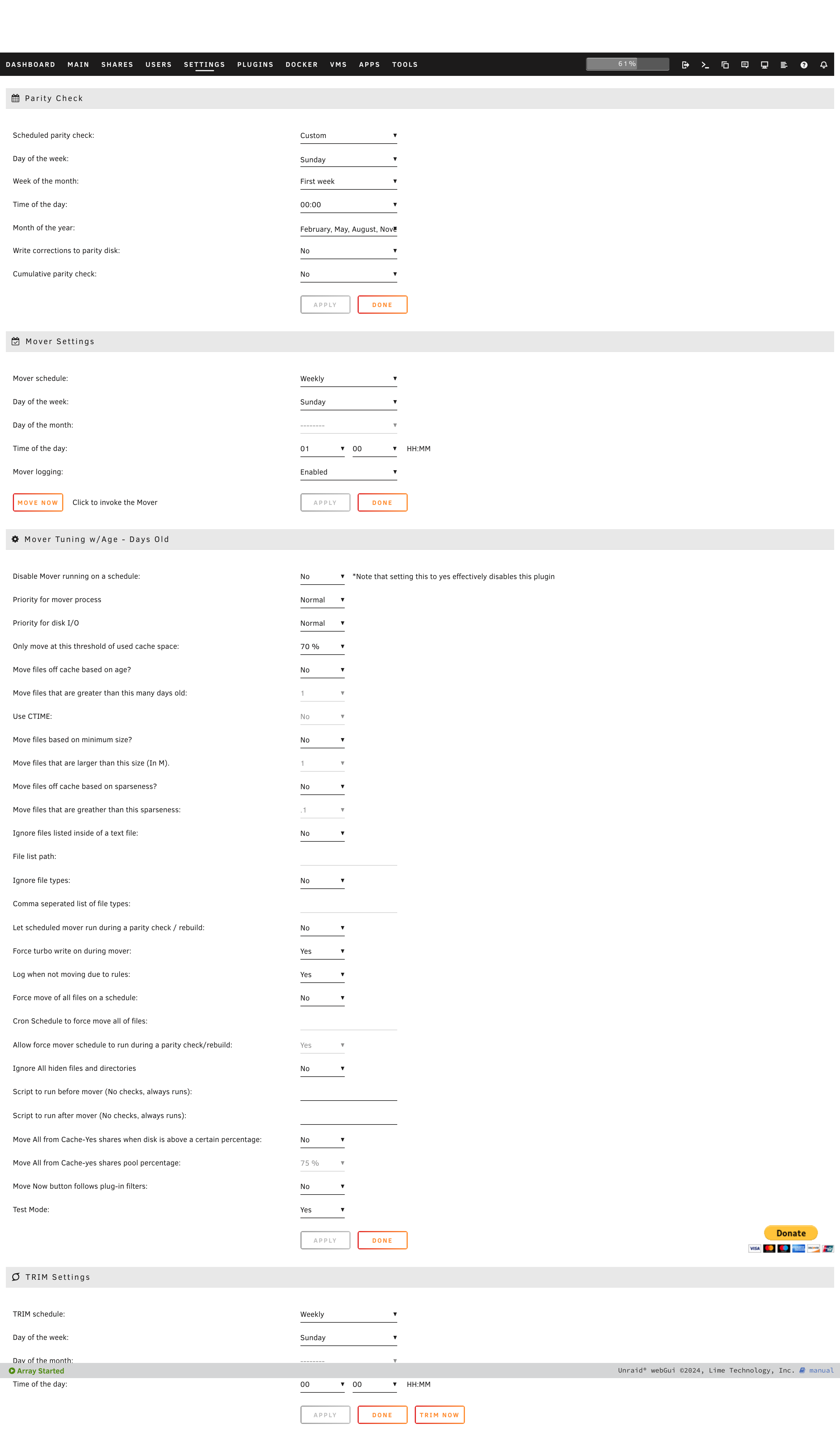

  13. Yes, the list was empty. I had only set it TestMode to "Yes" for a test run, thank you though. TestMode doesn't seem to work though, it just ignores the setting and moves thing like normal.
  14. Ah, so schedule the Mover is what trigger the Mover Tunning plugin to run? I thought the settings were independent of each other. What I had setup would run the Mover when cache got over 70% and it would run on Sunday at 1:00 regardless of capacity. So if I want the Mover to run when it hit 70% I should set the Mover schedule to be like...run every few hours?
  15. Like this:
