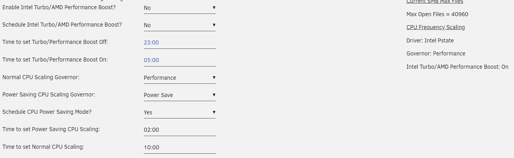

  2. Hey, so I'm new, and this is my first install. Before fully using it I want to make shure my 12700K never enters turbo mode, can't do this in my BIOS, and while I'm at it, if I can make it go into a low power state while I'm at sleep better. I might as well even consider turning it off, I'll see. So I landed is this plug-in. After reading through it I came up with these settings: However I got 2 doubts: 1. This line in the tips section: If during my powersaving schedule I don't care about performance and all I'm looking for is power saving as I wont be using it, is it still ok to set it as I did? 2. From the Normal Governor tooltip Will this still comply with the Intel Turbo configuration I set? Like will that "full frequency" ignore my config and push it to turbo levels? Thanks in advance!
