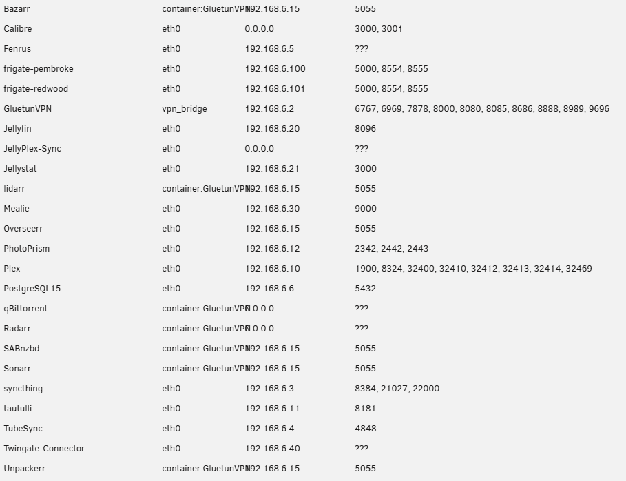

I'm pretty sure it is all docker related...without docker running it will stay up for 24 hours with no errors, with it running a crash is bound to happen. So my docker -ls result is this: NETWORK ID NAME DRIVER SCOPE 990ae97238ca bridge bridge local a3edf9925e01 eth0 macvlan local dd759eb996bd host host local c1b3265776ec none null local 926fdbc61565 vpn_bridge bridge local My Gluetun is assigned the VPN bridge, but none of my other *arr dockers are (which you imply they should be). They are currently bonded to the Gluetun docker using "--net=container:GluetunVPN". The UI for docker allocations does should some weirdness as often the arr dockers will 'report' that they are connected/mapped to another docker's details: They are **ALL** configured the same yet some (e.g. Sonarr) show blank mappings, while others (e.g. qBittorent) show mappings for 192.168.6.15:5055/TCP which actually belongs to another container (Overseerr on eth0). When the system starts, or Gluetun is changed and the containers rebuild, they all come up as blank, but over time many collect a random mapping - normally that of the last container restarted or rebuilt and they always get the same. This same behaviour is reported here, so I think a bug, but not related - though worth noting they too have a similar gluetun setup. As for the log, the 'random' network messages look to be correlated with dockers being turned on and off, or rebuilt....after that it doesn't seem to happen. For example you can see a bunch of this after 00:00 when AppDataBackup runs....I've attached the syslog for you so you can the full log for several days. I don't see it happening before a crash unless it happened to be doing legitimate start/stop activities. The full list of mappings is this: Containers are either running against Gluetun, then Gluetun is on the vpn_bridge, and everything else is set to run like this against the eth0 interface so everything has it's own IP address: I can re-map all the arr dockers to connect to the VPN_Bridge, but then how do I force their traffic out via Gluetun? If they are on the bridge they are free to access the internet without going through the VPN (just like Gluetun itself). Hopefully that sheds a little more light....I don't think the network is complicated necessarily....but something is definitely breaking something somewhere. Otherwise feel free to suggest an alternate arrangements to trial... I have a second hardware platform coming - as soon as the part arrive (over the next week) I will assemble it and then I will have a second machine to test on which might help as I can replicate (more or less) the set up and see if it breaks.... It's expensive but if I price my time trying to get to the bottom of this there's a huge cost there too... Other random things left to try: Move the HBA card to another slot (there are some reports of crashing if in a PCIeX16 slot (I've tried running as X16 and X8/X8 - both crash, but I have a PCIeX4 slot I can try) Remove the HBA and run off SATA and a SATA expansion card (slow but old school) Probably pointless, but again this eliminate other potential sources of error - if the crashing still happens then the slot and HBA are both off the hook as far as guilt. So far though I'm still looking at docker....the longest period of stable operation so far has been with docker not running - so one way or another it has to be there somewhere. syslog-192.168.6.2.log

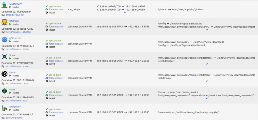

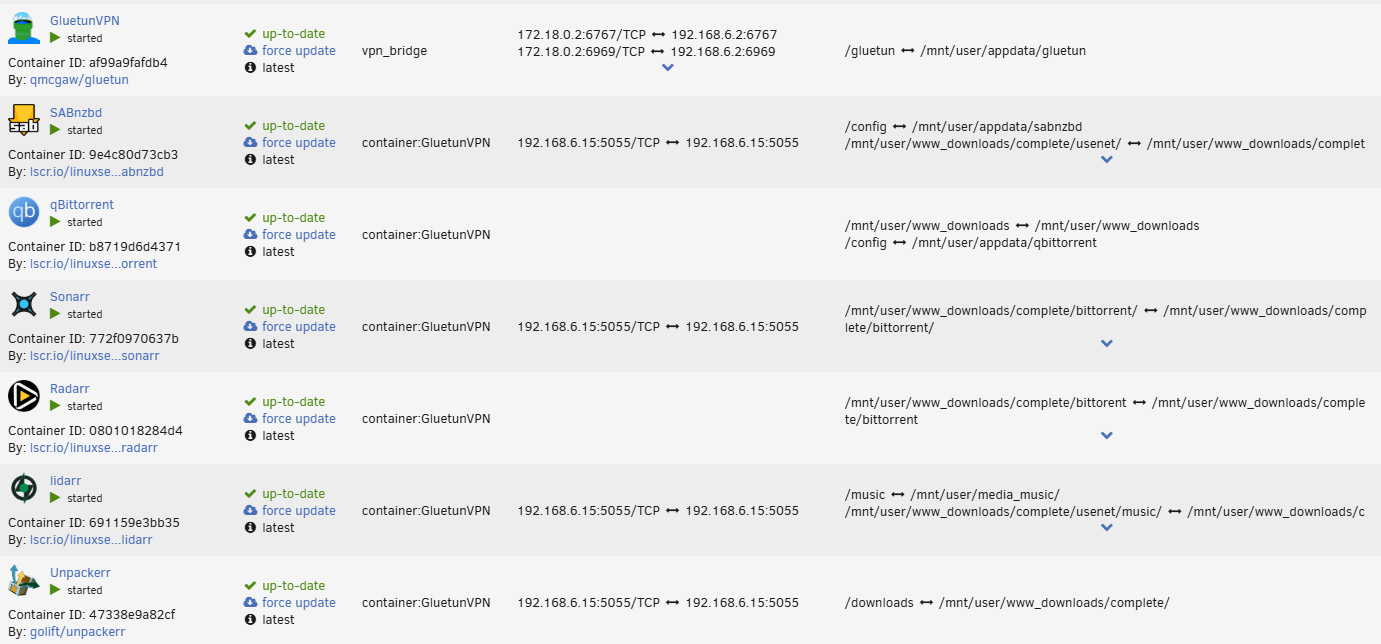

OK. Added the vpn_bridge using the command you provided. Set GluetunVPN to a fixed IP address and made sure everything else can hook into it....so now this is all going. I haven't added the command to allow GluetunVPN access to the local LAN (it doesn't need access) and it still reaches the Internet just fine. Going to reboot now so we come up clean and the parity check will get kicked off again... Fingers crossed. If nothing else it hasn't died yet, so that's positive in that if nothing else we're not worse off! Have to think positive...that way you're less disappointed when it all catches fire again... 🙂
Kernel Bug Error
Hmmmm.....I remember why there needs to be a custom network.....it's because the arr dockers need to talk to each other....sigh.....

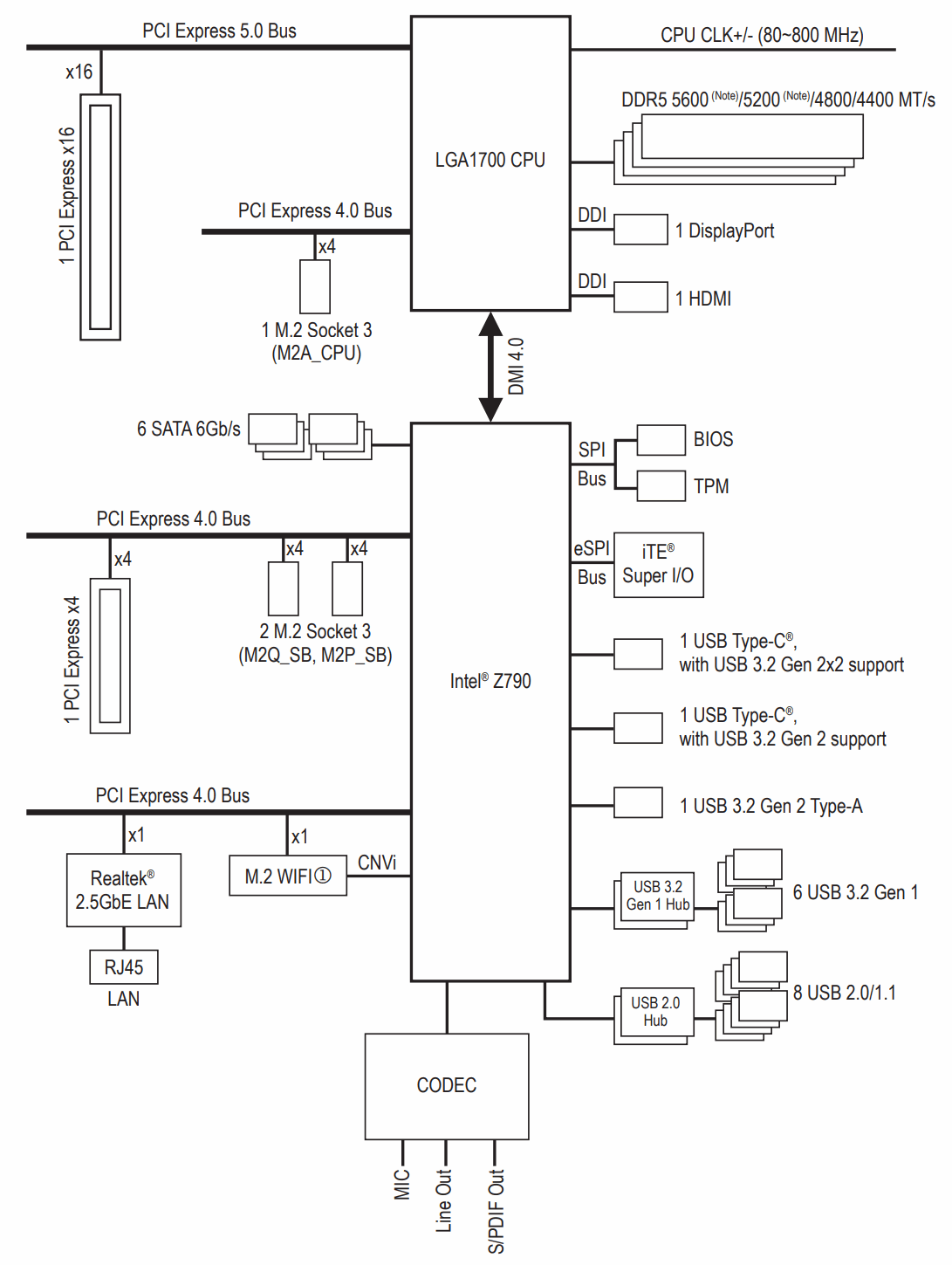

I can't find that exact reference to the total number of lanes, but that doesn't match the block diagram....and there's nothing in the manual about using a M.2 slots and losing the PCIe slot. EDIT: Found the table: Processor PCIe Lane Configuration Support 1x16+1x4 Chipset PCIe Express5 4.0 Lanes6 Up to 20 The 20 PCI Express 4.0 lanes I expect are the x16 + x4 connected to the CPU. The Z790 chipset allows for up to 20 PCI Express 4.0 lanes - that means no contraint. Even if that isn't the case, if everything is populated I don't think we don't get bifurcation (telling a slot that there are multiple devices installed in a single slot), rather we would get lane/bandwidth sharing. This means slower performance when there is congestion....but the chipset should manage that....it hsould generate errors and kernel crashes?
Kernel Bug Error
I haven't moved anything....I only have two slots so there's not much to shuffle in any case 🙂 Anyway......for the first time ever I'm looking at the MB block diagram: On the CPU side I have a HBA in the PCIx16 slot and a M.2 in M2A_CPU. This all seems to be working fine. So no issues there that I know of. The manual does say however: CPU: - 1 x PCI Express x16 slot, supporting PCIe 5.0 and running at x16 (PCIEX16) * The PCIEX16 slot can only support a graphics card or an NVMe SSD. If only one graphics card is to be installed, be sure to install it in the PCIEX16 slot. I'm picking that's a red herring....I don't have an NVME in that slot, nor graphics card. Looking at the Z790 chipset then - a single PCIe slot (x4) and two x4 M.2 slots (both occupied). There are no other slots....so I see no reason why a PCIe x1 NIC can't be put in the slot. There nothing that says for example that I must choose between the third M.2 slot or the PCIe card....and if there is bifurcation of the lanes then it looks like this is already done out of the box between the PCIe and M.2 slots as the default set up... New Intel210 card should be here this time tomorrow....so that will be interesting.
