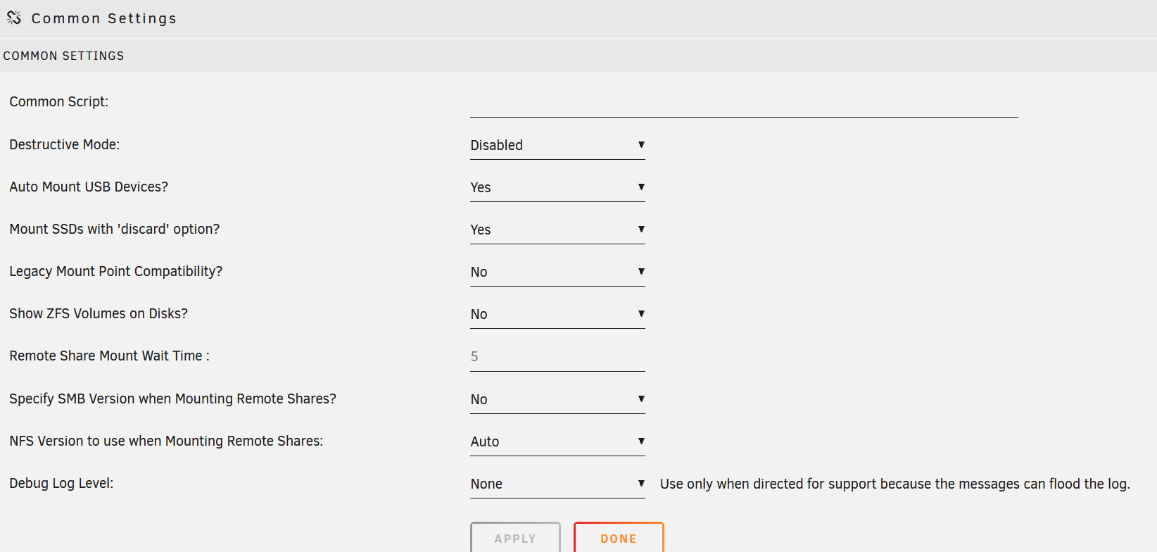

  3. I tried to copy data to an external HDD. Unassigned devices and unassigned devices plus is installed. There is no problem copiing fron the HDD to the Array. I tried it with the file Manager, krusader etc. but the answer is always the same: Invalid target Enter a valid traget. in the file Manager the external HDD adress is: /mnt/disk/externalHDD It just does not work. Any ideas? Sreenshot of Unassigned devices Settings: Thank you for you help. Peter

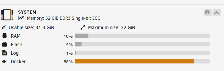

  4. I think, I found the Problem/solution. Since I use directory instead of image, the "docker Image is getting full" refers to the disk the directory is on. so I only have to move some stuff to another disk so the disk is less full. I try this now and report later

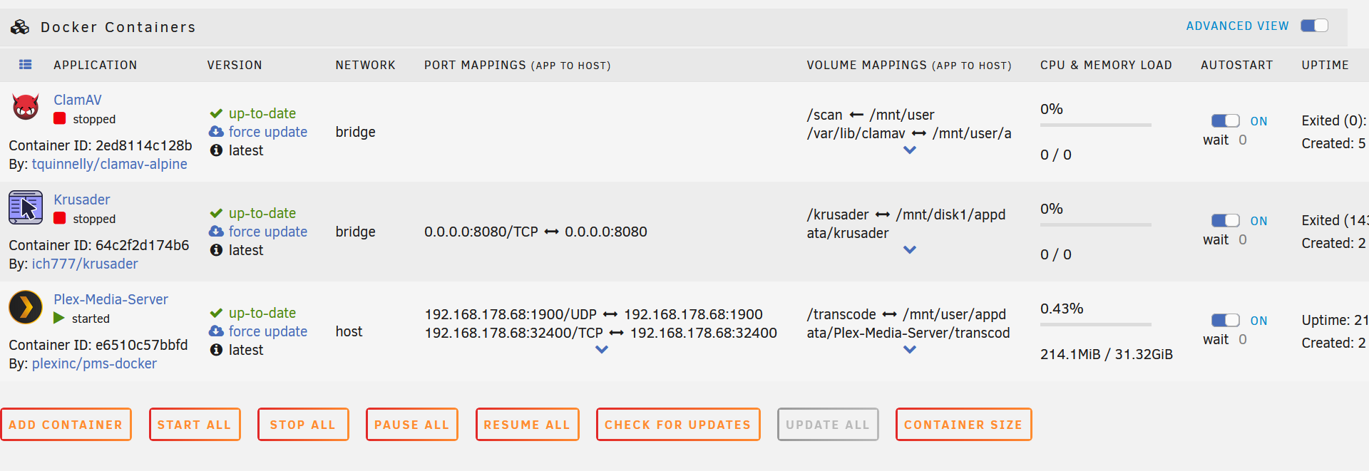

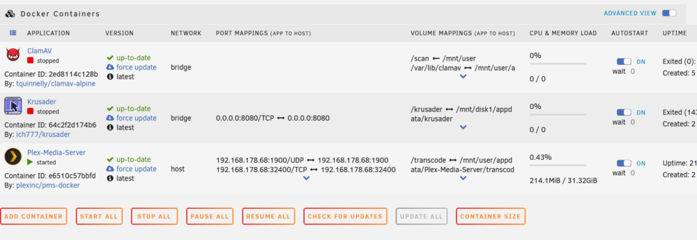

  5. ok, I a very noob. when I stop the Docker apps the container size is shown.

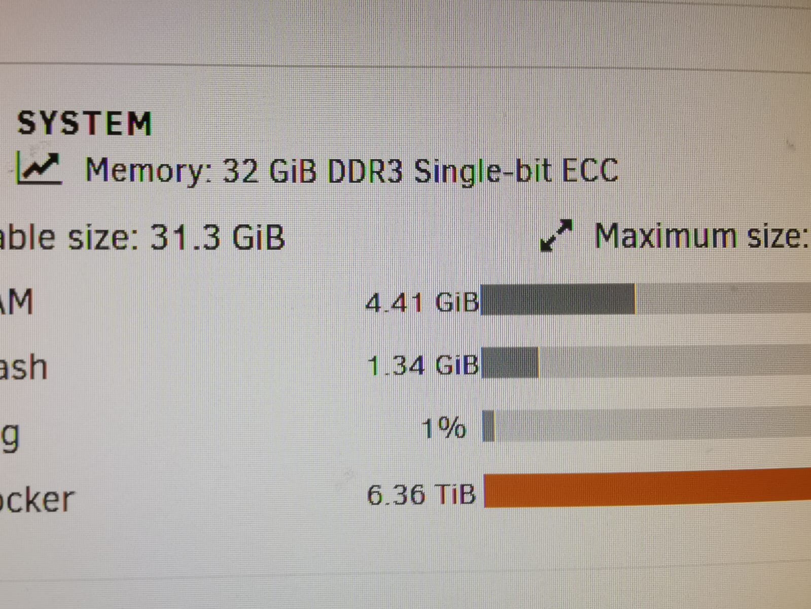

  6. I tried this several times. But at first it did not show anything, even after 5 h. then I restarted the server and got this: Container Size Name Container Writable Log Krusader 1.13 GB 3.12 MB 20.6 kB Plex-Media-Server 349 MB 338 kB 17.1 kB ClamAV 76.3 MB 0 B 15.3 kB Total size 1.56 GB 3.46 MB 52.9 kB but only short after I start the docker service. 2 min later there is olny the waiting sign again . Also: if I do a mouseover in the dashboard it shows this: If I read this right, it would be over 6 TB for Docker?

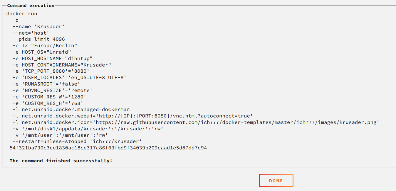

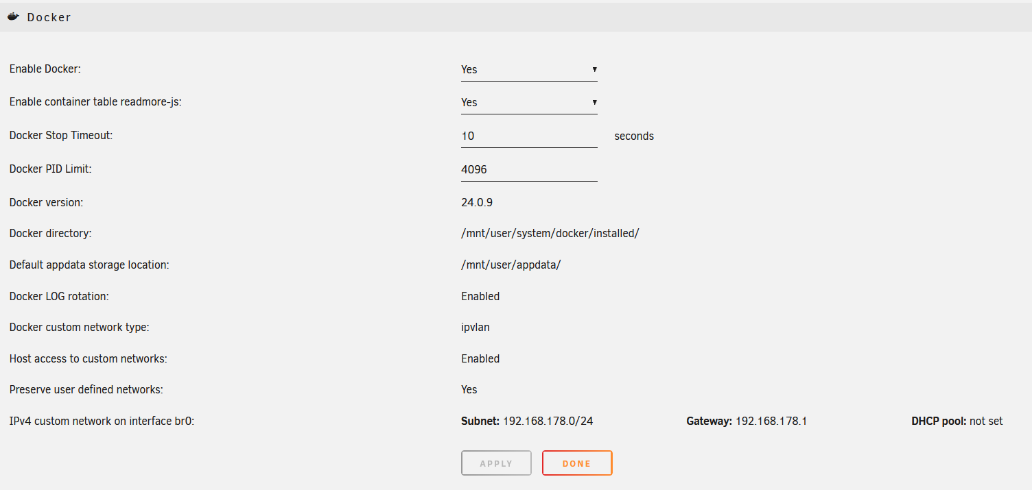

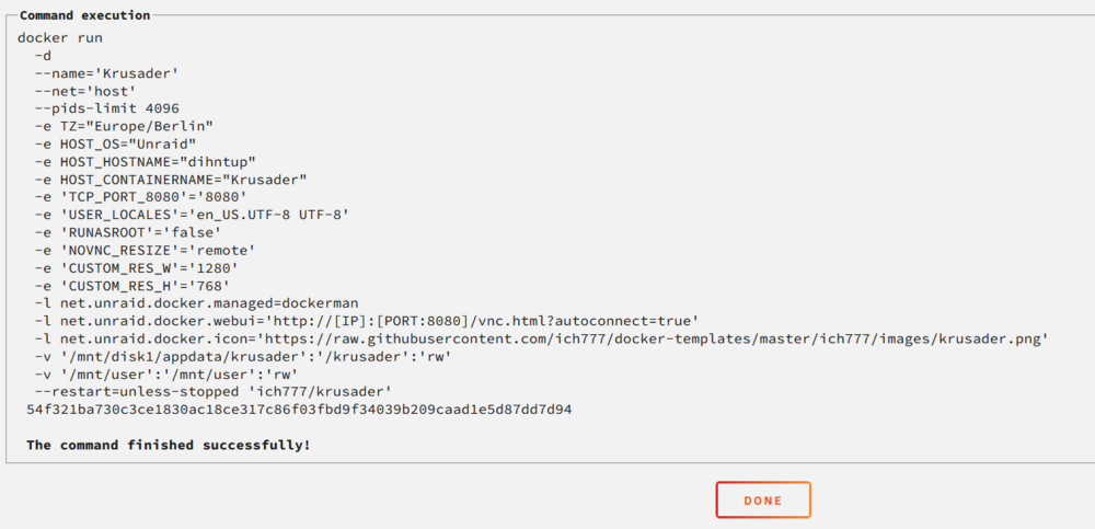

  9. Hello, fix common problems shows me: Docker image file is getting full. I tried several things, even deinstalling most Docker Containers, but the 88 % remained. Here are some screenshots of my settings. Probably I did something wrong at the setup. But, unfortunately, I do not remember. Thanks for any help. Peter
