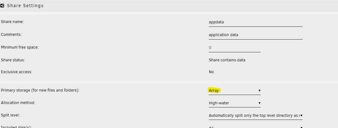

  3. ok, just found that and it was already set to Array. In fact, that is the only option available. Any thoughts on the owner=nobody thing causing me to lose appdata perhaps?

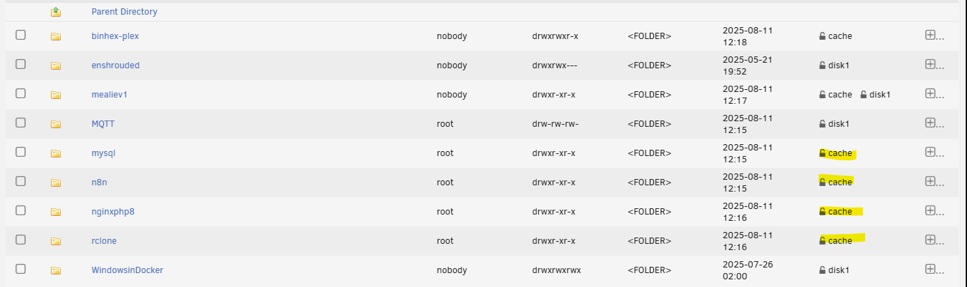

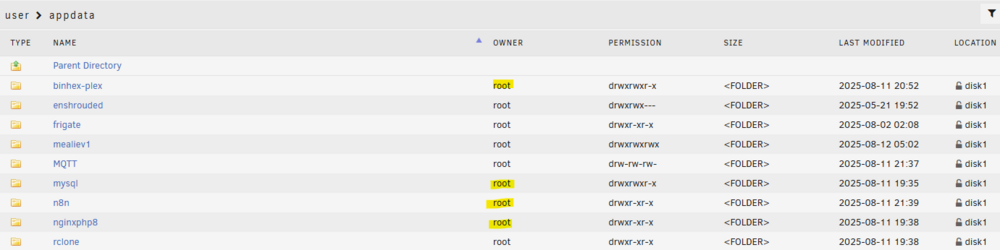

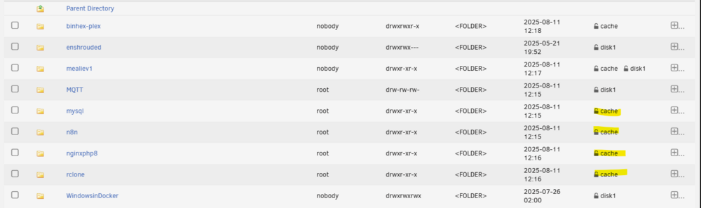

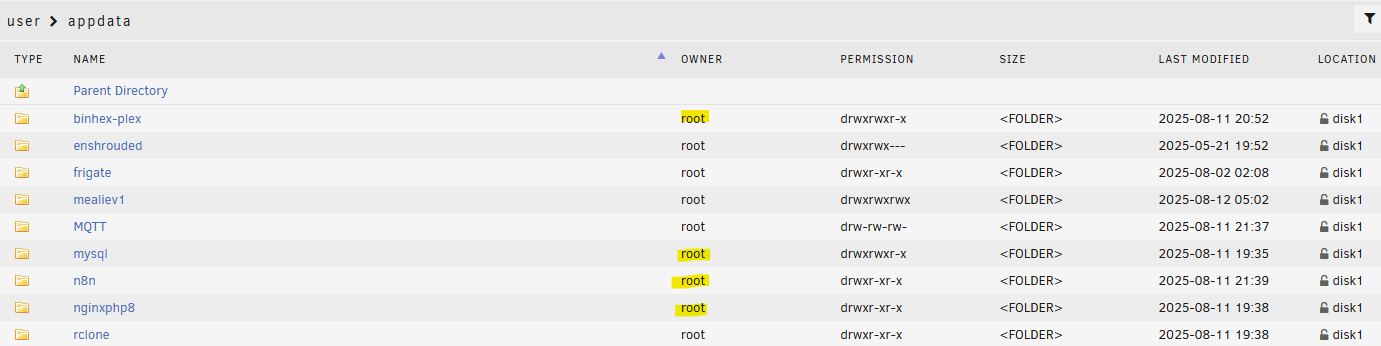

  4. I tried setting the appdata share to array but i believe since i don't actually have any real cache drive that setting doesn't exist. Is this true or did i find bad information? OK, so I was able to do some digging last night. I ended up finding that not only did the N8N Docker get set to /mnt/cache/ by default but also some of the MySQL docker default locations were set there as well. I also found that the remaining volumes on MySQL Docker(from the App Store) were set to /mnt/usr instead of /mnt/user which i thought was odd. I switched everything i could find to /mnt/user. I then ended up restoring most of my Dockers from appdata backup and had to update some permissions to for those dockers to access those volumes. The thing im noticing now is that a chunk of my Dockers are reverting/losing appdata every time i reboot now. The picture below you can see now all my Locations now saw disk1 instead of cache which i think is good. The odd thing was that i noticed the owner of my shares(highlighted in yellow) said "nobody." I just changed them to "root" instead this morning. Do you think that is why my appdata is dropping off after reboot or would it be something else?
  5. ok, so i went through my Dockers and found that N8N defaulted to /mnt/cache so i changed it to /mnt/usr/ instead and did a reboot. It didnt seem to fix anything just yet. Do I have to get rid of that cache folder it created? I also found this interesting in my shares it show several dockers are stored in cache which i know they aren't because the the docker setup is for mnt/usr. Dont know if that helps or not. Is it possible unraid is confused now? Im afraid to ask but if N8N was setup to save in mnt/cache would that mean ive lost everything since the reboot since i dont have an actual cache drive.
