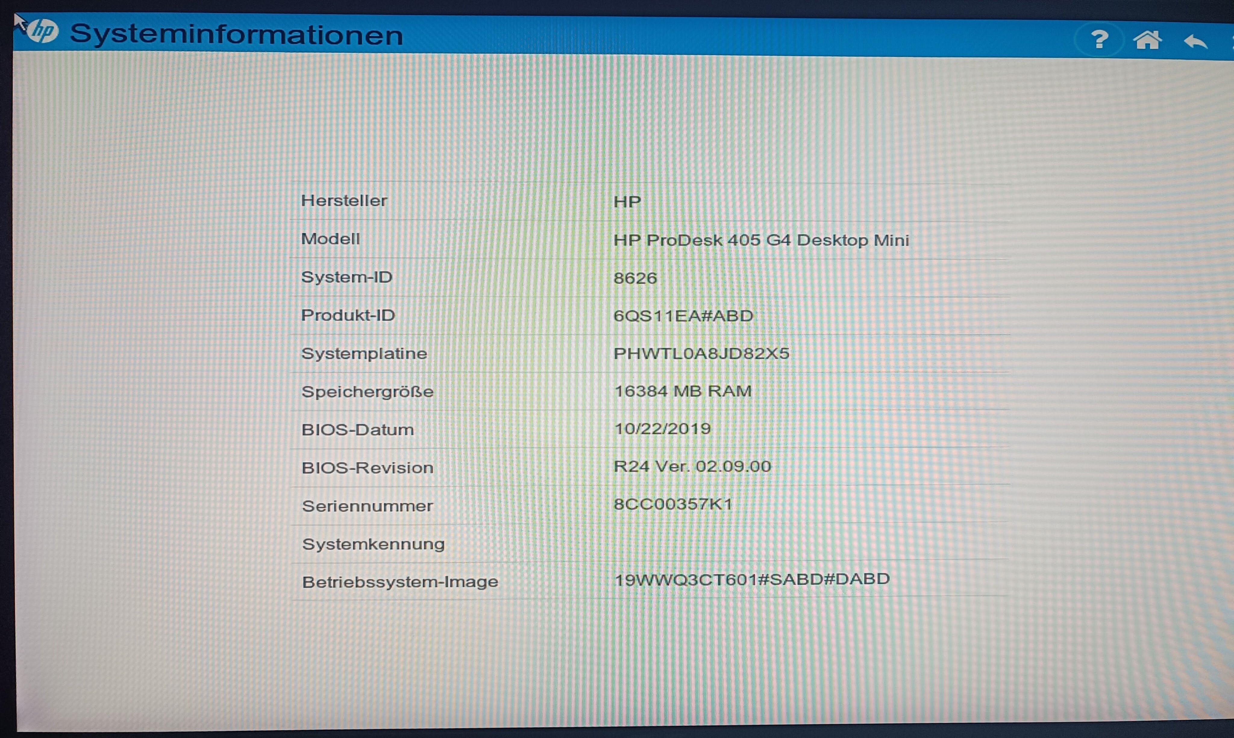

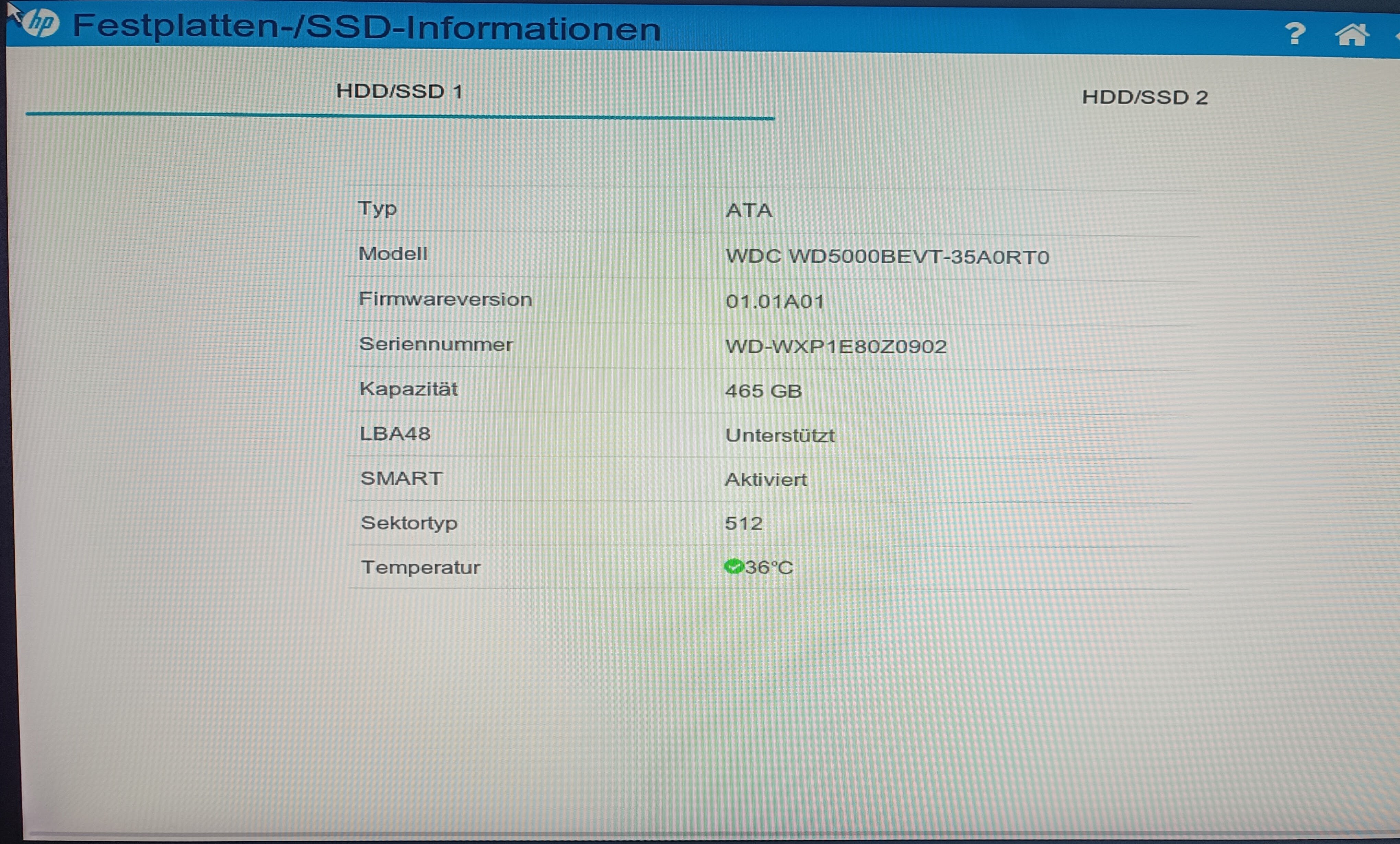

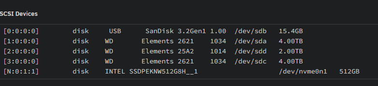

  7. Hello, I recently set up my first Unraid system, and so far, everything has been running smoothly. However, a few days ago, I tried adding an additional HDD to use it as a cache drive and ran into some issues. My System: Unraid License: Basic HP ProDesk 405 G4 Mini AMD Ryzen 5 PRO 2400GE 2x 8GB DDR4 RAM 1x 512GB Intel NVMe SSDPEKNW512G8H 2x WD Elements 2621 4TB (external drives) 1x WD Elements 25A2 2TB (external drive) 1x WD 5000BEVT 500GB (intended as a cache drive) My Problem: The 500GB HDD is not shown under “Main” in Unraid. The disk also doesn’t appear under “Unassigned Devices.” Here’s what I’ve checked/done so far: Connected the HDD internally to the SATA port using this connector. Verified that the SATA0 interface is activated in the BIOS. Confirmed that the disk is recognized by the BIOS. Performed a self-test of the disk in the BIOS (no errors). Verified that the disk is not listed in Unraid under Tools > System Devices > SCSI Devices. Checked the Unraid console with the command fdisk -l — the disk does not appear. Booted the system using another Linux live USB stick: The disk is recognized without errors. Both the fdisk -l and hdparm commands correctly detect the disk. Does anyone have an idea what the problem could be? unraid-diagnostics-20241121-1427.zip

  9. Genau! Ich habe mein System gerade nochmal neu gestartet und die HDD ist nirgends zu sehen. Auch der Command "fdisk -l" findet die Platte nicht. fdisk -l results.txt
