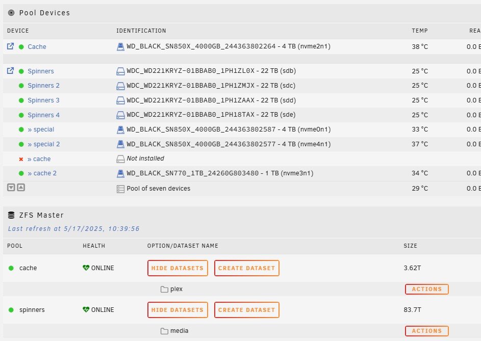

Thank you, that let me start the array but it looks different now (see pic), though Plex seems to be working fine. The cache not installed is the unsupported optane drive as the write cache. The other, now showing as cache 2 is the read cache. Is this right now, even though it looks different than before - not showing "slots"? Sorry for my ignorance on the matter. and thank you again!

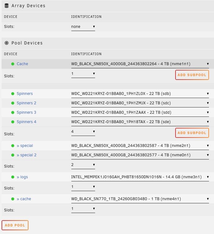

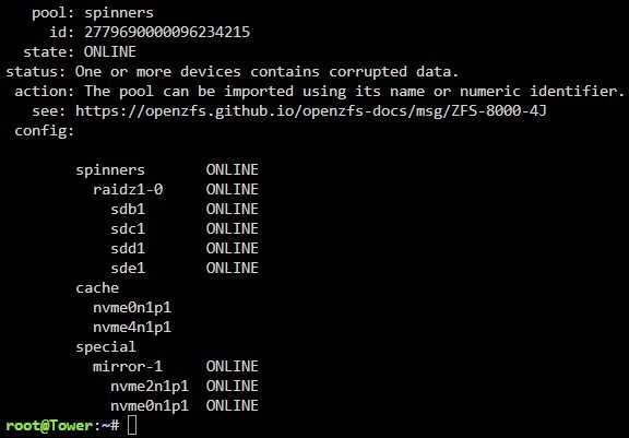

Not unraid literate yet, but server was up and running for some time. However, upon a reboot (nothing changed on my end) I get the error shown below. Also is a pic of my setup, as well as the zpool import command data, and config file attached. The slog says corrupted, but I believe that is just because the slog is an intel optane drive while the motherboard does not support it, and I haven't taken it out, because I'm still a n00b and don't even know how to safely do that. Though it has been working with it in since I built it several months ago. I've read that you can unassign all the drives, start array, stop array, reassign all drive then start again to fix, but that just gives me more errors. My USB stick may be going bad, as now it seems the motherboard only finds it about half the times on a reboot. tower-diagnostics-20250516-1316.zip
