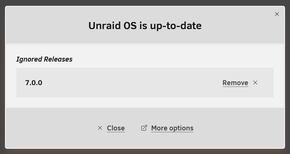

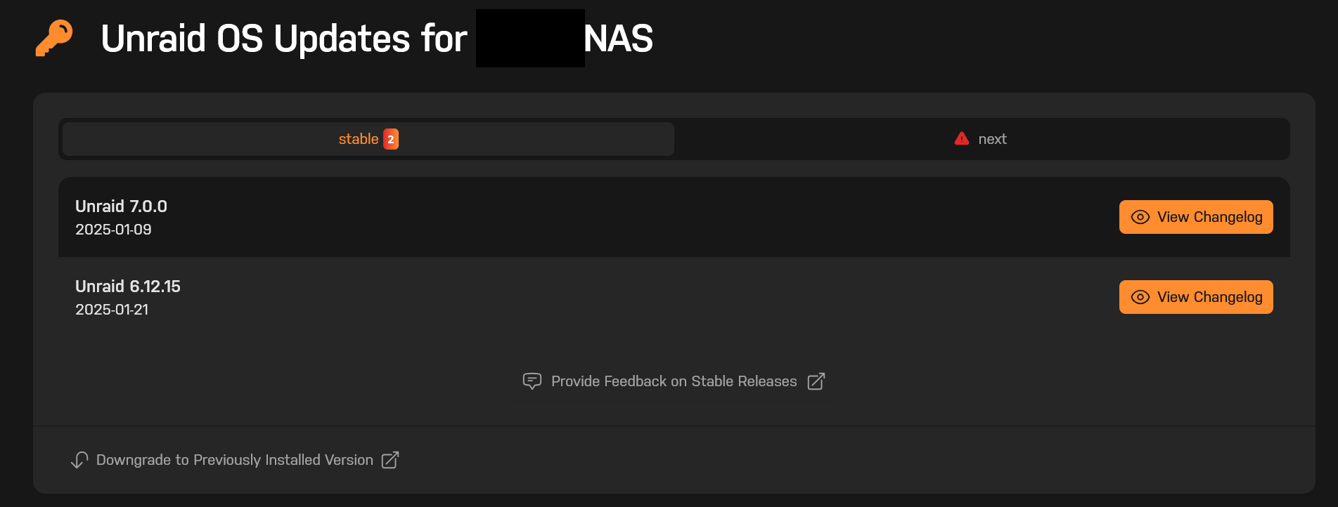

  6. Hi - I'm not sure how to update to 6.12.15. When I do "check for update" it only shows me 7.0.0, and then redirects me to the Unraid webpage which lists 6.12.15... but I can't find how to actually select that as an upgrade option. The dark screenshot is from https://account.unraid.net/server/os-update after clicking "more options" from the Unraid admin UI
