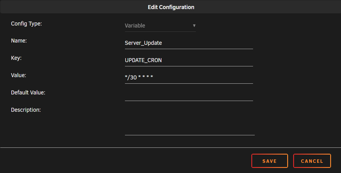

  1. Hello, I am currently getting familiar with Unraid as a beginner because I am looking for a system for my NUC that is intended to act as a game server. However, I am still having some difficulty with Docker, especially when it comes to mounting folders. Previously, I ran a game server on my Synology NAS, where I used a Compose file to declare all the variables as follows: services: enshrouded: image: mornedhels/enshrouded-server:latest container_name: enshrouded hostname: enshrouded restart: unless-stopped stop_grace_period: 90s ports: - "15636:15636/udp" - "15637:15637/udp" volumes: - /volume1/docker/enshrouded:/opt/enshrouded - /volume1/docker/enshrouded/savegame:/opt/enshrouded/server/backups - ./game:/opt/enshrouded environment: - SERVER_NAME=Your Name - SERVER_PASSWORD=secret - UPDATE_CRON=*/30 * * * * - BACKUP_CRON=*/30 * * * * - BACKUP_MAX_COUNT=6 - BACKUP_DIR="/opt/enshrouded/server/backups" - SERVER_SLOT_COUNT=8 - PUID=4711 - PGID=4711 The key point is that the game in Docker should transfer the game server files to a folder visible to me and continuously back up the game to a savegame folder. I managed to get this working with some effort back then because I hadn’t fully grasped the concepts yet. My problem now is: How can I find out which folder in Unraid corresponds to the container folder where I want to access the relevant files? And how do I correctly mount the target path on the host? I entered the variables individually as shown in the example (see photo). In the Settings → Docker, the following paths are specified (see photo). I would greatly appreciate any help. Regards mike
