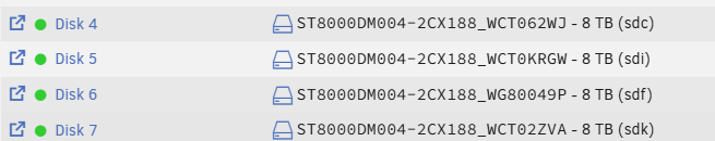

  5. OK, so attempts to start the array in maintenance mode are failing: TL;DR: I'm unable to start the array in Maintenance Mode I have checked the Maintenance Mode box and clicked Start 4x. I believe this is reflected at the bottom this shot from the syslog: Each time I select Start the UNRAID working symbol (I just learned that's apparently called a "throbber"?) pops up for 2 seconds and the Main screen returns to how it was showing the array is not started. Unfortunately Disk 5 seems to agree the array isn't started: System logs are attached if needed calculon-diagnostics-20251219-1222.zip

  7. Ok, Something about writing everything out must have spurred some thought because I decided to compare the cache and array contents. What I discovered is that it seems everything currently residing on the cache drive is only new since the parity rebuild. The difference across between the cache drive download share and what is contained in the download share on the array disks represent are a perfect match to what I was seeing in Krusader during reboots (2 separate shares). More concerning is that I've now noticed that while the "main" page in the UNRAID GUI shows everything is good with Disk 5, when I click the "browse" button at the far left to view the contents, it loads a blank page that simply says "Invalid path" instead of showing the disk contents (177GB worth). I'm thinking my parity rebuild did fail. Disk 5 is the original disk I manually moved the data off via Krusader before rebuilding on a new disk. I'm not sure why I believe I was able to make space on the cache drive using Mover now though, as it seems something is preventing anything from actually moving from cache to array. Perhaps items that I had been deleting were now actually represented as free space as a result of mover? Maybe it was in my head. I'm sure that's irreverent now. I'm guessing despite my array being "Healthy" that it's actually not and I will need to rebuild with a new configuration, and whatever is on Disk 5 is lost? For now I am going to run an Extended SMART test on Disk 5 and wait your direction. A quick test came back without error.
