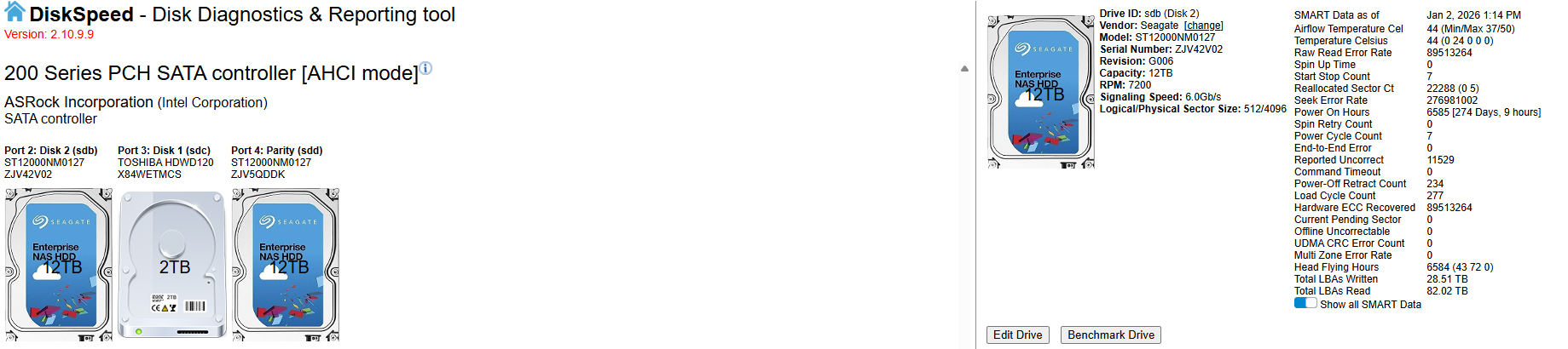

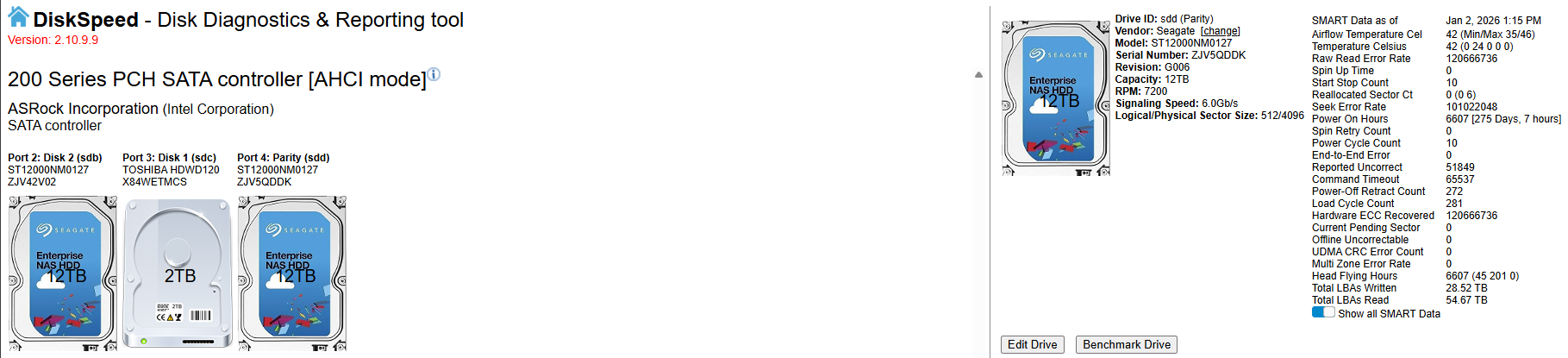

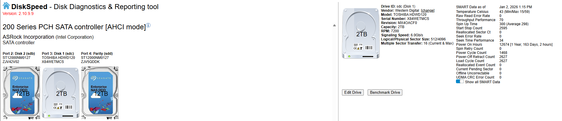

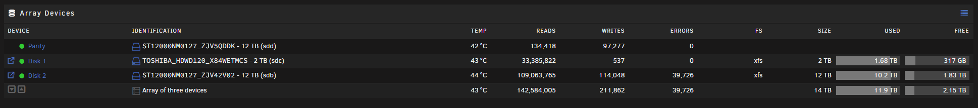

  4. ok many thanks, is there anything i can try to maybe get lucky and get it to run right? or is it a dead end?
