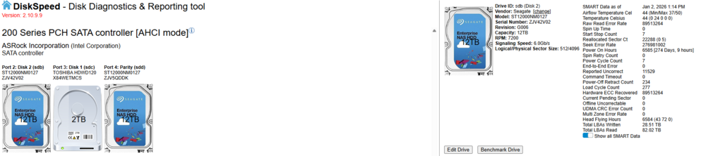

a couple of weeks ago the power to my house got cut off, i forgot to stop array and shutting down my server normally, after i booted up the server again there seems to be problems with the disks in my arraym i have tried running a parity check but i goes up to beyond 7k days to finish, if i want to simply move a file from one disk to another, the speed goes from around 50 mb/s to straight up 0 mb/s and stops, same thing happent with unbalanced bc im trying to empty my old 2 tb disk so i cam remove it from my array, i have a 12 tb parity disk and a 12 tb disk in my array with the 2 tb, and i want to get the small one out of there, and also plex has become almost unusable from time to time, any suggestions?

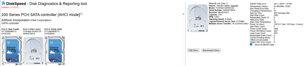

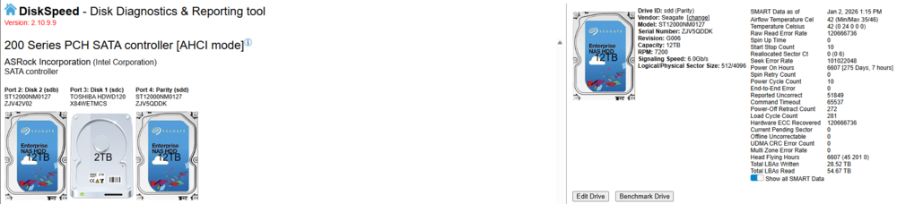

i have tried running diskspeed and it dont give any errors as what i can see, but im fairly green on unraid so keep that in mind :-)
I have tried disconnecting and reconnecting all the power and sata cables to be sure but the server has been running fine up to a year before this

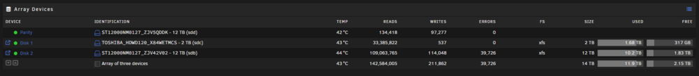

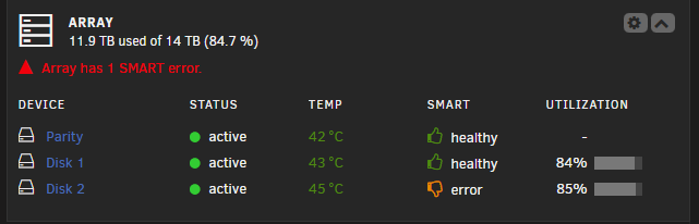

i also have en error on my disk2 in my array, that is the 12 tb disk.. i dont hope its dead :-(
from diskspeed:

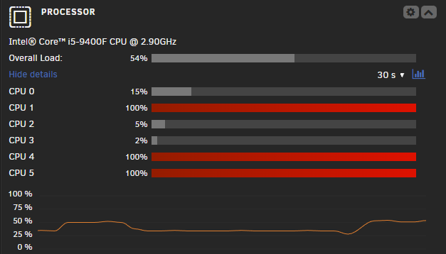

and also it shows my cpu to be doing a lot without doing anything, see picture, but im not sure if that is also bc of one of the drives?

Disk2 appears to be failing, many reallocated sectors with a FAILING NOW SMART attribute. Recommend replacing that disk.
