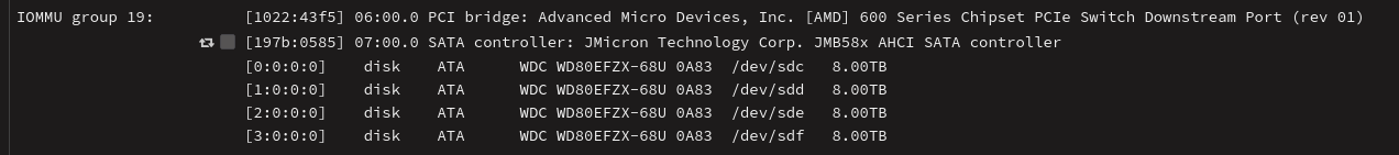

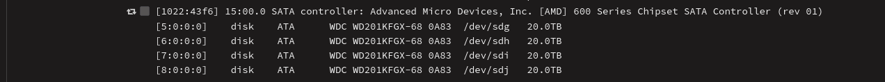

  7. That is good to know. Thank you. However on my side this is reproducible. Working perfectly fine on 7.2.3 and prior releases, no errors, no SMART issues. As soon as I upgrade the issue is there and Unraid refuses to see the drives attached to this controller. No config changes, no BIOS changes! Just upgrade and reboot. After a downgrade all is fine again. Something has changed that much is for sure. I can also boot form a Live-Ubuntu 26.04 USB Stick and I can see all the drives just fine. I don't see any errors there. Therefore I have a hard time to believe that it's anything HW related. All points to Unraid. I can also not find anything related to this in my diagnostics (I'm a Linux noob though) blackbox-diagnostics-20260606-0044.zip
