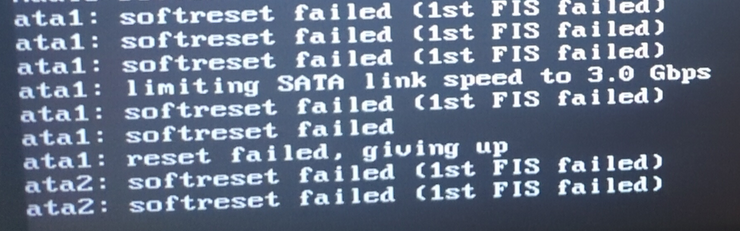

I just tried to upgrade from 7.2.3 to 7.3.1 and lost half my drives.
Boot took forever and I saw this error message:
I then downgraded to 7.2.3 and tried to upgrade to 7.2.7. Same issue!
Has HW support for one of my SATA Controllers been removed?

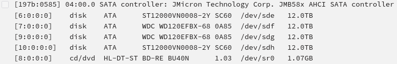

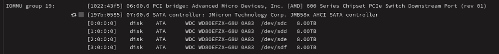

I have the following:
I did not change any HW and this Server never had issues since I built it over 1.5 years ago. Back then it was running on Unraid 6.x.
