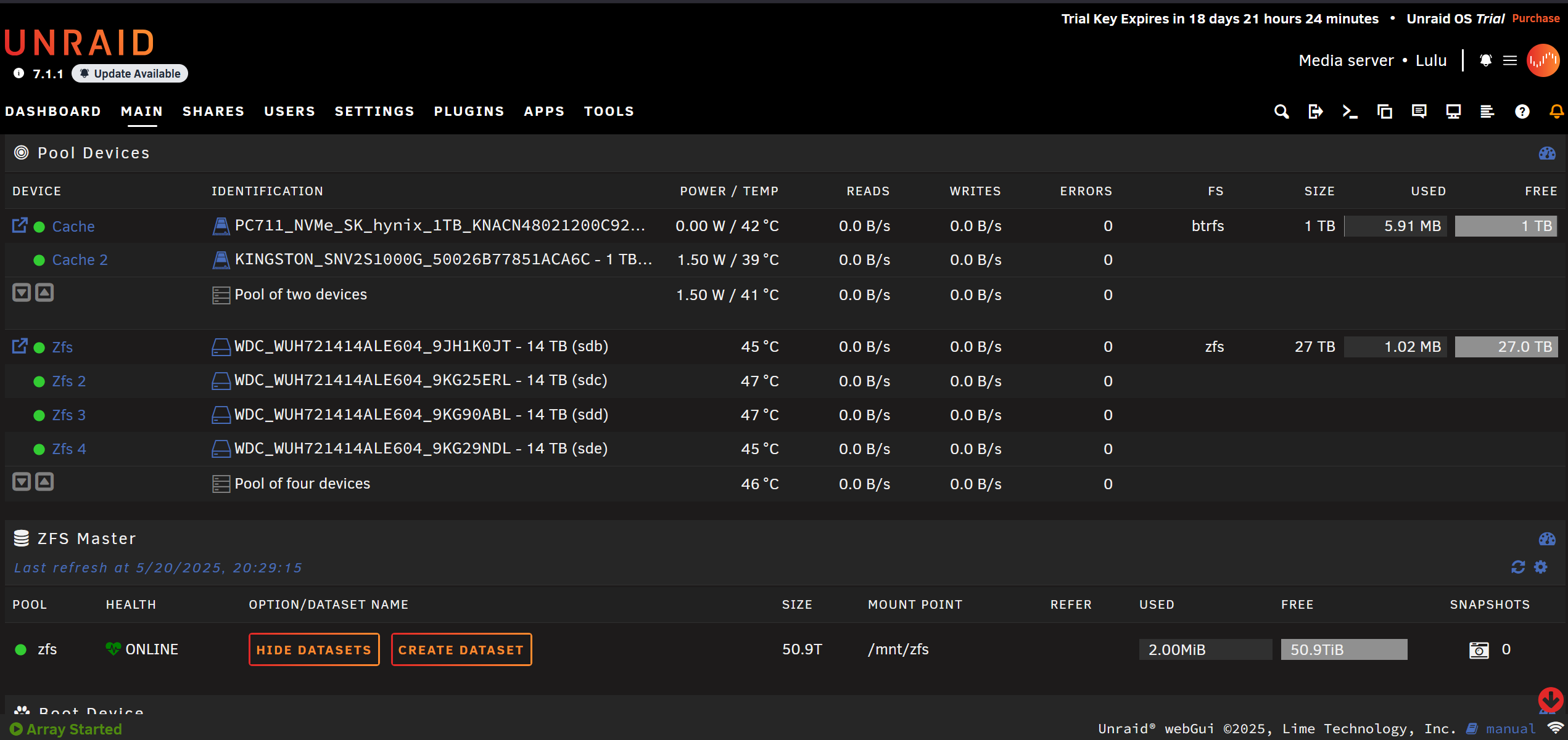

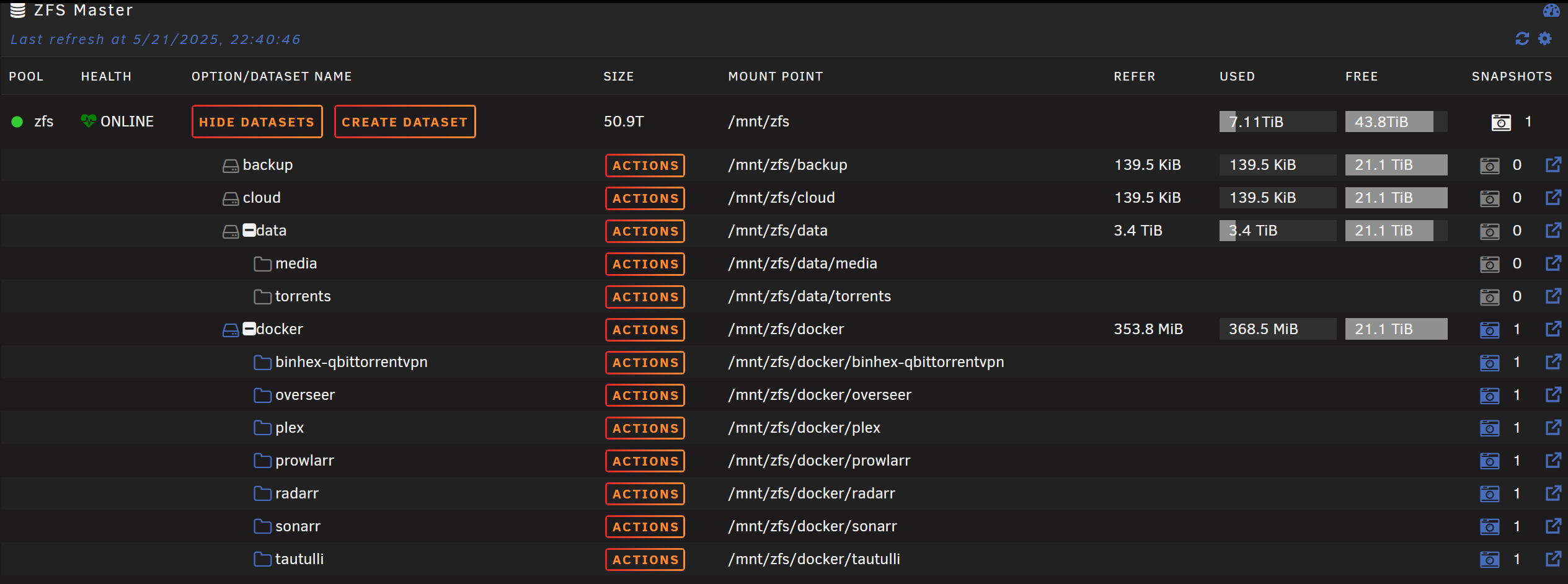

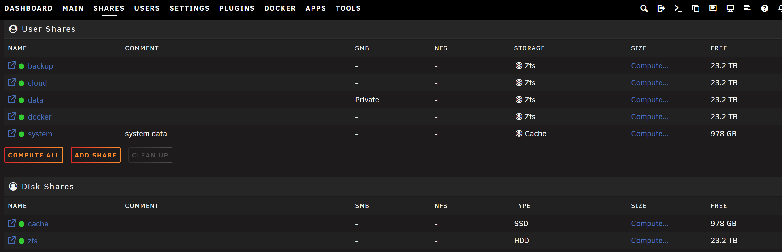

  5. Thank you! I have thoroughly read through both of your replies and made a lot of the recommended changes. I would say the only changes i have not made (as they are currently not applicable) is setting up nfs/ssh/and sftp fail2ban. I have no current need for nfs connections, don't plan on sshing to my unraid machine, and wont be sftping. I don't think what you said is bad advice and i will definitely keep them in mind if the time comes for me to need these services. This is my new current main screen with zfs setup and using data sets. Its not 1:1 how you explained i should set it up as i have my data/config files in different folders but i do have the cloud and backup datasets and think those will be useful. And this is my shares page: The only question i so far have i guess is why is zfs master showing 50.9tb but the zfs pool itself shows 23.2? is that intended or?

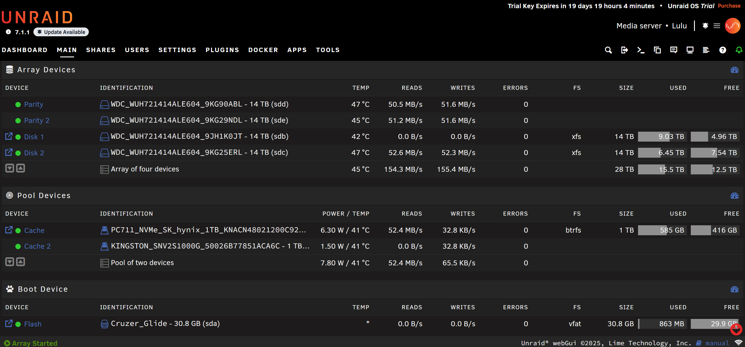

  8. Heya, thanks, i appreciate you taking time to help me with this. First off, yes i went the array (2 disks, 2 parity) route with cache pool (two 1tb in raid) as seen in the pictures i have attached. Second, I created data share to temporarily store data then have mover move it from cache to array. I then realized i need my data to be seen by my docker containers and i cannot move my data onto my "data" share as it will fill up the 1tb cache and reduce its life span. So, i created the "tmp_data" share that is directly on the array, mapped it to a letter on my gaming pc that has the 14tb drive in it with all my current data that i want on my unraid system, used robocopy to move it all from gaming pc drive to unraid array. Now i have the data on "tmp_data" share and not the "data" share where my docker configs are pointed to. Third, if i have to start all over its no big deal, i have backups of all my docker containers, i still have my data on my 14tb in my gaming pc, nothing is dire. I'm still trying to learn unraid and figure out a "best setup" for my use case. Let me know what else you need to help. I have read the documents and thread you have attached in your reply by the way, thank you.
  9. Setup: Hello all, I started my unraid build a couple of weeks ago and built my pc, put unraid on the usb and started my journey. I tried doing a bunch of research and "best practice" seemed to be have an array but use a cache drive to move data onto the array (when? That is preference) which i did just that. Put in four 14tb 3.5 hdd's (2 disks for parity), two 1tb nvme's in raid for a cache drive. I setup an appdata folder to hold my docker configs and have /data on cache to move to array after a day. In theory this would download data to cache then after a day it would move to array and not break links. Great it should be all setup. Problem: I needed to move all my data that is stored on a 14tb drive in my gaming pc for temporary storage until my unraid was setup. Problem is, i couldnt move onto the cache share as it would fill up the 1tb and im not sure if i can overflow into the array with that? Plus its almost 14tb so that would be a lot of wasted writing to an nvme drive. So in my quick thinking i just made a share directly on the array itself and robocopied from the 14tb to my array that i mapped onto my gaming pc. After about 2 days its all on there. My current problem is though, i dont know how to fix my setup to have my cache drive know of the existing data and continue working with my docker containers to grab downloads and after a day move it onto the array. Any help would be appreciated. I didnt get to have a thorough look through everything and how to set it up as i just got home last night and now im at work but i thought id throw the question out there in case anyone would have a quick and obvious solution im missing (im new and still learning).
